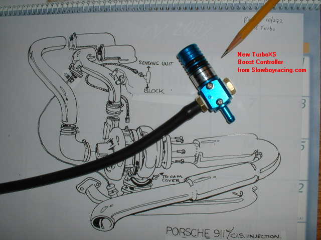

O-Sensors and Boost control
For those with 1980-83 SC w O-sensors, you will want to temporarily disable the O-sensor signal to the OXS Control Unit when you are "on the boost". With the following setup the O-sensor remains in normal operation at all times except when the boost exceeds 1.5lbs when it's signal is then grounded out until the boost drops back below 1.5#.
This next image is of a mechanical boost controller. It will be installed in line with the Wastegate actuator supply pressure hose. I plan to set it initially about 1-2 lbs above the wastegate .
Pieces all over now so completed setup images will have to wait a bit.

Old 03-03-2003, 03:25 PM

excellent, enjoying reading this - keep posting!
why cut out the o sensor above 1.5lb? would this apply to 3.2's equipped with the sensor?

The idea is to run "closed loop" as designed when not on the boost and when you are on the boost run "open loop".
With supplemental fuel being introduced at 3.0# boost, the mixture is richened up - to add power and avoid detonation. We don't want the closed loop circuit (frequency valve) trying to take away that fuel, so we run open loop by temporarily disabling the O-sensor signal just before the boost comes on or a 1.5-2.0#.
In regards to a 3.2 if you mean a 3.0 modified with 98MM Mahles then it would be the same.
This setup is for K-Jetronic.
If there is a MAF, Load or Throttle Position sensor(s) in the car and the ECU is already compensating AF mixture for Load and WOT then this may not be necessary.
In this K- Jet 1978SC Turbo I intentionally have kept everything mechanical in tune with the period and have no plans to add electronics or more sophisticated fuel/ignition management solutions.
Other toys are for EFI and current technology. That is just a preference of mine for this car.
