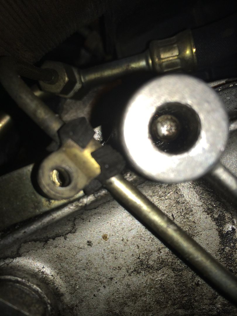

Hi folks,
Long time since I posted here
I've had a weep of oil from a broken stud at the top of my left cam-chain cover, forever, and it now remains the only oil leak there is.
I don't really want to do an engine drop to fix it, so was wondering what methods would work to remove & replace the stud with the engne in-situ. I guess the limited access is the main problem, but I did read very recently here on pelican about installing the carrera chain tensioners without removing engine & that got me thinking it may be possible.
Any suggestions, or ideally has anyone actually done this ?
Very old pic, but shows the broken stud
Thanks,
Declan
1975 911 2.7 Coupe

Posts: 2,948
cant see much in that photo
but you should be able to get that out as it passes right through and should be easy
is there any of it exposed ?
take rear tinwork off and timing cover and see if you have anything youcan grab with vice grips. a little heat and unscrew it.

Well I had another look this evening and I actually have 2 broken studs at the top of the chain cover.
On the plus side, it seems there will be something to get hold of when I remove the cover
I assume I should drop the oil before removing the chain cover ?
Thanks again for the help
Declan

You dont have broken stud.The chain case are old style and somebody forgot to take off the two short stud when he put the carrera covert these require longer stud.

So Warren was right, all those years ago !
Early S man, aka Warren, advised me the same may moons ago and I had totally forgotten until I was looking back through the old threads I had subscribed to on here !

In my wisdom I bought 2 M8 studs as per the Porsche diagrams, but then realised the old ones are M6. Searching this forum yielded another wise post from Early_S_Man suggesting just to use longer M6 Studs instead, so thats what I did.
Now if I hadn't torn the new gasket, it would all be back together again.

Best to double nut the studs. Using vise grips screws up the thread and makes it difficult if need heat and to double nut anymore.
Yes, double-nut is how I got the old studs out. They were very tight to get moving, but once they started moving they came out easily enough.
