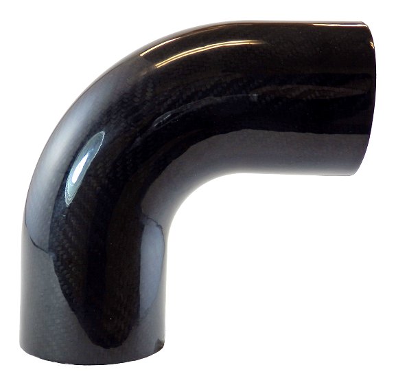

As I test fit the engine in the latest Gretchen I began measuring and planning for the air filter assembly. This car has an aluminum Carrera intake, and from a rough placement in the engine compartment I have about 6" clearance from the throttlebody to the firewall.
I had used a giant oval-cone K&N filter with one of their 90 degree elbows on this motor in another car in the past and it would fit this car too but 1. it looks ghetto (my diagonal cut to fit the throttle body wasnt clean, 2. it is a heavy mother and 3. it indiscriminately takes air in from throughout the engine bay.
So in the spirit of competely skunkworking this thing, I came up with a plan...my priorities were to address those 3 things above. I have done enough fiberglass work to know I dont have the skills to turn out a piece that would be acceptable to me. So I concocted an approach to use some pre-fabbed carbonfiber pieces and plates to make something.
I drew up plans for and order some pieces. Sorry, I am travelling now and dont have the drawings with me but it is basically a 90 degree 3.5" elbow from the throttlebody to an airbox located over the 4-5-6 cylinder bank mounted on the stock intake bolts. The elbow enters the airbox on the driver's side. The box will measure 5.5" tall x 12" wide by 12" deep. The box has 5 closed sides and its open end facing the rear of the car. A rectangular filter will fit into the open end supported by a 1" CF flange around the perimeter made from the 90* CF angle. Then a lid also with a CF angle flange sandwiches the filter in place, and forms a mouth aimed at a 45* angle right into the decklid grill. I know, a picture is much more helpful...
Here is my list of materials:
90* elbow from carrera throttlebody to airbox:
CF Elbow
CF plate forming the box and filter mouth:
solid CF prepreg plate 1/16"
CF 90* angle reinforcement for corners and filter flanges:
CF angles for corners and flanges
Filter:
Rectangular K&N filter
I havent worked with CF before. I found this video helpful in building confidence...lets see if that is misguided...
https://www.youtube.com/watch?v=EWzN6GZeEzs&t=35s
Easy Composites Video
I have a bunch of Hysol products on hand for the actual bonding. Initial research incdicated the e120 was the go?
I am interested in input from others about the approach, methods, tips and tricks...

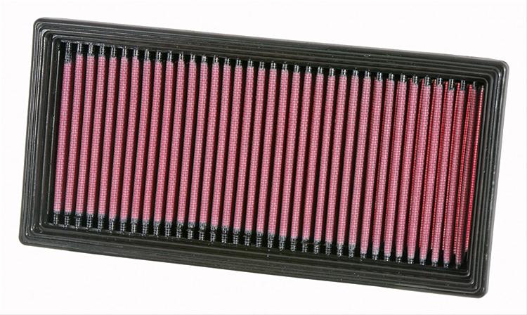

What size is that filter? K&N site calculates needing 65 sq in in filter area, yours looks smaller than that? The one I selected above is also slightly smaller, I may return for a Miata filter which is 6.5x12. Same sq in as used in a new AMG C63 so I cant imagine it would choke a 250hp 3.0.

Kudos for the CF effect/build. However, inlet air temps are pretty much ambient in the engine compartment at speed. Use a paper filter. It's cheaper..... and better.
K&N makes more promises than president campaign speech

Yeah, but I see you used one too! What size is it?
The filter will be partially visible with the trunk open, at least the K&N looks OK and does a decent enough job filtering. The paper ones look like crap as they yellow/grey almost immediately.

After seeing what passes through a K&N filter I would NEVER use one on my car... Stock paper element works just fine.

I've been using them for 30 years on every machine I own (bikes, cars, diesel truck, race and public roads) and have never had a problem with dirt getting past them.
