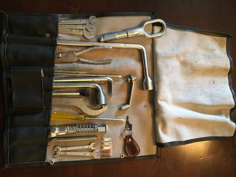

BlueWing's Avatar
Location: No longer N.Y. yeaaaaaa
Posts: 1,013
Correction - I do have a yellow handled screw driver, I might have mistaken it for an old MB tool kit I have.
Here are a couple of pictures of mine. The Pundz fuse pack is from the MB kit.
It would be good to know what is correct and what is not.
Terry
79 SC Minerva Blue ROW
Non Sunroof Crank Window Coupe
3.0 SSIs, Backdated Heat
COA: Passenger Side Mirror, Manual Antenna & Dunlop Tires

Blue wing;
Would you do us a favor and take a picture of the toos out of the pouch? I'm really curious as to what that spring thing barely sticking out is.

That would be either the tow hook (longer piece) or the spark plug socket (the shorter piece). Here are the tools out of the pouch. I can not vouch for the absolute correctness as I have only had the SC for 13 of it's 38 years. I also have a tag that was clipped on the toe hook and a reflective triangle on a stand from SWF.
The pictures make the tools look worse than they really are.

Thanks Terry. That was quick! I guess my kids still keep me busier on sundays than most people. It takes hours between logins! BTW, how does that spark plug tool work? What's the spring for? Is it to allow it to swivel?

Got the grand daughter for the weekend and this gives me a break. The spring I believe helps allowing it to swivel and keep it somewhat aligned in the recess to remove the spark plugs.
I don't carry the tool kit in the car, I have an old Mercedes kit that I do carry. I have a spare toe hook but need to get an additional alternator pulley wrench to add to it.
Sometime ago I got involved in a tool pouch color tag thread but didn't have a solid determination of pouch color and tag color corolation. Maybe someone (sharper than me) can make a spread sheet starting with pouch color, material pattern, color tag, tool stampings, screw drivers etc............
Sometimes hard to determines due to not too many original owners out there but still a good guide of what should be correct. This would help for current owners having a correct kit and sellers/buyers properly identifying what is for sale or purchasing.

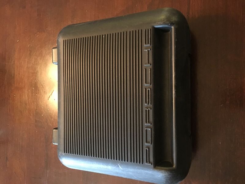

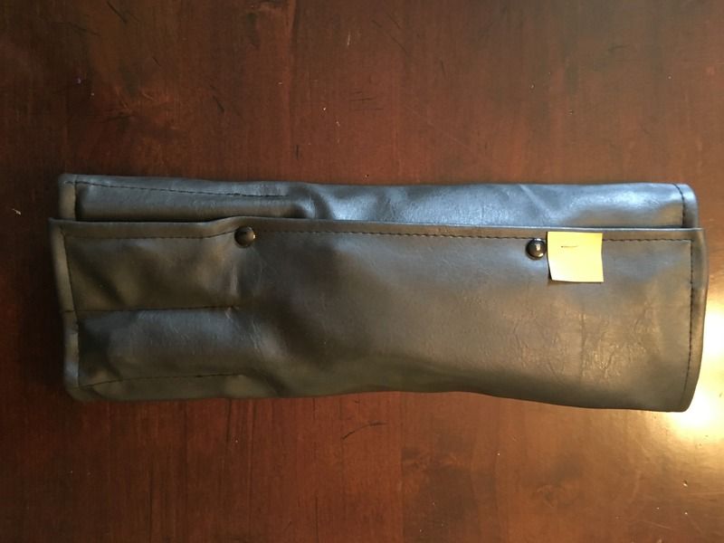

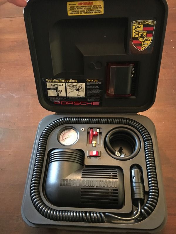

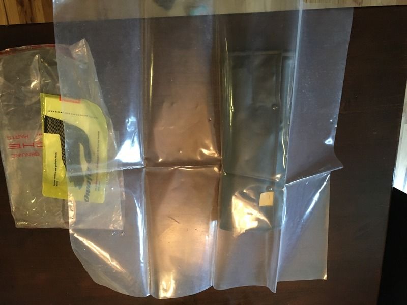

Since I've opened this can of worms here is what I have for a 1984 Carrera that I believe to be 100% complete. I think this could be a good starting point for 84-89 with the exception of bag color and the tag stapled to the bag??
Targa and Cabriolet would also have two keys to release the top (I think)
The kit includes the following:
Black Vinyl Tool Kit Bag
• Yellow tag stapled to outside
• Black with greyish liner
• 9 pockets and a belt holder
Tools:
• Screw Driver with three interchangeable blades
o Yellow handle
o Long Medium to Large Size Phillips
o Medium Length Medium to Large Size Flathead
o Short Small Size Phillips
• Combination pliers
o Hapwe and Germany stamps on ether handle with a pattern of some type on outside of handles
• Wheel Lug Wrench
o 19mm
• Wrenches
• Marked Selected Special Steel West Germany
o 8/9
o 10/11
o 12/13
o 14/15
o 17/19
• Alternator pulley wrench
o 24mm
• Alternator Pulley Holder Wrench
• Spark plug socket
o Klein 21 chrome
• Allen Wrench
o Klein10 mm (for Spark Plug Wrench)
• Allen Wrench
o Klein
• Hollow Metal Tube
• Battery Hexagonal Rubber Tip Allen Wrench Key
o 6mm
o CHR-VAN W Germany
• Sunroof tool
• Tow hook
o Threaded
• Fuse PUDENZ 5-Piece Pack includes:
o 1- 25 amp (blue) Fuse
o 1 -16 amp (red) Fuse
o 3 -8 amp (white) Fuses
• Jack
o Bilstein black with a green dot
• Fan belt
o Porsche AV 10/9.5 x 710 Alternator V-Belt
• Gloves – Owafix
• Plastic sheet
• Wheel lock key
• Air Compressor
o Black plastic case makes PORSCHE across the front
o Operating instructions
o Flashlight
o Pressure gauge
o Presta/Schrader valve adaptor, air needle, red plastic tip??
[URL=http://s3.photobucket.com/user/cdillonc/media/930/9A877413-C254-4CC9-86DC-222CA03D7FFD_zpsmmuaki4g.jpg.html][/
