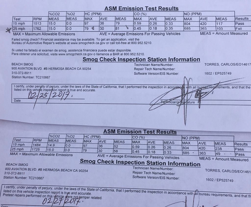

I just had my 84 Carrera fail and then pass the smog test. My motor is bone stock with 168,000 miles and the addition of a SW chip and a sport muffler. Right off the street with a couple of gallons of lousy gas I failed the HC test by two points. With ten gallons of Chevron and a bottle of octane boost,some fuel injector cleaner and a Italian tuneup I passed easily. Here are the numbers.

So was the 1st test that failed with only local driving from home to the test station?
I found several yrs ago when my '84 was failing, a good and hot engine after the Italian tune up helped the HC considerably but not enough to pass. I had to get a new cat to finally pass the HC.
Glad it worked out for you! CA smog every 2 yrs is a major pia....

Both tests were after forty-five minutes of spirited driving to warm the car up. I believe the difference was the gas quality.

Thank you for posting this! I have a 1984 Carrera that failed the smog test twice. I'm going to
put a new O2 sensor in and have my fingers crossed

My 84 passes sans cat with flying colors. One time I forgot to re-connect the brown jumper wire & it failed... Reconnect for the test! Then disconnect for 2 years of joyful driving!

take it down to 3-4 gallons, put in a gallon of methanol,
and you'll pass every time. Right after test, fill tank to dilute.
