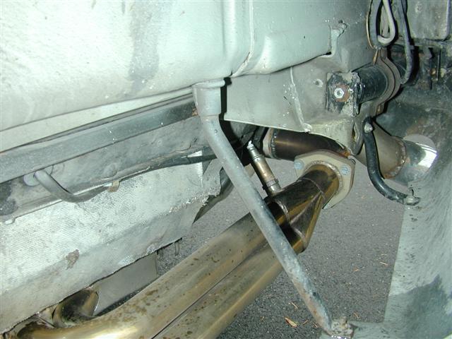

Here you can see the bumper/nerf bar mount and the end of the nerf bar itself, it's just angle iron
http://forums.pelicanparts.com/uploads/BB_o2Small.JPG
This is where large wheel and tire packages will have the most interference
