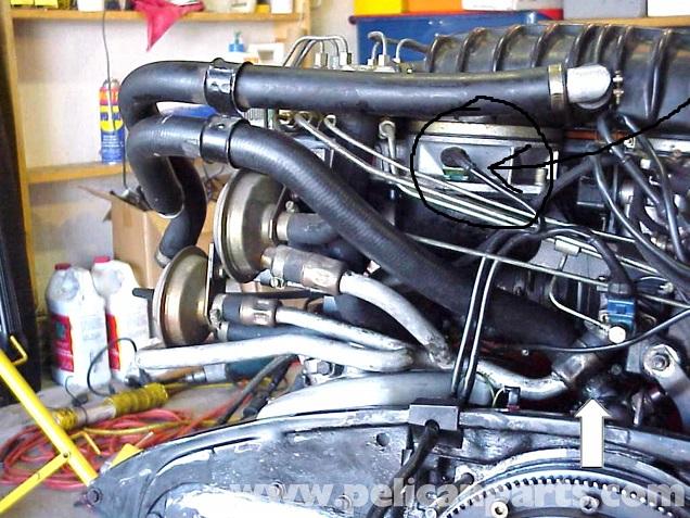

Help needed with troubleshooting saftey switch
When I turn my key to the On position my fuel pump begins to run. From what I understand the pump should not run until the starter has been engaged or if the air plate is lifted up. I am trying to figure out why mine is not reacting as expected. Where do I begin troubleshooting? Could the switch on the air plate be bad or out of adjustment? If so, how do you get to it and how do you test it?
I’m looking for step by step things to check for.
Thanks
Rick

hi..have you had your 911 in some kind of service place?
if this happens it could be that you safety plug on your sensor plate is disconnected .this a safety device in case you turn the car on roof .It will stop the fuel pump.So when the plug is off the pump will run with the key on...
here different model of 911 but location same--check it..to start with..
ivan
The green plug is plugged into it. It appears to be two wires in the plug, where do they go to?

Check if the AFS electrical plug is connected at the backside of the AFM (air flow meter). You could find out if the electrical plug is connected by using your fingers to feel it or use a small mirror. If it is connected then you could do the following test.
a). Remove the FP relay and locate terminal #85 on the relay socket. You could test terminal #85 either using continuity test between #85 and the sensor plate. Or use a 12-volt TL (test light). I find the TL more convenient and practical for this kind of test.
Terminal #85 is a ground connection for the FP relay that goes to the driver-side terminal or pin of the AF switch. The passenger side terminal of the AFS switch is connected to the AFM body and the wire (brown) goes to D- (alternator).
If you decide to use a 12-volt TL which I strongly recommend, use terminal#85 (FP relay socket) as your ground source. Connect the alligator clip of the TL to a known 12-volt source or use the positive pole of the battery. With the TL connected to a 12-volt source, place the tip of the TL to any known good ground for test. Then test terminal #85. It should not lit up (NORMAL). If it does lit up, you got a PROBLEM.
Either the electrical plug is disconnected or the switch is defective.
b). AFS switch test and adjustment. Will do this later after you have done the above test.
Keep us posted.

The TL should light up. Make sure you have tested the TL using a known good ground source before using terminal #85. If terminal #85 is not grounded;
a). The electrical plug to the AFS (air flow sensor) switch could be unplugged or defective.
b). The brown wire between terminal #85 and the driver-side pin at the plug or connector is open.
c). You need to test the continuity between terminal #85 and the AFS switch.
d). The sensor plate is misaligned and not coming in contact with the ground contact.
e). Everything OK except the passenger side terminal (AFS) is not grounded.
These are the conditions you have to test and verify. One step at a time. Have you checked if the electrical plug to the AFS switch is connected or not? You did not mention anything about it. Keep us posted.
Tony

When you installed the '81 which engine harness did you use?
The air flow switch is wired differently in the '77 than the '81.
The '77 has a brown with black single plug below the 14 pin connector at the fuse panel that is for the safety switch. The single wire female plug that goes to it, comes off the '77 engine harness just before the female 14 pin connector.
The safety switch wire in the '81 normally goes to the 2 wire "T" connector by the CDI box.

Tony, look at your first photo. The wires going to the T plug are red and purple/black. They are CDI power and tach signal.
The 78 and newer body harnesses have red and brown/black (or brown/red) for CDI power and safety switch.
The '76 and '77 have the safety switch Brown/black wire as a single plug below the 14 pin connector.
