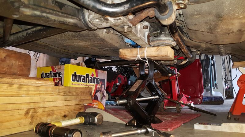

Control Arm install question
Car is 1989 Carrera 3.2. I removed my control arms and installed ER rubber control arm bushings, and purchased new Sway-A-Way torsion bars. Also installed new ER sway bar bushings. Left ball joints in control arms, as I just installed them two summers ago. Sway bar is fully installed on car.
The control arms came out during uninstall relatively easily. I did sense a bit of "couch up the corner stairwell" when taking them out, and so want to ask about re-install. Is it as simple as a little soap on sway bar, and just start working control arm in place, or am I going to be fighting the sway bar somehow? My concern is i get control arm relatively in place, but ball joint is nowhere near strut bottom. As with most of my 911 projects, I just haven't ever done anything like this before.

My thought was to install the sway bar to both control arms, attach them to the rear support and lift the assembly into place as one unit.

Bentley says control arms can be removed/installed with sway bar in place (for whatever that's worth). When I installed my turbo tie rods, I remember getting the skid plate back on was a HUGE pain because nothing lined up without help from Hercules. Was trying to avoid a repeat of that by having sway bar and pan all installed first.

I didnt get very far with plan A. Ended up removing cross member and assembling suspension on garage floor. Could use some feedback from people that have installed suspension as an assembly before. Is there an order of operation that makes install easiest? Currently i have crossmember loosely bolted to steering rack, with conrol arm fronts raised up. Working to get the long bolts roughed in that go thru ends of cross member and control arms. If there is a better way, would appreciate any advice.

There does seem to be some "magic" trick to it. I replaced the rubber and torsion bars and shocks and ball joints and tie rods. The instructions from Elephant on positioning the a-arms after the bushing install made it easy. Just follow those instructions.
My biggest chore was to get the anti-sway bar back on. I replaced the rubber bushings on the anti-way bar as well, and that meant drop it off. If came off easily ,and did not require it to pop out or twist at all. I figured I would just put it right back into position. Nope. I had to have a strong buddy to help position it while I go the bolts started.
The skid plate is really easy, once you realize the holes for the mount will easily rotate in position and align easily. I should have taken photos. Anyway just try to rotate the hole the bolt goes through and you will see it make it simple.

One time I was able to put my (stock) front sway bar back in with the a-arms installed. I jacked each arm to the horizontal to create the widest distance between the two arms' sway bar mounts (think of the circumference of a circle or clock...3 and 9 are farther apart than, say 4 and 8 o'clock), installed one end then somehow muscled the other in. I may have used a strong ratchet strap to help slightly compress the ends of the sway bar. I think the fact I succeeded this way may have been something of a fluke.
I currently have my front apart for rebushing. This time I did what it sounds like Bentley is saying: I dropped the front suspension as a unit, which means separating the steering rack (two bolts), them disassembled the assembly on the floor. When it comes time to reassemble, the jigsaw sequence will likely be: insert one a-arm into cross member; then install sway bar end into that arm; then install other sway end into other a-arm; then install that a-arm into the cross member. That way, you minimize fighting with the sway bar. I hope that helps. John.

Had everything put together, went to install the sway bar and no dice. I removed the control arm on one side (again) inserted the sway bar in the bushing and bolted everything back up. Easy as can be... on the floor in the garage by yourself

Sorry for not finishing out the thread. What I ended up doing was similar to what Ayles stated. I assembled everything on the floor, then lifted in place and loosely bolted everything up except left control arm at the front. It was just long ago that I don't remember EXACTLY the sequence of events. I think once everything else loosely installed, I was able to rotate/pry left control arm front in to position to get the bolts started. I don't think it was super challenging, as super challenging Porsche projects burn the experience in my brain. Regarding setting the angles on the brackets, I bought a digital level (Husky Brand) and it worked great. I don't think it was too expensive, and it seemed like something I may get use out of in the future anyway. Couple pics below. The one from underneath the car more or less shows what I did. Jack holding crossmember in middle, Duraflame box holding right control arm, stack of lumber holding left control arm. Hope this helps a bit.
Dang, another post I wish I could have seen BEFORE I put mine back together!!!
In the photo I can't see whether your struts had been removed, or are a-hangin' by the shocks as mine were because I didn't want to mess with bleeding brakes afterward. With the ball joints pre-installed on the arms, I had a hell of a time lining up the upper pin to the hole in the strut, even doing one arm at a time. I can't imagine trying to slip two of them in by raising the entire assembly at once. It, I suppose, wouldn't have been an issue to slide a loose strut onto the ball joint after the arms were secure, but I reinstalled everything in the reverse order from how it all came apart.

I didn't remove the struts. I'm sure I put one ball joint pin in at a time. I sort of remember wrangling the struts, slightly adjusting the pin so by the time they met up the pin and strut were colinear. I think I just use a jack to lift control arm up in to strut. I had replaced my ball joints a year or two earlier, and really didn't want to mess with removing and reinstalling again.
Glad it all worked out for you. My bushings were definitely shot (original from 1989). As it turns out, not the source of my loose suspension tho. I still have a wiggle wobble that I now have to assume is the rear suspension bushings as I now have all new components up front.
