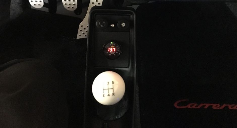

Here is my AEM gauge in action. Very good quality with a nice harness.

Mike, nice clean simple install! Looks great!
