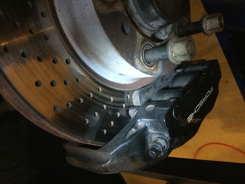

Rotors were turned down and the adapters milled to move the caliper as close as possible to the hub. Mind you, the reason why we did it was to fit the 996 brake under 16" Maxilite which give significant less room than a same size Fuchs rim. As a bonus even my 15" Fuchs spare with spacesaver still fits!
I am just speculating that theoretical it reduces the front bias a little, not knowing if that is large enough to be noticed.
I would assume you could also play with different pads and have a more aggressive pad in the rear. I am running stock 996 break pads, only those little weights had to be cut off from the out front ones.

Old 05-03-2017, 03:47 AM
Join Date: Jul 2013
Location: Munich
Posts: 266
the spare still fitting over 996 caliper. If you look close enough on above picture, some minor machining was required on the caliper itself

Originally Posted by HorstP View Post
Rotors were turned down and the adapters milled ....
when I read this it makes me shiver.
I'm ready to learn, but the idea of fiddling with brakes in terms of removing material seem crutial.
no?

I understand fully that you have a critical view on this but:
- tell me what removing 5mm on the outside of a rotor should make as a difference?
- The adapter is a very heavy piece of metal if you ever looked at one
My car has around 300hp now and I feel very comfortable with every modification done. Still needs some minor tweaks on the suspension, too much body roll in hard corners and a final mapping on the engine.

obviously it works. I'm just very careful in matter of brakes and the heat/force they must cope with.
maybe you can detail out more as to what, how and exactly where you reduced/removed materail (pictures).
might be interesting for others In case they plan to copy your setupt.

I really like this idea. I was going to ask about pad clearance to the center bore of the disc, but the pic clears that. So was the total amount removed from the disc 5mm in radius or diameter?
5mm radius would turn a stock 318mm rotor into 308. Interesting that it fits under 15s. I assume you removed 5mm from the adapter bracket as well?
Bill V - what do you think about this mod? Any downsides?

To the OP, did you have to machine the inner circumference of the disc (where the pad gets close to the bore)? I went and looked at mine (stock) and there seems to be a inner lip.
