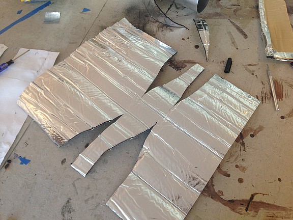

Intake stack’s bend insulation. This is outer layer = closed cell foam. Stuff cuts much easier than fibered insul. Pattern is not symmetrical due to subtle turn (towards inside of car) as duct also bends with axis of car.
http://forums.pelicanparts.com/uploa...1502797094.JPG

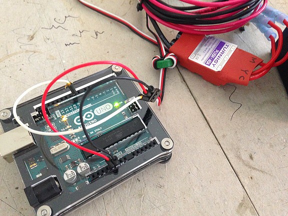

Arduino Sketch/Program
ESC is arming and operating brushless motor correctly with this sketch. For the moment, have turbine at half speed---noise level seems doable. Tested full speed... :eek:. Letting system run a few hours... checking motor & ESC temps along the way.
#include Servo.h // should be pointed brackets around "Servo.h" pointing away at both sides---Forum text format does not recognize those brackets. This calls "Servo.h" in from Arduino library
Servo myservo; // "myservo" is name given to servo
void arm() // setting up arming protocol specific to Turnigy Plush 40a ESC
myservo.write(0); // zero speed arms ESC
delay(1000); // 1 second delay required
void setup() // setting up connection assignment and speed declarations
myservo.attach(9); // pin 9 is signal wire connected to ESC
arm(); // arming protocol called in
for (int speed = 0; speed <= 90; speed += 5) // speed is initially 0 and goes up to half speed as measured in degrees---180 degrees is full speed, speed sweeps up to half speed in 5 degree increments
myservo.write(speed); //calling in speed protocol
delay(1000); // sweep up proceeds in 1 second intervals, can increase interval but not decrease from 1000ms
void loop() // nothing loops

Arduino powers up with 5v from ESC via BEC cable. (ESC is connected to 12v battery here.) Sketch is automatically run by Arduino (on power up) with arming signal sent back to ESC (white wire)… followed by protocol for brushless motor to run. ESC has 3 pulse wires connected to brushless. System works given forked power wire at compressor... one fork leading to ESC. When compressor is ON… so is ESC>Arduino>brushless motor.
