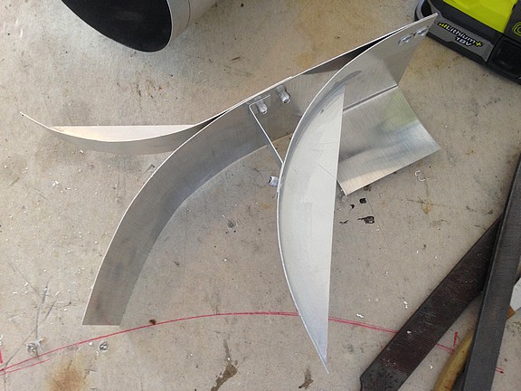

Air deflector refinement
Earlier air flow check revealed need for deflector inside bucket. Purpose = better distribution of air across entire condenser's face. Large, single blade deflector was added. Improvement but bucket's top corners = dead zones. 2 more smaller blades are being added. Intent is dead zone fix.
http://forums.pelicanparts.com/uploa...1501861337.jpg
Larger blade's unstable.
http://forums.pelicanparts.com/uploa...1501861337.JPG
Strut added.
Approximates internal position.

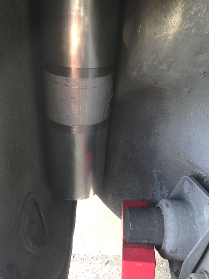

Aviation duct. Interior in static form is “semi-smooth” bore. Increase compression and interior gets rougher due to folds.
http://forums.pelicanparts.com/uploa...1502044427.JPG
Intake. 4” diameter stack fits without needing to crush it. Intake opening is about 2” up from bottom edge of rocker. What happens when driving car through standing water when water exceeds level of intake?

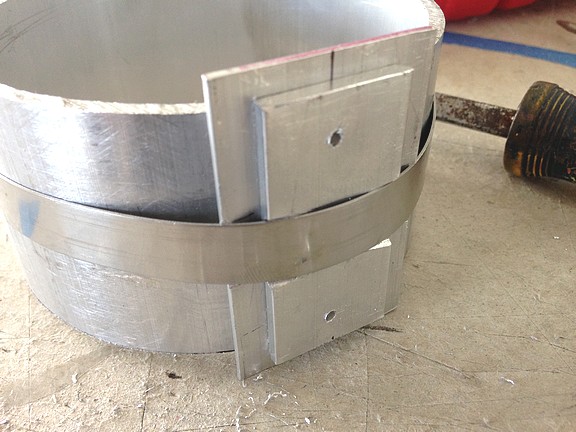

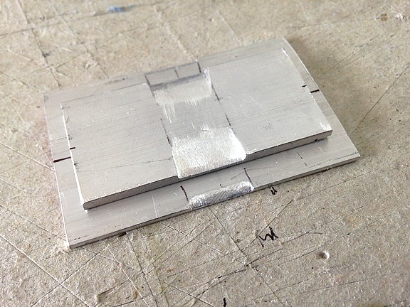

Was going to zip tie duct here to engine lid release cable's sheath. Not happening. Need alternative solution. Duct arches up here so tension alone will secure it to a point. Jamming it into wedge will likely also hold it. Weight of intake and turbine sections are supported by forward attachment. Point = CEET section weighs very little.
Discseven 08-06-2017 11:31 AM
Port re-positioning plan has changed. Intake junctions are close enough that only slight mod is needed to make this connection---rotate port down and bend it forward slightly. Outlet port is more challenging. Did not want to add splices (in order to prevent increasing seam count in AC system) however, adding a long extension outlet port to the condenser has bad vibes. Prefer stubby outlet on condenser and adding splice between existing hose's end and condenser. Is on Tuesday's menu.

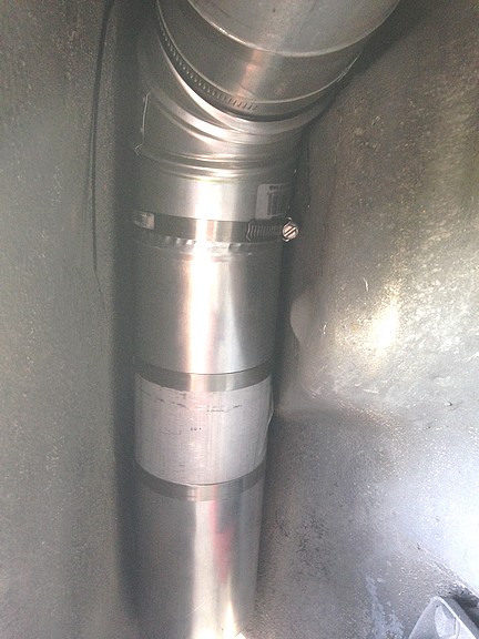

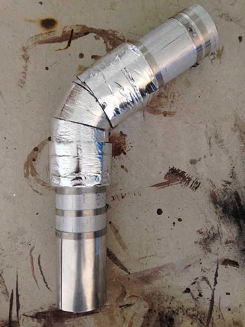

Intake stack
http://forums.pelicanparts.com/uploa...1502403977.JPG
Hard-duct bend that transitions vertical intake to turbine-blower is locked into bend-position that was proof’d during “final fitting.” (If not “locked” into position, bendy segments rotate out of position leading to bend loosing preferred form.)

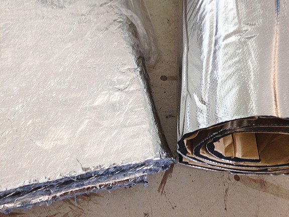

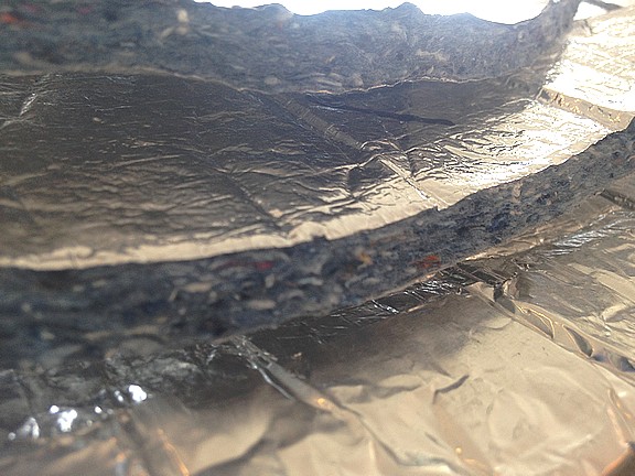

Two reasons for insulation. 1. Turbine/motor silence (to targeted degree) 2. Thermal isolation of cooler air being pumped to air-bucket. Focus at moment is silencing.
Plan is to install 2-layer insulation near turbine/motor to start with. Single layer of foam on CEET duct to end including covering air-bucket. Will bench test that set-up... first to establish good volume of air through condenser (reprogramming Arduino until preferred turbine/motor speed is achieved.) Noise level consideration follows.
Foil coated fiber insul was purchased first thinking to do entire wrap using this material. Bad idea. Even if cut edges are sealed, foil skin is very delicate---look at it too long and it tears. Once foil layer is compromised… stuff is a sponge. That revelation led to getting closed cell foam... with near bullet-proof foil. (Challenge faced with insulation was ordering from USA supplier---there’s lots of China insulation sellers online. No offense to China but impatience is a factor.) Fiber'd insulation being a potential sponge requires decision: dump it, or, go extra mile to make what’s in hand work. Will go extra mile(s). Even though fiber'd insul is below foam, zero water tolerance should be tolerance. Waterproofing solution of some sort is ahead.
Double-layered silencing insulation has turned 4” O.D. into 5”. Stack fit at 4” measure with a little clearance remaining. Will make sure 5” stack O.D. fits before moving ahead.
Test stack. Bottom fiber insulation layer is fully in place here. Temporary top foam layer is wrapped on vertical and straight after bend---makes no sense to cover bend if thing doesn't fit. Test fit = snug. Is good news.

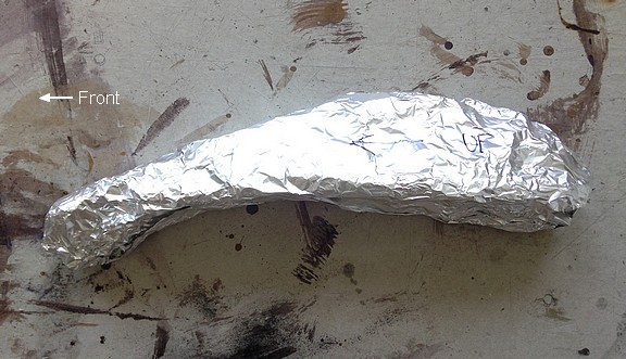

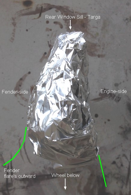

CEET duct area
Where CEET duct will position, it’s been suggested to use car’s structure as a duct. Car already offers 2 sides… enclosure side needs creating. (Idea spins off Porsche using 917’s tubular framework as oil line.)
Foil cast is made to study crevice space above wheel. Above, looking down on cast. Below is profile view of space. Top of cast in profile view would tilt to right at top slightly to mimic actual angle of space. (Glass sill is close to being horizontal in car.)
Decide for yourself---conclusion here is there’s necessary air-space for creating a “car duct.” After tossing idea around a bit… conclusion = PRO: car-duct would position duct as far from tire as possible. CON = making car part of “duct” means brushless turbine’s noise-energy will transmit through car to some degree. Based on this “con,” “car-duct” idea respectfully bites the dust. Am going forward with CEET duct over wheel area.

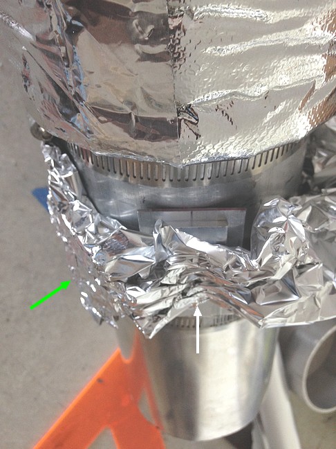

Discseven 08-10-2017 03:26 PM
http://forums.pelicanparts.com/uploa...1502407424.JPG
Plan was to connect intake stack to car at “bulbus” area---indent in cast, white arrow. Alternate contact point is flat surface area---green arrow. Given rise of “friction-fit,” (due to new 5” O.D.) static demand on this mount has decreased measurably. High g-forces from bumps, etc, are still taken into consideration. Hefty screws are in mind together with fail-safe quick-release on clamp.
Not fond of putting holes in tub but screw-job seems most appealing here. Less secure idea = wonderful… until something makes unwanted escape.

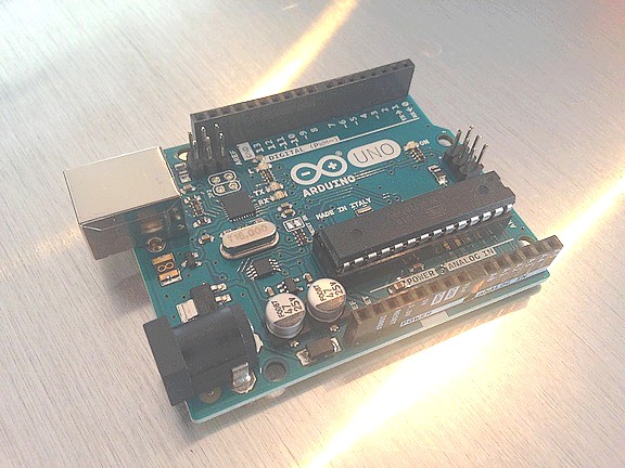

Discseven 08-14-2017 07:50 AM
Arduino & Zebra case
http://forums.pelicanparts.com/uploa...1502722750.JPG
Using UNO. Board measure = 2.75” x 2.25”. Robotshop... Arduino Uno R3 USB Microcontroller - RobotShop
Raw Zebra case.
Beta program/sketch is being loaded---cable is connected to laptop.
IDE error message = avrdude stk500_getsync() not in sync resp=0x30
Fix = reboot Arduino (at Arduino Reset)
