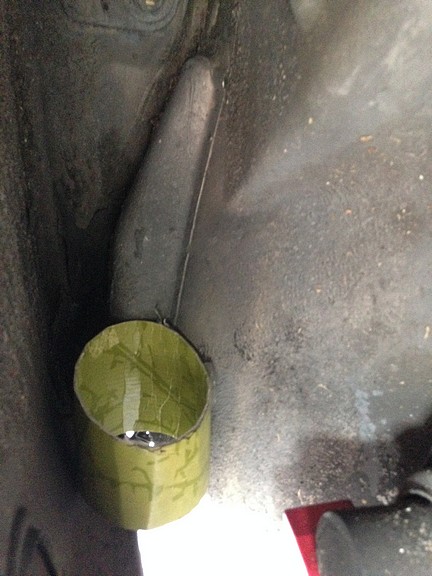

4” duct is planned.
4” positioned above wheel.
Intake.

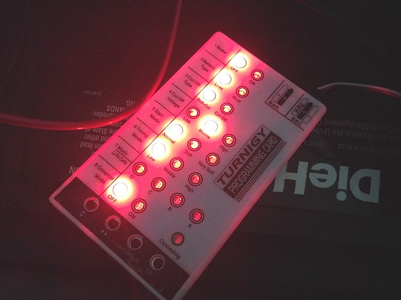

Two critical questions loom at this moment. 1. Will motor in hand work with RC EDF electronics? 2. Will turbine’s noise level be suppress-able enough?
To get motor running... according to RC flight hardware specs, EDF requires Electronic Speed Controller (ESC,) and either a receiver/transmitter or a Servo Tester (ST) to make motor do what you want it to. (In simplified terms, brushless motors operate on an electric pulse system via 3 wires---can see those 3 wires running from ESC to motor, pic above. Pulse speed as distributed by ESC to motor determines motor’s speed. Speed is dictated to ESC by either a receiver/transmitter or in this case an ST.)
According to EDF pilot wisdom, one gets an ESC with a bit more amp capacity than motor uses. At max output, motor in hand draws under 30amps. 40amp (Turnigy Plush unit with a Battery Elimination Circuit---BEC) is purchased… unit in pic above. BEC incorporates a 5v power supply along with the signal wire from the ESC---smal white-red-black wires seen coming out bottom of ESC. As name implies, a BEC does away with need to manually add 5v power supply to either the receiver/transmitter or Servo Tester. (Am total RC flight noob getting school’d.)
ESCs need to be programmed before use (so ESC knows how to operate.) Can do this easily with programming card, in this case a Turnigy card to match Turnigy ESC. Programming takes just seconds and ESC’s supposedly ready. This card, ESC and ST are a few dollars in total.
Once ESC is programmed, card is detached from ESC and Servo Tester (box with blue light) is connected to ESC. Then power is connected. (Apparently connection sequence of this flyer-gear is very important---hardware is supposedly ruined if wrong connection sequence is done.) ST has knob that turns motor ON and allows for speed/thrust adjustment. Power light ON here is first sign system lives. I turn knob and thrust too lives… albeit exiting intake’s side. To invert, swap any 2 of the 3 wires serving motor. Done…
Thrust is now exiting correctly. Turbine’s speed is controllable via ST. And noise from unit seems manageable given estimated speed of turbine needed to deliver a significant volume of air through condenser.
Challenge of significance is quickly uncovered. If 12v power feeding ESC is disconnected, idea was… when 12v power was resupplied, motor would resume working at speed it was at when previously shut OFF. That’s not happening. Am having to turn Servo Tester OFF, then dial it back up to speed each time 12v power is turned ON. This protocol makes perfect sense as a fail-safe in RC jet pilot world. For Porsche AC app… this protocol is not amusing. In Porsche AC app, ON/OFF power intended to serve ESC unit is related to compressor’s ON/OFF cycle. You see problem? One way to go is to constantly power ESC but this still requires manually turning UP power to ESC each time AC is turned ON. Accepting this is not happening. There’s a way around it. Just need to discover that way. Any ideas? (Anyone know what failsafe circuit will look like? I’ll cut it in ESC.)

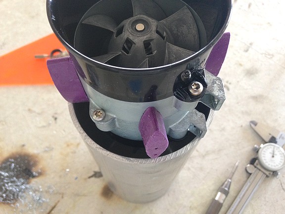

Turbine’s housing O.D. is 70mm---measurably smaller than 4” duct. I questioned whether to narrow the duct at the turbine… or… to center turbine unit within solid 4” aluminum tube. Tube direction is chosen based on materials on hand.
Rubber fenders will center and isolate turbine housing inside 4” tube.
Using EasyMold. 2 stainless 4-40 screws with washers get embeded into each fender. These two screws will secure fender to turbine housing. Once all fenders are mounted to turbine’s house… house unit gets inserted into solid aluminum tube. Will secure fenders to aluminum tube with wood screws… plus compression-grip of fenders.
“Mold platform” set-up with screw-pairs in place. Depth of screws in platform is slightly shy of turbine housing’s thickness.
EasyMold (EM) cures to hard rubber. Access to embedded screws is provided by channels cast into EM---small pipes placed into cast. EM cures quickly (possibly adjustable by altering quantity of hardener---I’ve always mixed 50-50 so not sure about this.) There’s just enough time to fill and work single mold in this case before time’s up. Trick = ensure entire mold cavity is filled and media is “internally connected” before times up. Once EM reaches a certain point, it no longer bonds to itself meaning if layers are added into mold and not blended together before time’s up, casting is fractured.
Casting’s came out good except for each mold being over-filled. Was going to “squeegee” excess off top of molds but spent time ensuring cavity being filled and good internal blending existed.
Excess rubber is sanded away from every fender. Rough grit takes EM down easily. Each fender’s height is now set to grip-compress 1/16” when installed.

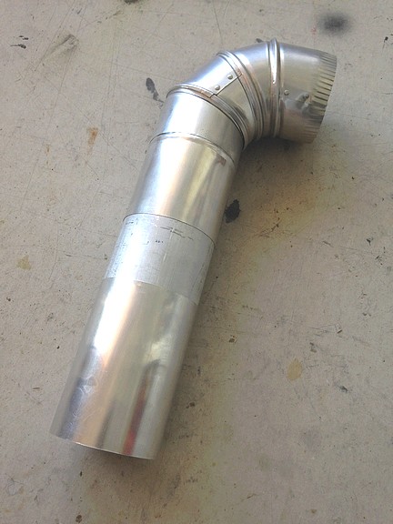

Test fitting ducting in fender.
Was planning on one elbow duct section connected to air-bucket... then a straight section where turbine would be... then an elbow to a straight section above the wheel. Point being to mount turbine section as far away from cabin as possible. Not happening. There are bends in duct from beginning to end here. Is difficult to see because of camera angle. Were one looking through fender… constant arch of duct would be seen. Plan “B” is to mount turbine next to cabin wall. Noise suppression challenge has just been elevated some degrees.
Straight thin-wall duct squashes easily. Have not yet quashed an elbow piece. Is possible elbow's formed seams will not handle squashing well. I did not install any test duct just ahead of duct section above wheel. Space was measured instead... primarily for turbine and Glenfilter. No problems are seen fitting these sections in.

Yo' Kinky Karl, Aircraft Spruce is one good source for the tubing (called SCAT tubing).
Ducting from Aircraft Spruce

Thanks for idea RN... damm fine upgrade!
RonO... you the wingman ! Just checked Spruce out---am on it. TY!

Before going further with brushless motor program, been researching to see if & how unit in hand can be controlled “correctly” as this AC app requires. Appears it can but not without experiencing a mucho greater learning curve than anticipated. Problem that needs getting around is... standard RC speed controllers need to “arm” themselves every time before they begin to operate a brushless motor. Attending this manually is certainly doable but also certainly undesirable. There are any numbers of ways to solve this problem---challenge is to find simplest way to automate it. At this moment, using an Arduino is most appealing path.
...Point in this research is to determine---right now---whether brushless motor direction is viable or not. If not, time to head in new direction. Have chosen to stay with brushless and sort it.
Tap = 4-40 (for screws embeded in fenders.)
Fenders attached for compression check. 1/16” compression per fender is too much---makes for difficult fit of unit into aluminum tube. (Housing's footers will remain in place until there’s no need to bench test motor further. Will cut footers off eventually.)
Sanded fenders down to 1/32” compression per. Should still be good grip (when inside tube) while allowing unit to get into tube without destroying fenders along the way.
Finishing intake stack.
Splash shield and top sections added.
Top-to-bottom measure = 18.5” Will fine tune this measure based on next fitting into wheel well. Right now plan is to position turbine blower just after bend at stack’s top. Aviation duct RN suggested may change this positioning---may be possible to move blower as far from cabin as possible… close to condenser. Idea being to manage turbine noise---as heard from inside cabin, windows closed---with every incremental move possible.
Aviation duct is ordered. Will do another fit-in-car as soon as it arrives. Will be interesting to see how that stuff compares to turns metal elbows make.
Main challenge on hand now is designing "elegant" electronic solution for motor's operation. If anyone happens to know Arduino sketch that will automatically arm and operate brushless 3-phase motor at prior shut OFF speed... say so please.

Wiring plan. All this is necessary to deal with Electronic Speed Controller (ESC) needing to be armed every time it operates. Manually arming ESC... possible but not happening here. Why bother with ESC? Because there's no other way (I've found) to move big air through this "ducted bucket system" than with a brushless motor spinning a robust turbofan.
4-wire cable goes through engine-bay-to-cabin bulkhead---plan is to run this cable into cab next to DMI harness. Arduino and ESC are headed below-dash somewhere. ON/OFF for turbine is activated by circuit from compressor---when compressor is ON... turbine is signaled ON. 12v power feeds into ESC. When ESC gets 12v, BEC cable off ESC supplies 5v power to Arduino (no step down needed.) Arduino is programed to first arm (initialize) ESC... Arduino program then instructs ESC to accelerate turbine to a defined speed. (Defining what speed will require a few test runs to sort out.) Program/sketch is possibly ready. Am waiting on Arduino to arrive to get on with this. Am collecting cable & bits today.
Also waiting on smooth bore flex ducting. When it arrives, one more test-fit is called for to get a final install measure for all parts.
