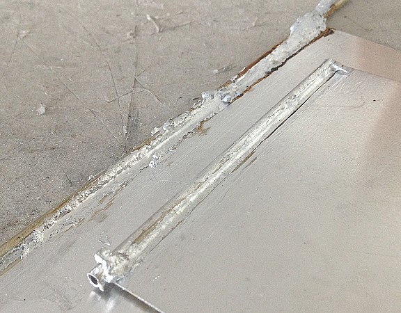

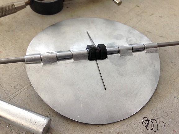

Coastr’s air-valve
http://forums.pelicanparts.com/uploa...1503940014.JPG
Bi-fold door panel and pivot parts. Idea is to weld tube to panel then interlace-cut 2 panels together to form bi-fold door-valve. Planning on torsion springs to work doors. Gizmo will mount in secondary intake to be positioned just after Glen's Filter on intake stack. Material is 0.125" O.D. / 0.095" I.D. tube and 0.025" sheet aluminum.
Tube (with post inside) is clamped to floating “L.” Door panel is leaned against “L” and sitting on tube. Point of this relationship = eliminates having to clean up (remove) extra door material that would otherwise exist on other side of tube.
Loaded up on weld material here. Removed a lot by filing. Not the way to go here IMHO. Am continuing my low-temp weld schooling...
Applied 350 dF rod at different temps---goal is minimal weld material application without being too sloppy. Lower temp accomplished sloppy… rod flows but clumps. Higher temp is smoother version.
Flux creep. Is easy clean up with fine grit s.p.

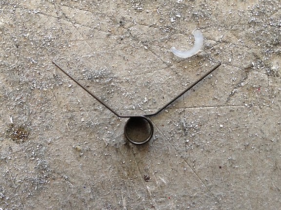

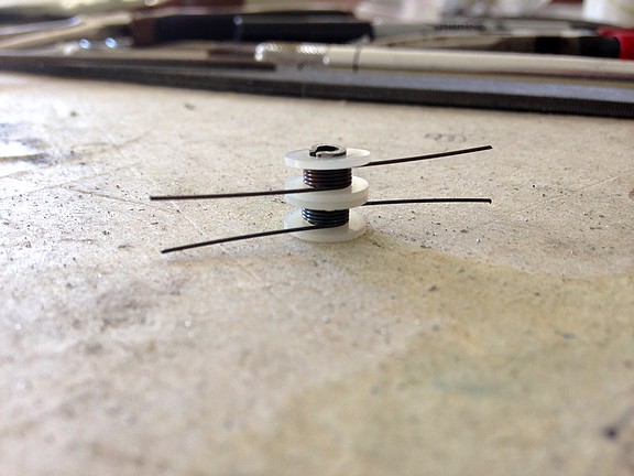

Got 2 sizes of 180 degree torsion springs to play with. Never having worked with these before, am not 100% clear on how this is going to pan out. Already have a few challenges in hand. Gona set this aside to allow obstacles to simmer.

Air valve continued
http://forums.pelicanparts.com/uploa...1504053117.JPG
First interlace template. Began cutting this into panels that have minimal weld material… narrow hinges failed.
2nd template. Will use panels with too much weld material.
Planned on testing valve with 2 springs first. Mandrel will fit 3rd spring if needed.
Springs naturally set up with their legs on intake side of doors. Could go this way but would need to add retainer that holds legs when doors swing back. Bending springs allows legs to position on back side of doors---no retainer needed. This bend measurably pre-loads spring. Going with single spring now.
