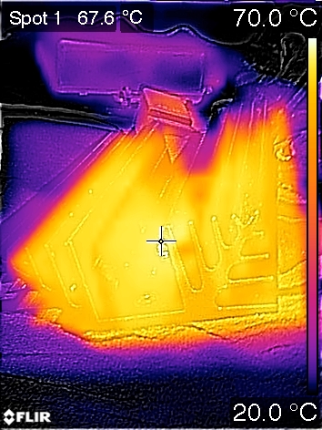

Is it possible that this thing needs a proper heat sink that isn't present under my seat? I found a photo of what it looks like installed in a 993, and that whole metal bracket might be acting as a heat sink. It just seems unlikely, since this thing has been under my seat for a thousand miles. I wish I remembered how it was installed...Maybe it was using my whole floor as a heat sink? I still dunno. It's been fine like this for a few hundred miles at least.
What are 3.6 swappers doing with the ignition module(s)?

Yup there were dual output modules used in 993s-not 964s
I'd be checking wiring between that and the coils-something going to ground?
And then check both coils-ohm them out carefully.
Heat is a sure sign of excessive current draw.

And yes it needs the heat sink-they pass a fair amount of current and do get warm.

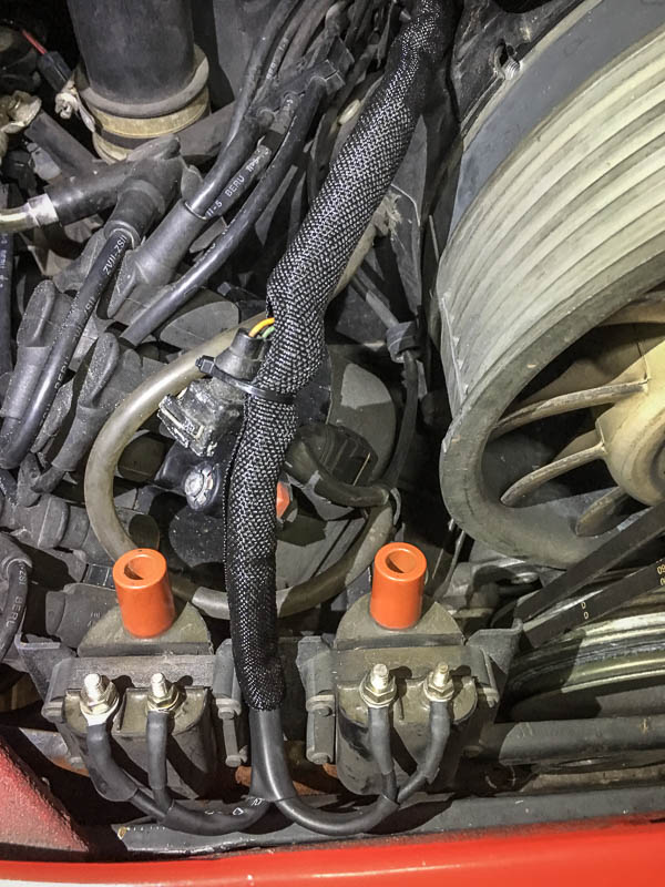

We have a 3.6L conversion 1992 964 - it has 2 ignition modules located on a bracket that also
holds the 2 coils in the engine compartment driver's side -
EDIT: I just took a look at the Porsche parts pdf and the 993 only has one ignition module and
one combined dual coil - - is that what you have in your car?? The module seems to be mounted on a bracket with the coils - not under the seat.

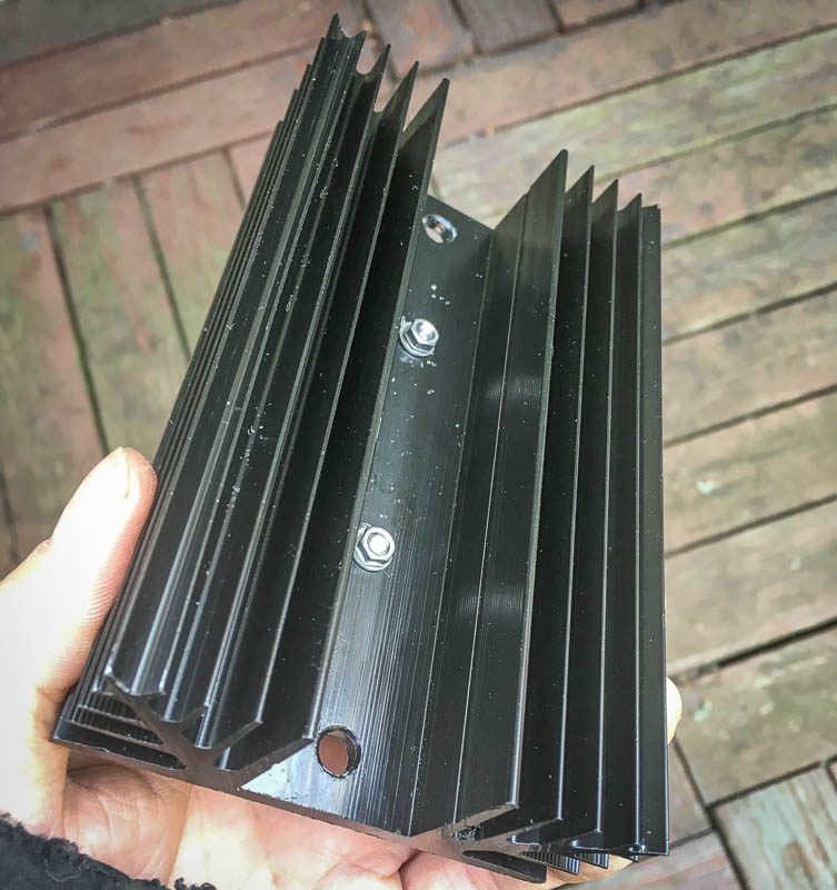

I bought a factory heat sink and some thermal grease...My current plan is to bolt the little heatsink on with some screws and thermal grease, then attach it to the painted metal floor with thermal paste. This is...more experimentation than I'd like.
I've got a [url=https://rennlist.com/forums/993-forum/1010758-i-just-can-t-get-this-thing-to-spark.html]thread on the Rennlist 993 forum[/img] in the hopes of finding more specific stuff there, but some of my car is 3.2 and some is 3.6, sooo...

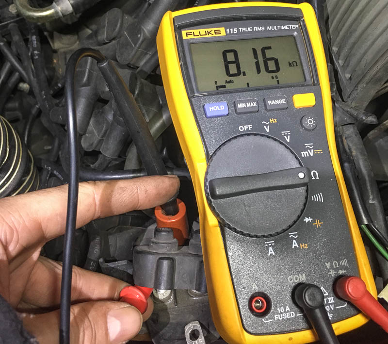

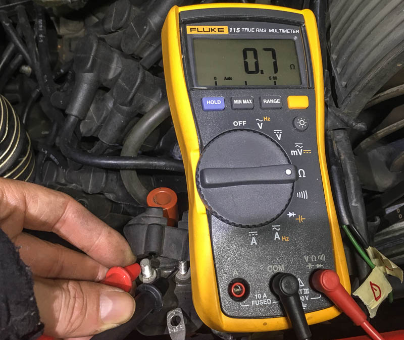

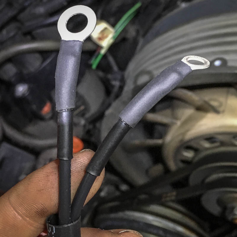

I'm doing some modest tests on my coils. According to this thread, I want 0.7Ω for the primaries and 8200Ω for the scondaries. I'm also not too sure these measurements are super accurate, since it would sometimes fluctuate wildly, but these numbers were the most consistent/stable...and seem fine:
Coil 1
Across posts 15 to 1: 0.7Ω
Across posts 15 to 4: 8.16kΩ
Coil 2
Across posts 15 to 1: 0.8Ω
Across posts 15 to 4: 8.14kΩ
The terminal wires don't look bad, but they don't look great, so I might redo them.

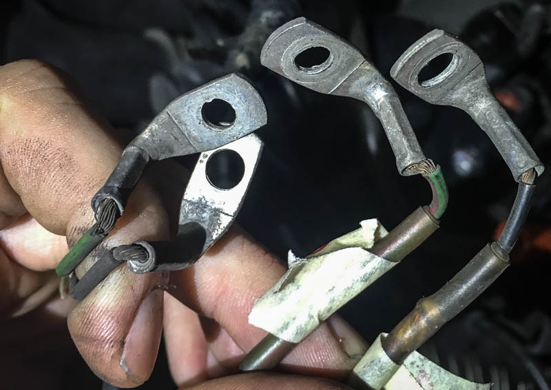

I was waiting on parts and I couldn't just leave those janky wires there, so I redid them. I tried to find some 90-degree eyelet lugs, but I couldn't find any that would fit posts this small—at least not without waiting a week and paying $5 in shipping. I just used regular ring terminals and bent them. I used a bunch of shrinkwrap in the hopes that it will act well as stress relief in these tight quarters. Also got a chance to try out my Techflex split sleeving...
I found that both 15 posts came from the same wire that was spliced in the engine bay. Not sure if that's normal or what...There were definitely a few cracks in brittle installation in the wires, though they seemed to improve in condition towards the firewall, so I didn't tear anything out—just cut the wires near the fan and ran new 14awg to the posts. A splash of Fluid Film will ensure the posts stay clean.

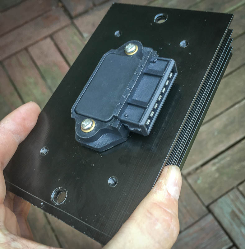

I believe I have attained success. I slapped a biggass heatsink on the new ignition module (cheap knockoff), joined together with Thermaltake TG-7 thermal grease (shoutout to my overclocking days) and some bolts. The car started up, the heatsink quickly warmed. During an hour drive, the ignition module temps stayed steady below 70°C (see underseat thermal pic), and the car ran brilliantly.
I'm not sure why the original module lasted as long as it did with no heatsink (it was a factory Bosch part), but as long as the car is running steady, I'm inclined not to worry about it.

I had no issues with the car after I moved to California and ran it up to Big Bear a bunch of times...I sold it after a year, so I can't speak to the longevity, but I had no issues with that module after adding the heatsink.
The stock setup is using the back metal bracket and chassis as a giant heatsink, but if yours is under the seat that's not much of an option unless you attach it to the floor...Giant amplifier heatsink or desktop CPU heatsink with 12V fan.
70°C seems too hot to me for electornics, but it did work!
