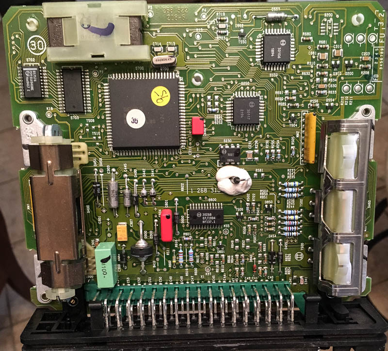

This is all helpful, thanks! So:
- The DME relay behaves properly outside of the car.
- The DME relay socket has good ground.
- The DME relay socket has 12v on pins 30 and 86 with the ignition off.
- There is 12v to the ignition coils.
- Test light flashes on the ignition coil inputs while cranking (barely).
- The fuel pump kicks on while cranking.
- No visible indication that the Motronic DME is fried.
but no spark.
Current theories:
- DME is toasted somewhere.
- Both ignition coils are toast.
- Some combination of problems (one dead coil, broken distributor belt).
I wish my test light flashed more prominently during cranking on those ignition coils...I'm not certain it's not just power fluctuations due to load. That said, according to the post from uwanna, my fuel pump wouldn't spin if the speed/reference sensors weren't good, sooo...
It sure seems like the DME is toast, but it's friggin' immaculate inside. I'm gonna find a way to test the ignition coils and put an eyeball on that distributor belt.

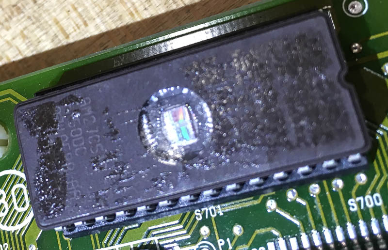

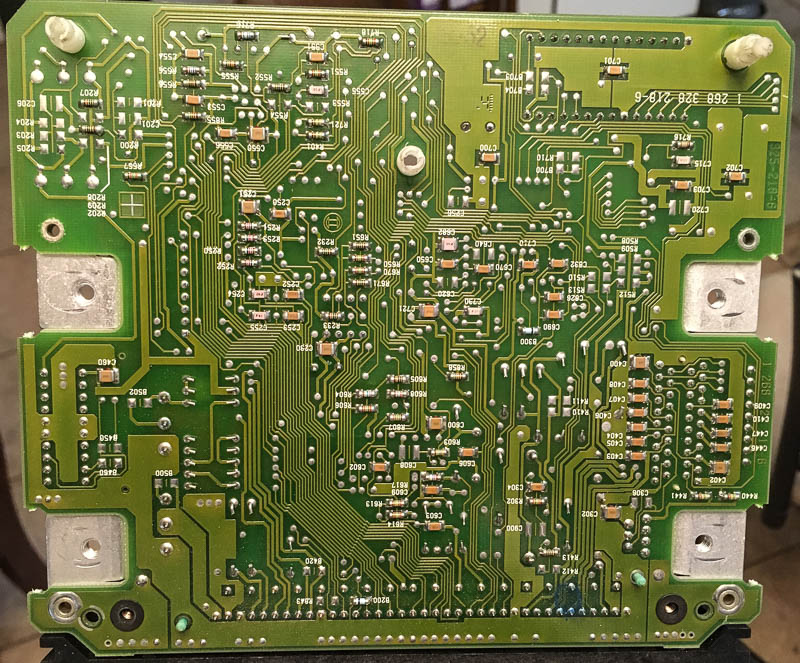

I realize there need be no visual indication for a circuit board or chip to be bad, but damn. Opened it back up, pulled up the little white pin insert to allow the board to pop out of the case, and got shots of both sids this time.

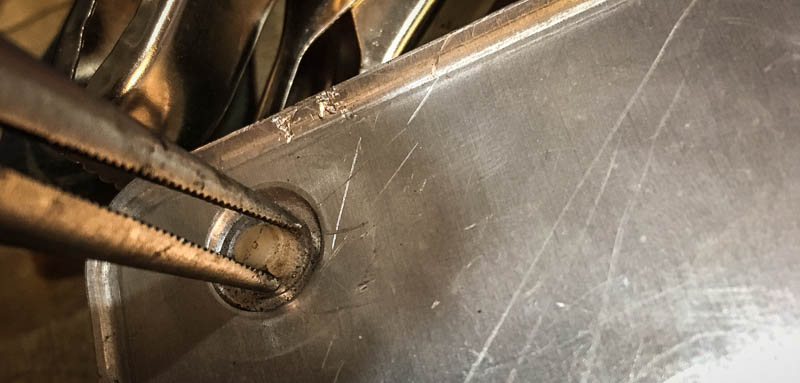

...Progress? A hot tip on Rennlist pointed me towards the existence of an external ignition module for this motor. If it wasn't bad before... I think it is now. I found this under my seat, resting on metal after some interior work. I guess it got detached, and since it was under the seat, I didn't notice.
Current (hopeful) hypothesis is that it was bouncing around, metal moved inside, and it shorted itself out...But I would think that the ignition coils wouldn't flicker my test light if this thing was the real problem, right?
One edge of the metal plate was detached, so I gave it a bit of a tug and it came apart. What a weird piece of electronics. It smells a bit burnt, but it also might just be the peanut butter smell of all the gunk this thing is coated in.
I guess I'm waiting on parts, now.

Sure looks like a bad ignition module, obviously. But you should have two modules. one for each coil. If one is kaput, don't know why the second one wouldn't fire the engine. Perhaps the burning smell you noticed was from the broken module and
could have possibly damaged the ignition output driver circuit in the DME ECU.
Before installing new parts I would try to test the ignition output circuit using the
procedure below. If you don't have a scope, maybe you could use an LED test lite
to check for the pulses. Just a thought.

Well. It was the ignition module (I believe there was only one in 1995). Kind of. I bought a new cheapo ignition module, the car leapt to life, and I howled like a maniac!
Then about two miles down the road, it died suddenly again. I pulled the ignition module and it was hot. Like crazy hot. Almost burned my hand. I let it cool down, but the car won't catch. I assume this one is toast too, or was no good to begin with (though that seems unlikely based on the circumstance).
So. There is clearly a condition that is frying the ignition module. What could cause that??
