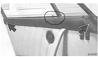

Can you open your door latch with the door open?
Maybe a stupid question but ....
With your door open, if you manually turn the latch to the closed position, can you pop the latch using either outside or inside door handles?
Doors are ripped apart and I'm chasing some issues.
Thanks
Rod

hi..very simple..unlock the locking rod(PULL IT UP) and now you can open from outside handle or inside pull handle
here
if you have central locking system in your 911 unlock your door with the key
Ivan

2 issues.
Passenger inside handle would not work and it felt like it was locked.
Drivers side would not lock with the key (central locking is working)
I took the latch apart on the passenger side and cleaned it up. It now works (no idea why) and you can unlatch it with the door open when you couldn't before using the outside handle.

hi..it is possible that your door handle trigger sensor is either of or not working
number 5 on this pic
It appears to working, but now I have a broken #7 in your diagram. Where can I buy one of these? Do I need to replace the actuator? Grrr
I really need to know the answer to my original question ... please.

911rod...you need to just replace the rod here is part number 964-537-571-00-M100
pelican part have it..

Update. So much fun having a 31 year old car with 400,000 km.
Passenger side appears to be working fine now (would not open from the inside) after cleaning and lubing the latch and replacing the arm for the actuator. I haven't put the door card back on yet tho. Adjusting the actuator up or down relieves stress on the inside handle and makes it feel smoother.
The drivers side outdoor handle was opening the door when in the lock position and didn't work at all sometimes. Turns out the bushing in the latch mechanism has worn so the arm on the right in the picture is leaning out. Now it catches the arm to the left when locked and unlocks the car. When unlocked the one on the left goes back so the one on the right misses it all together hence leaving the outside handle inoperable.
Need new latch? Are we havng fun yet?
