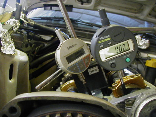

What range do I need?

0-.5" or 10mm is sufficient for setting valves. You will also need a 2.0" extension.
MSC has a range of indicators including some that are less expensive than the ones McMasterCarr carries. I remember Automotion selling the Tekclock ones.
I really love the digital ones. They are much easier to read esp. as our eyes get older.
-Chris
MSC page 1305 with Tekclock dial indicators
MSC page 1311 indicator extensions (See "Y")
EDIT: I just noticed the Z-block tool comes with an extension.

On MSC page 1305 you want the Metric Tekclock one, specifically the one with the 10mm range (#06450134).
The vertical lug on the back isn't necessary for the cam timing using the Z-block tool but you need it for everything else.

The Tekclock one is around $56 and the Mitutoyo digital ones start at $127. I have two Mitutoyo digital ones and I like them. One of mine is the first one on page 1300.
The tips on the Mitutoyos and the non-digital metric indicators (like that Tekclock) have a metric thread (2.4x.45) vs the "english" 4-48 thread. The threads are so similar that if I didn't tell you, you would never know from using them. If that sort of thing keeps you awake at night you can buy a converter on page 1311. It's listed with the dial indicator extensions.
-Chris
Mitutoyo digital indicators on page 1300
