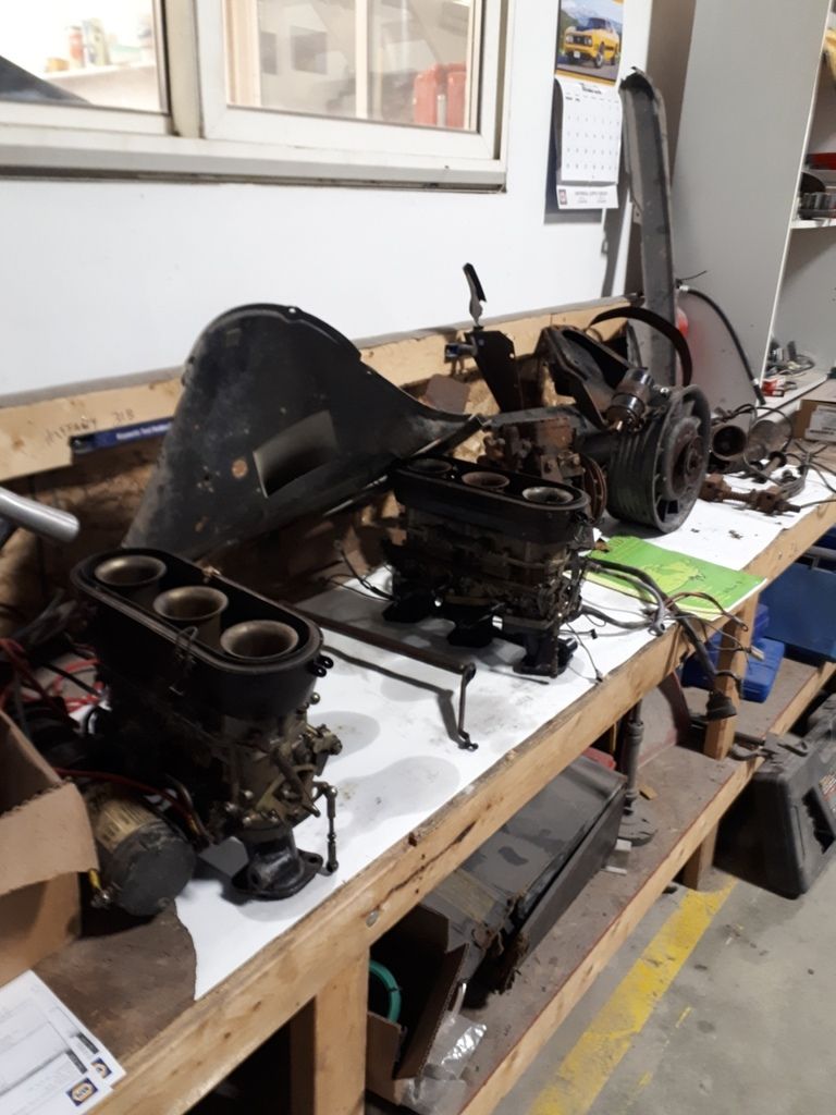

Having a hard time sourcing some parts. Like the throttle cross shaft ball stud that bolts to the right side carb, and a double groove pulley for the A/C.
Any help would be appreciated!

I might have the throttle shaft mount. I'll check this weekend.

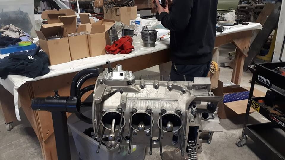

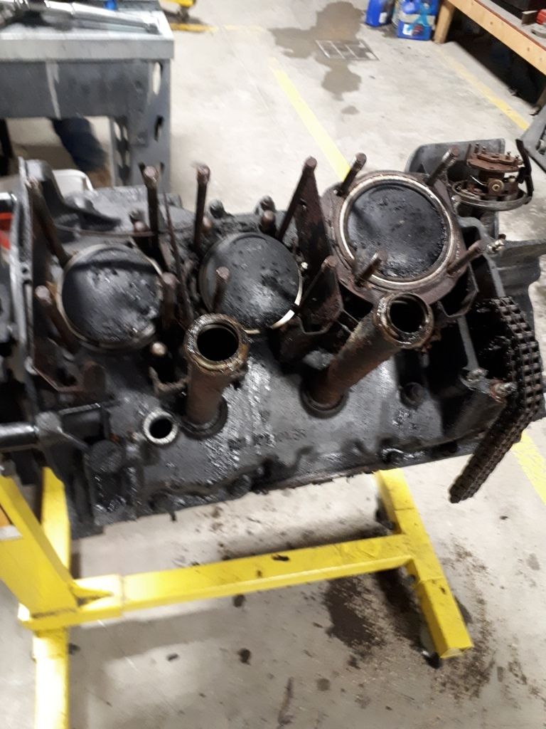

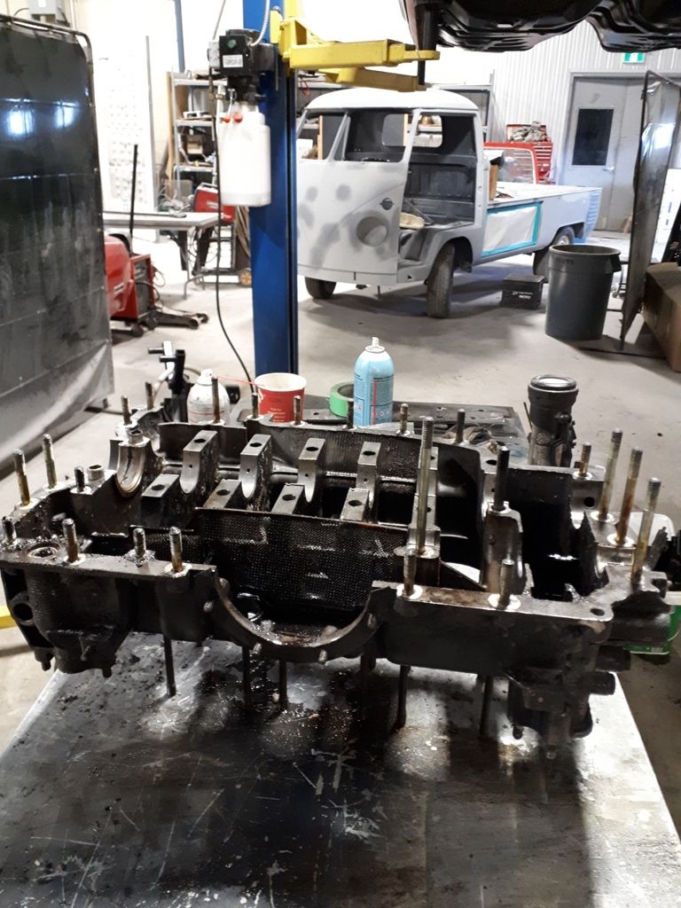

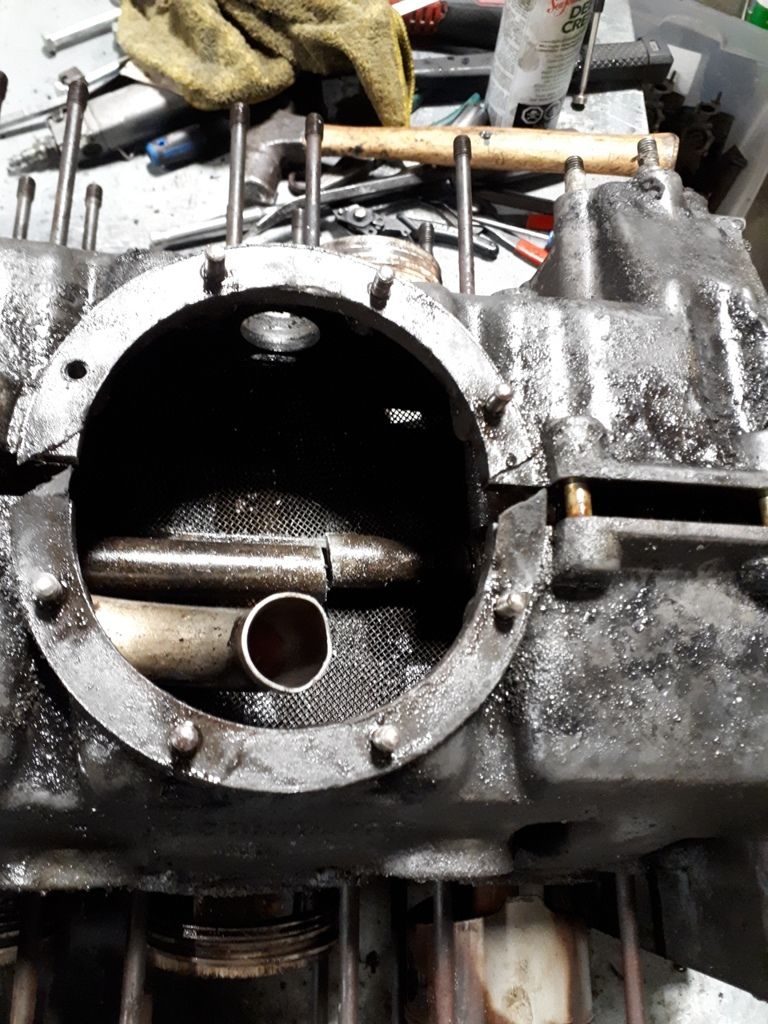

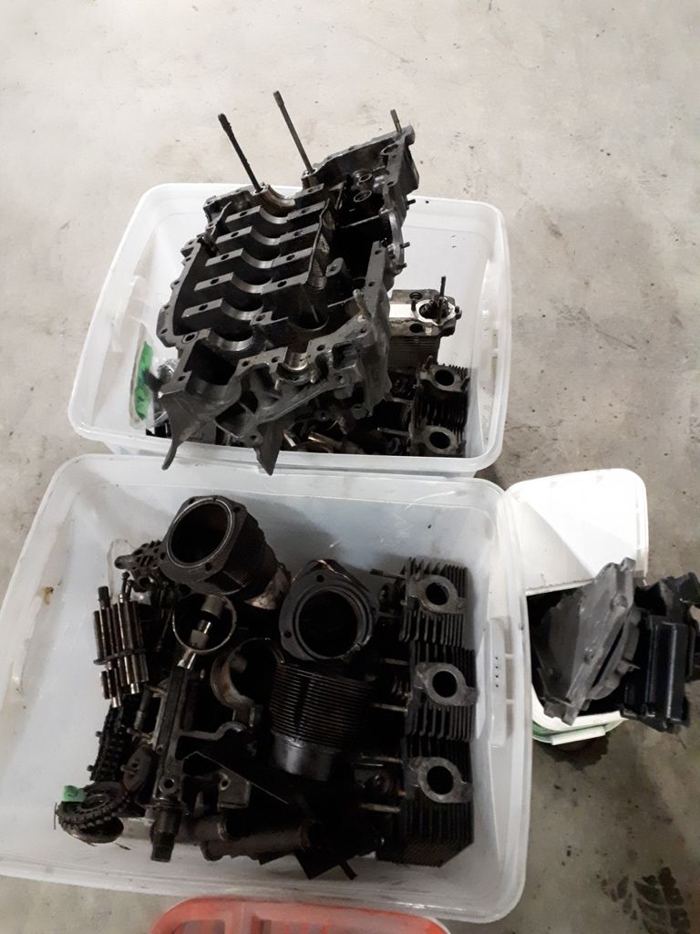

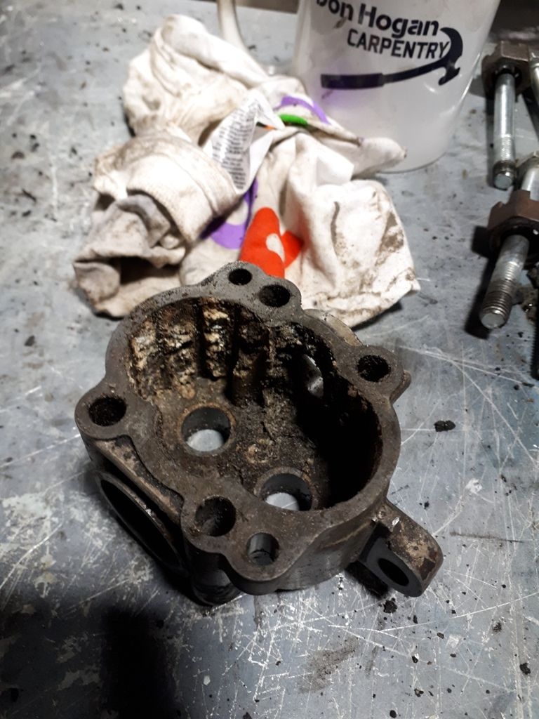

Well we got the cases split on the 2.2. Turns out we had 2 pistons seized in their bores preventing the crank to turn, but the oil pump was also seized up with gunk that we had to cut the oil pump drive shaft to be able to turn the crank for piston removal.
Severed oil pump driveshaft,
Crank bearings are in fantastic shape and the crank looks great so we got lucky there.
Boxes of stuff,
Oil pump,
Fun stuff!

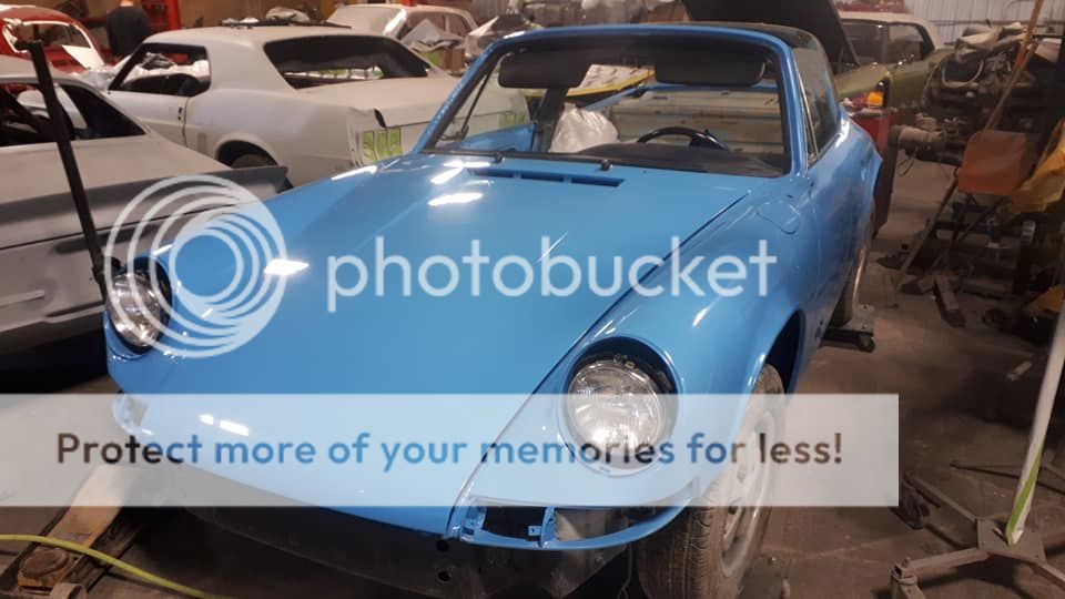

Well we got the body work all done and a shiny coat of blue!
Now we just need to finish putting the body panels on and give her a nice wet sand and polish!

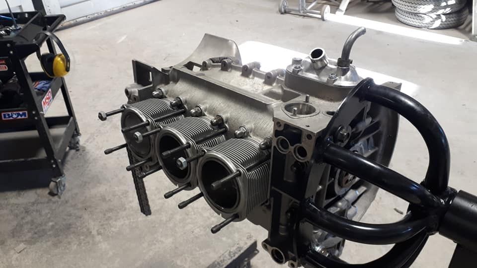

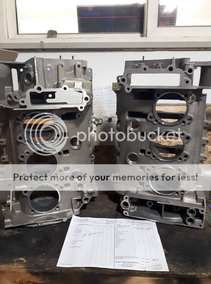

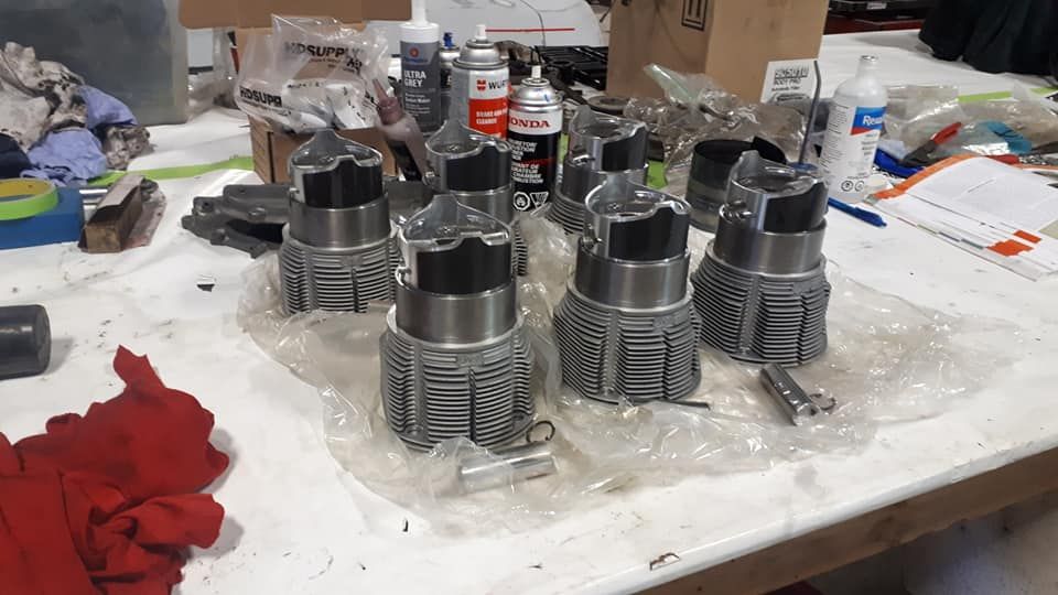

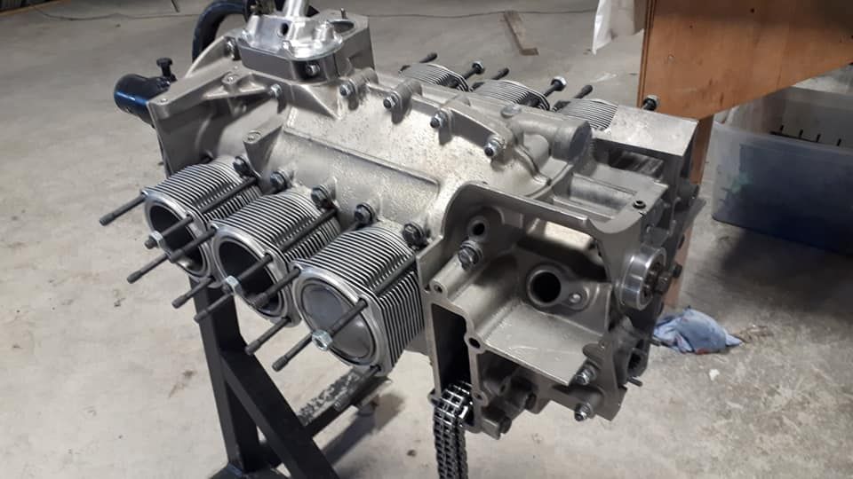

Well we got the engine cases back from the machine shop. They installed new oil squirters, removed the oil passage plugs and cleaned out the entire cases and machined new plugs. They also repaired the one oil passage hole that was corroded straight through.
Now the pistons and cylinders going back in,
Always check new parts, when we pulled the pistons out of the jugs ALL the ring gaps were in a straight line lol.
Even got some paint on the covers,

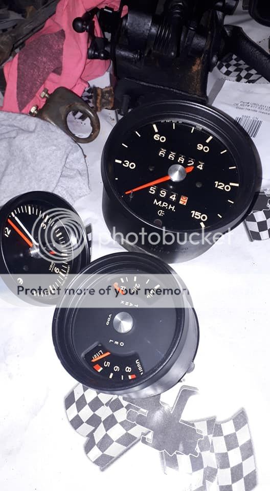

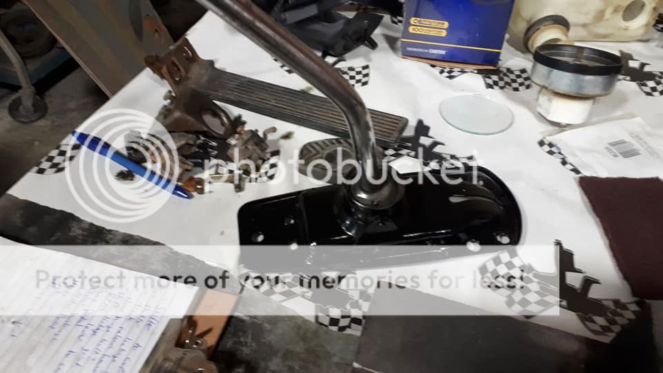

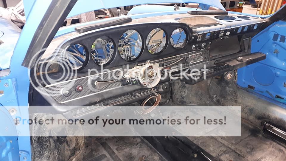

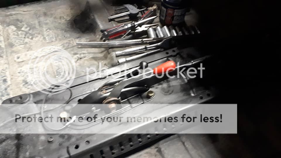

Got some more details done,
Took apart the gauges and detailed them, the outside bezels were corroded so now they are GTG!
L]
Yes even the clock works lol!
Cleaned up the pedals,
Shifter plate,
And the park brake assembly,
And we fixed the cracks in the dash pad,

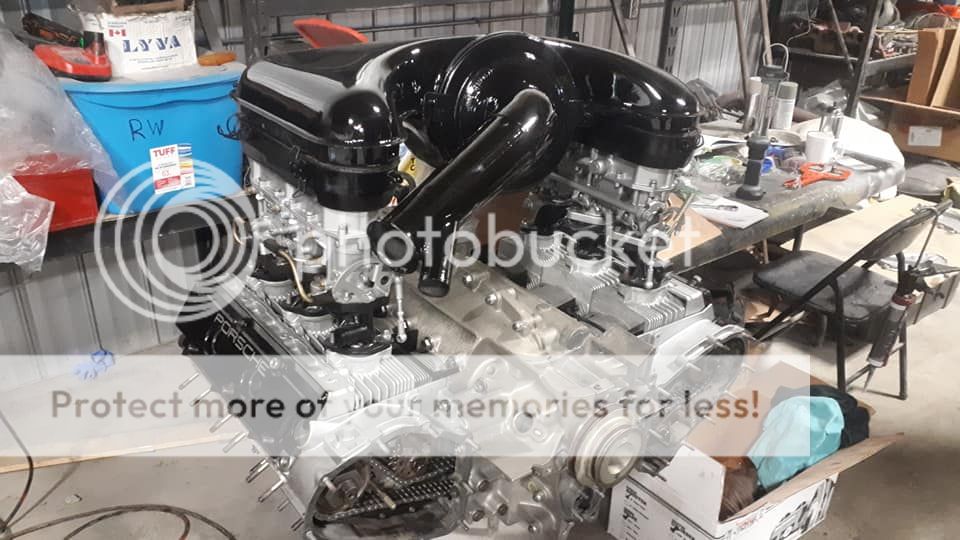

Well we got most of the engine back together, no issues

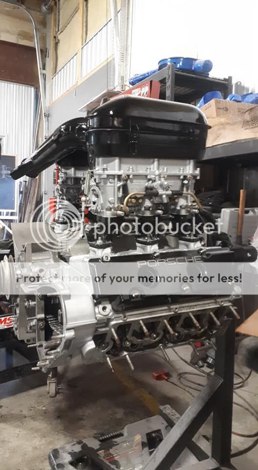

Well after a long time to get parts shipped we are back at the 911!
Getting a lot of fidly bits done like shifter and throttle rods in place before the engine goes back in.
Looking through the parts manual I'm having trouble finding out which fittings I need.
There are the ones for the two small oil lines here,
And what goes into this hole here beside the oil thermostat,
Thanks again for helping out this Porsche newb!
cheers

That is for the oil pressure sender. That is assuming you have the gauge for oil pressure , as some cars just had a warning light.

Awesome thanks, yes it has a gauge so I will order the sending unit for it.
