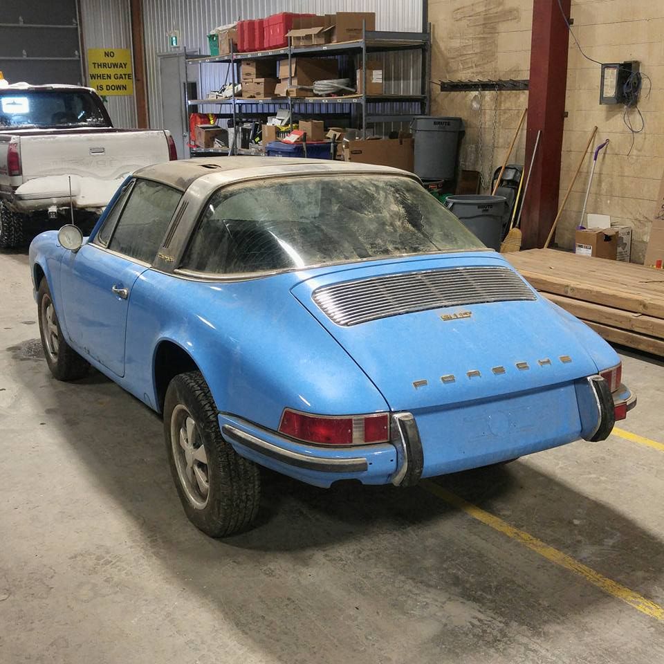

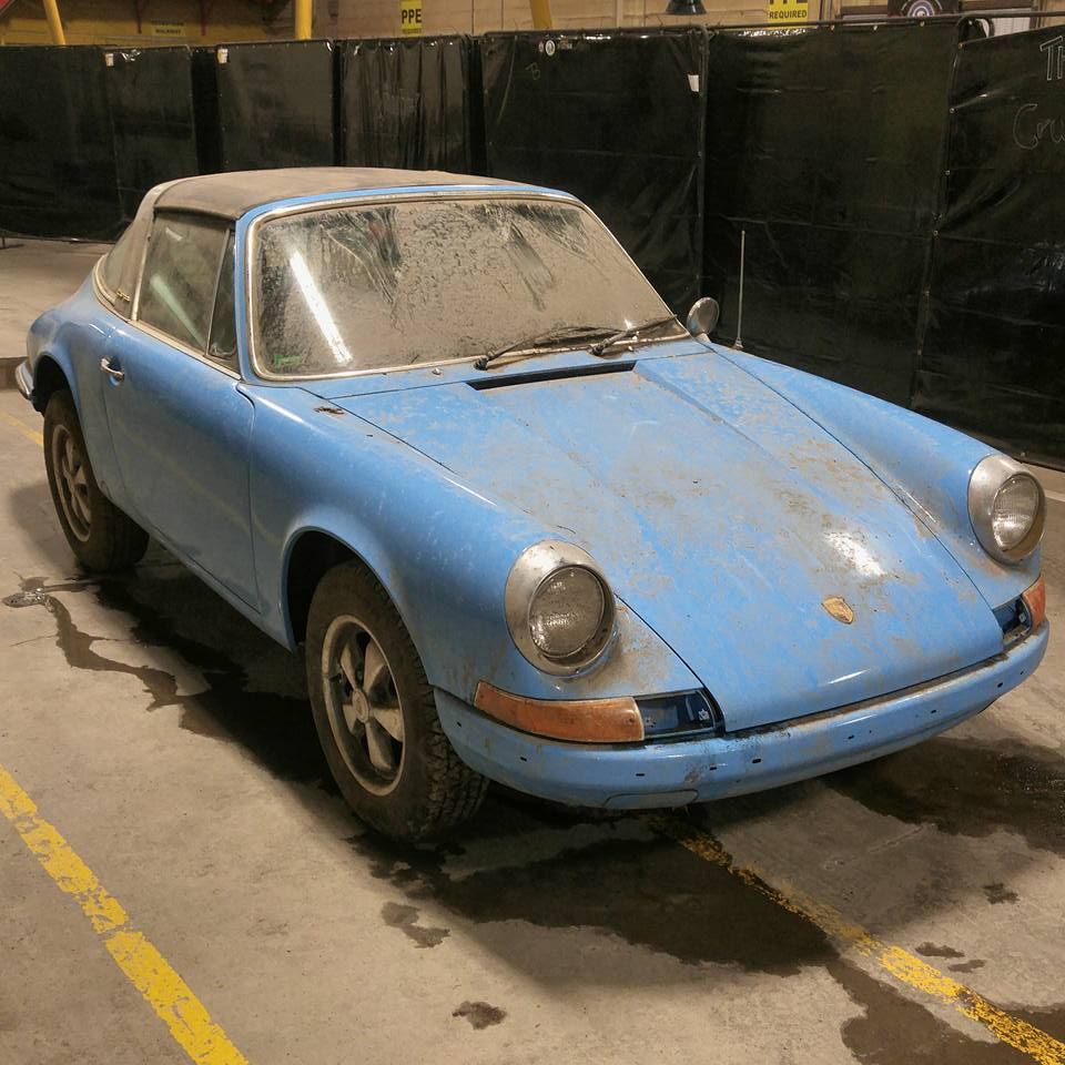

My name is Rick and I'm located in Southern Ontario, Canada. This is 1970 911 that I know nothing about but will be starting the restoration
As delivered to the shop,

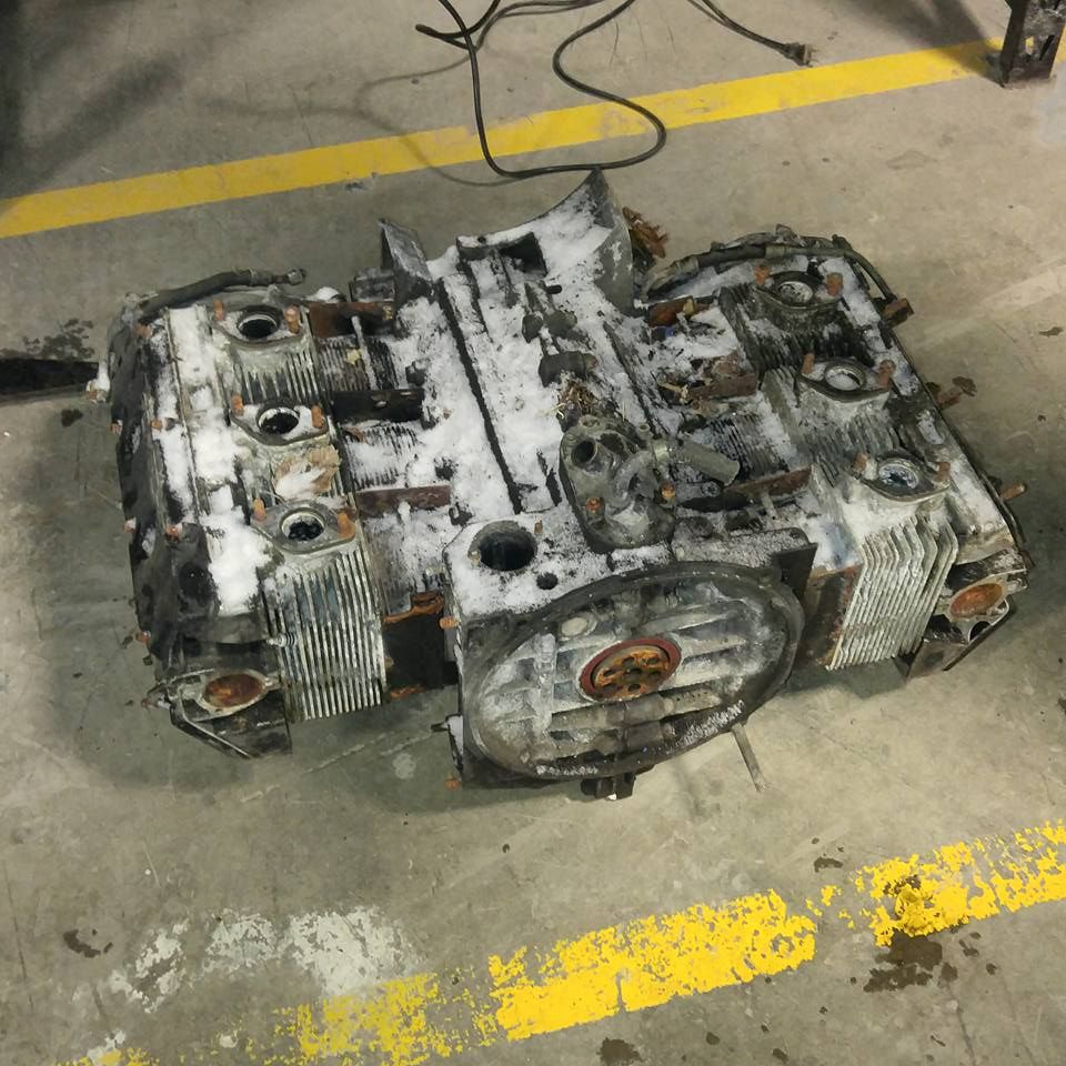

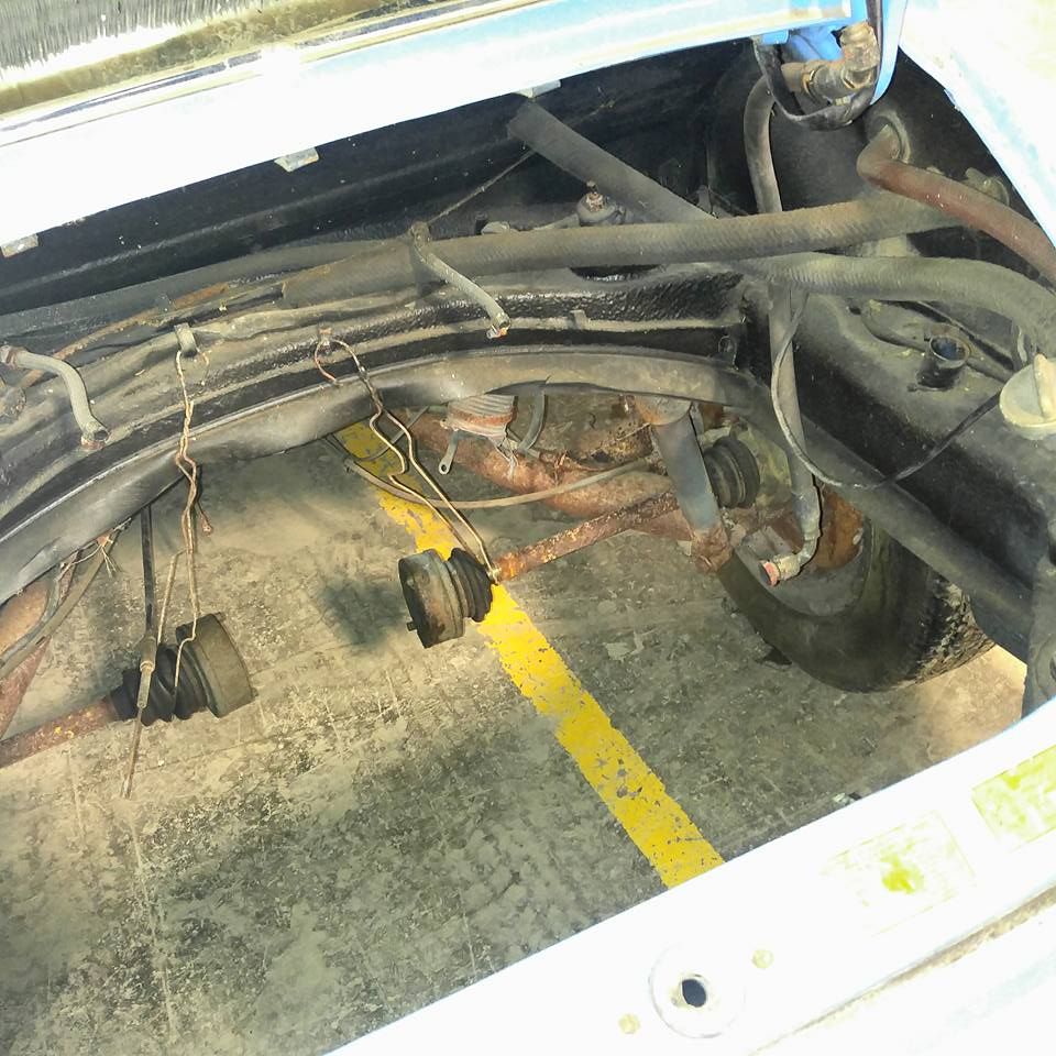

It had spent the last 34 years in a barn with serious engine issues. Not sure of the extent but we'll strip it down and figure it out.

It's been in a barn for the last 34 years due to an engine problem. I'm not sure if this was the replacement or rebuilt engine or the bad one lol.

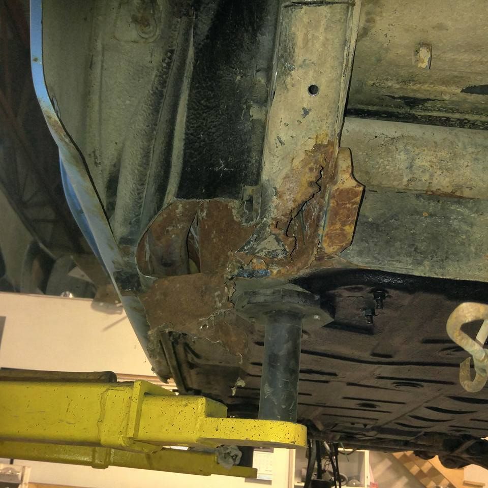

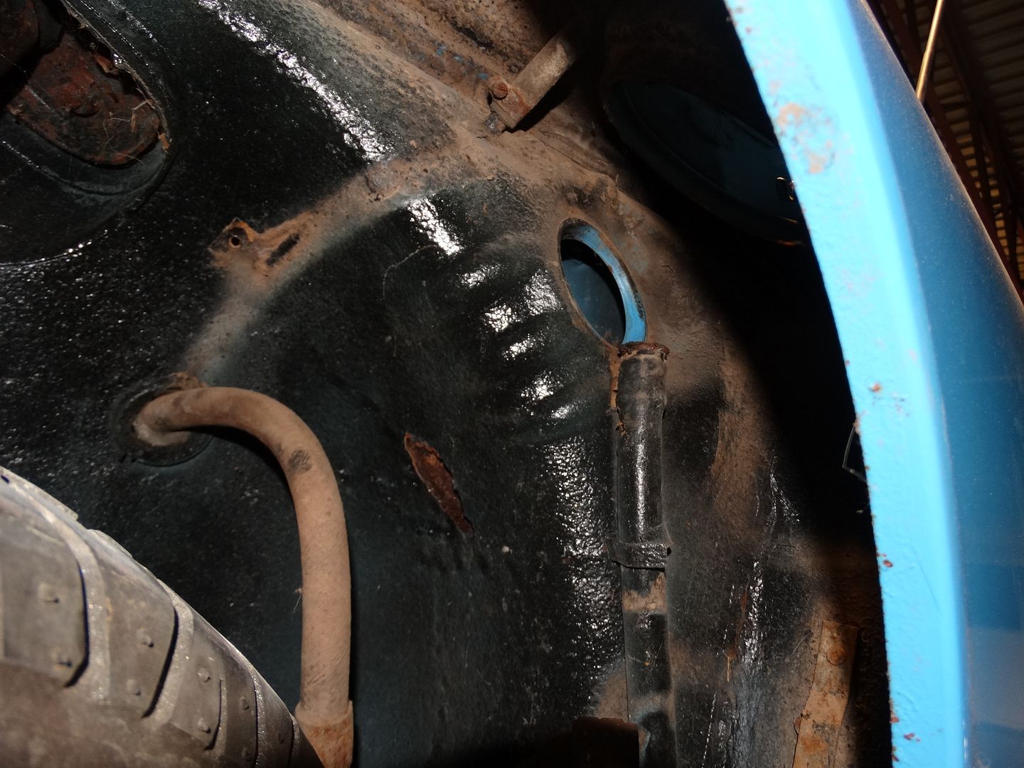

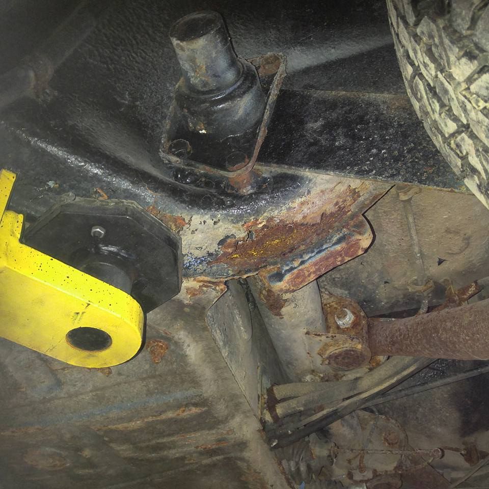

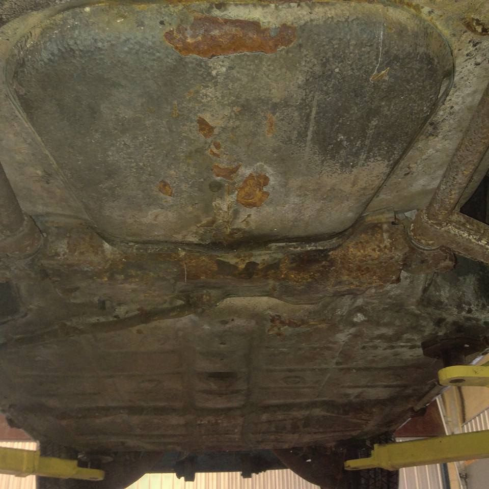

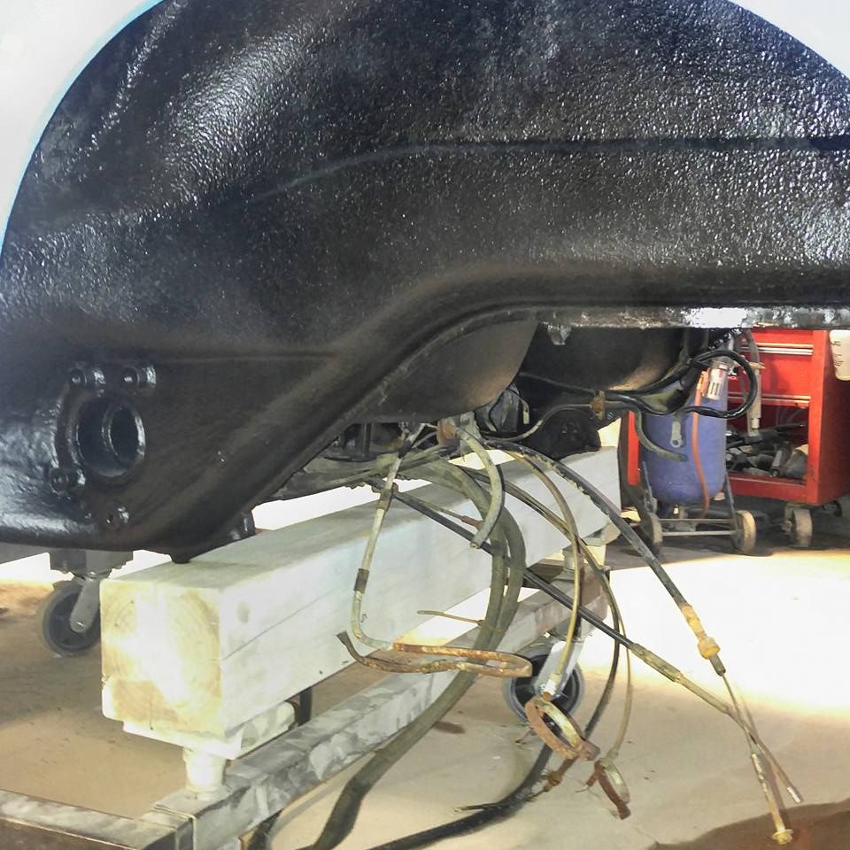

Well we got the car pretty much stripped and started on the structural welding. ALL of the rust issues in this car were due to mice nesting in the cavities.
Some rust under the left torsion bar mount,
Some surface rust on the floor pans but overall it's real solid,
Another spot was right behind the left front tire,
Removing all the rot and getting ready for the patch,
Luggage compartment had some surface rust as well, but it cleaned up real nice,

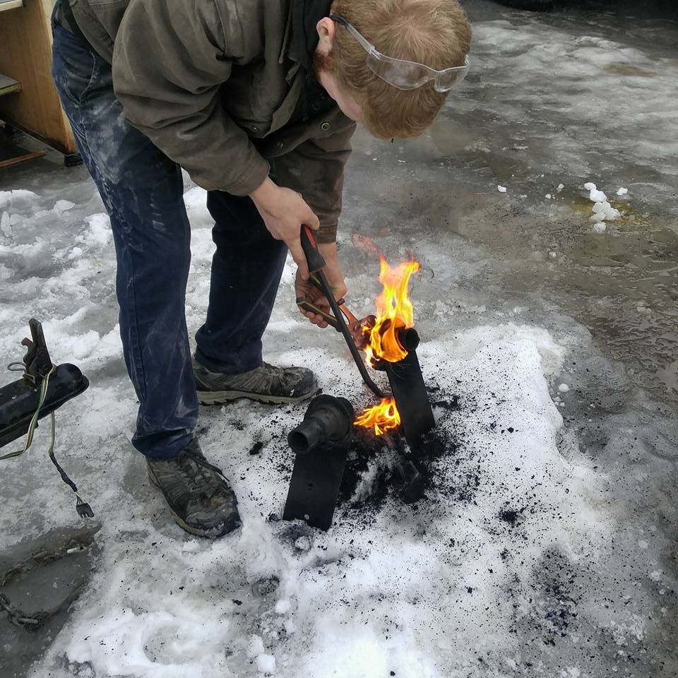

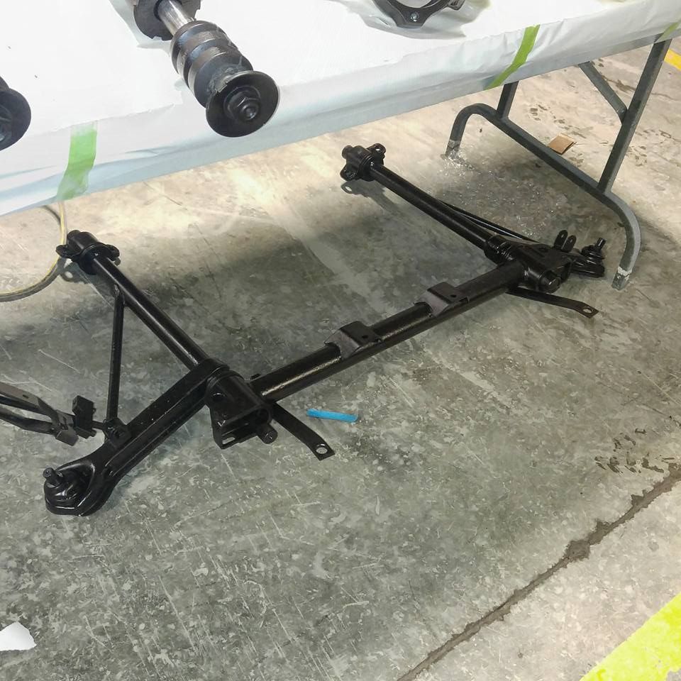

Started our day with a little cook out lol. Burning the rear bushings from the arms
More stuff added to the front compartment,
The whole underside is restored,
All the suspension parts were sand blasted and epoxied, going to install all new bushings,

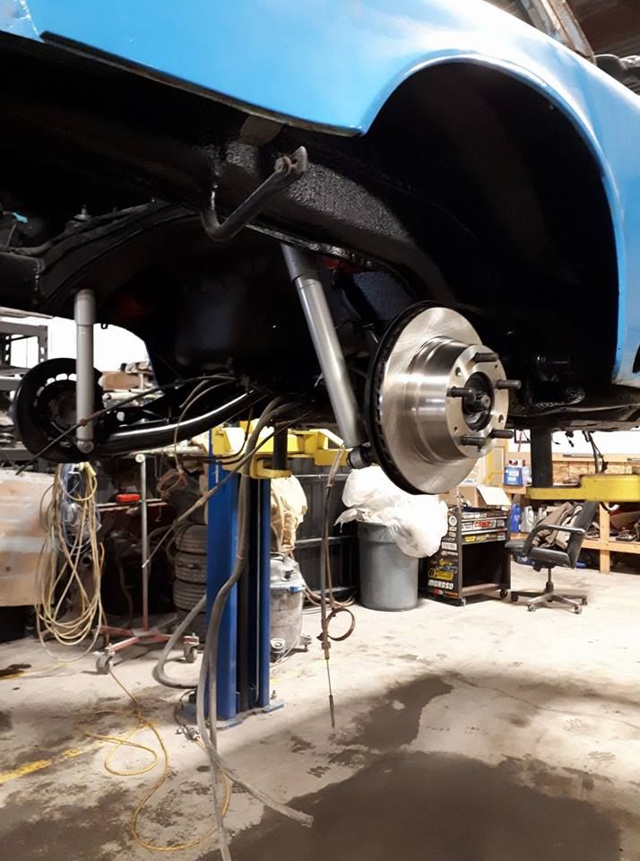

Let the games begin, starting to install all the suspension and brakes on the T.
