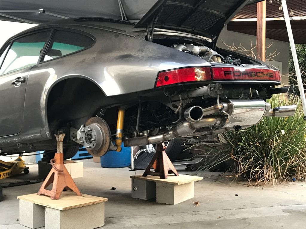

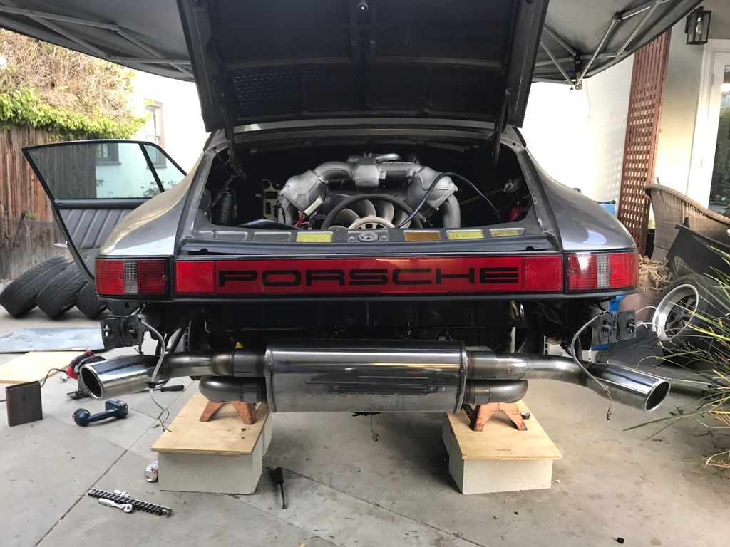

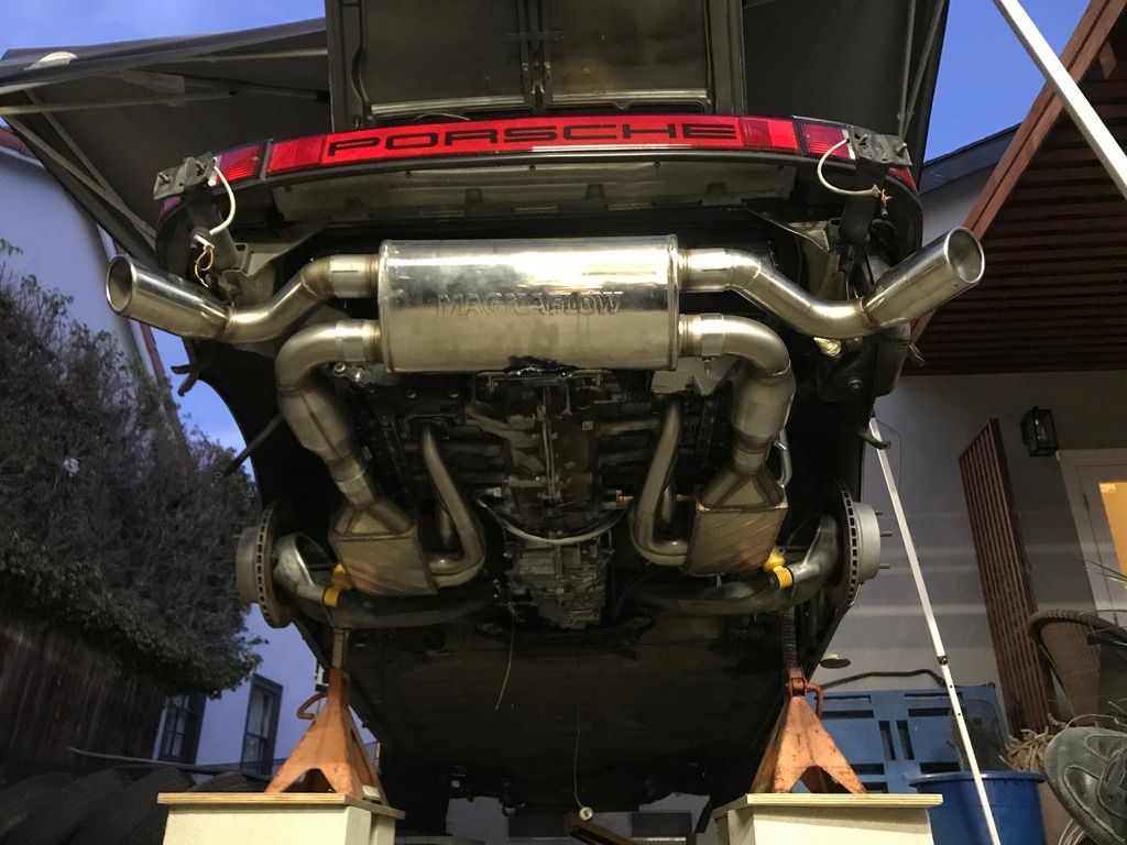

I'm in the middle of this very project with my 83 SC. Mine is a Euro car that already has the BAR sticker so they look very closely when it gets smogged.
I bought a 95 vario ram from Timmons. I just did a test fit yesterday and will probably be pulling it back out to weld in a Patrick rear shelf. It seems very tight against the fire wall.
With that said I made sure the motor serial number was a 95 manual transmission.
I had Timmons leave the AIS on it for the visual, but apparently the wire that runs the blower is used to run the Vario ram so if it doesn't pass that way I'll have to hook it up.
I also plan to have the light for the battery relabeled as a check engine light.
The exhaust is stainless headers with twin cats, but for the initial check I'll probably flip the studs and put on my SC exhaust. I heard from another user that this was what they did.
Toby
OB2 is apparently a nightmare so I would avoid it if you could.
here is a link to BAR engine change guidlines
https://www.bar.ca.gov/Industry/Engine_Change_Guidelines.html

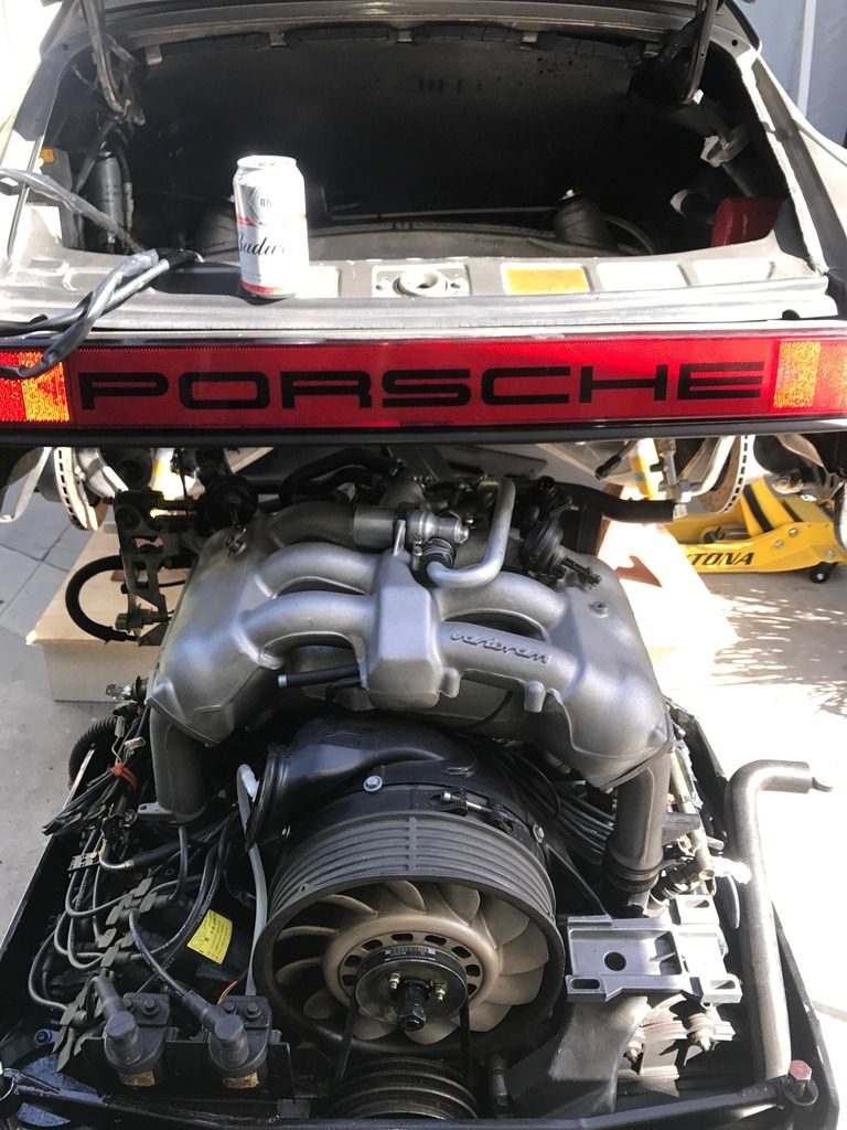

Originally Posted by uwanna View Post
the stock 964 airbox will fit in your car just fine. I put a 964 into my '80SC many years ago with the stock airbox with no problem. I am sure many others have as well.
EDIT: here's a pic of my 964 transplant into my '80SC with the stock airbox installed
'80SC Widebody 3.6 transplant Anthracite "The Rocket"

Originally Posted by Tremelune View Post
I face this very issue, as I just moved here with a '95 in my '84. uwanna, did you have to trim the top of the airbox to fit? I've been eyeballing mine and it seems certain to interfere with the hinge.
No modification at all, stock airbox fit just fine. I have since installed a
MAF system instead of the flapper box and gone to the cone type air filter though.
