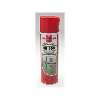

Nick get your self Wurth HHS 2000 for the spark plugs .I have been using it for over 30 years and it is really the best..you can use it on everything clutch omega spring, door latches, door hinges hood latches u name it ...

What ever you use DON'T use antisieze. Antisieze is electrically conductive, and can cause a plug to ground out if the antisieze gets on the electrode. We use a small amount of standard grease. Just a dab on the threads. Don't overdue it. I guess HHS2000 would work, but as a spray, it's a bit sloppy.
