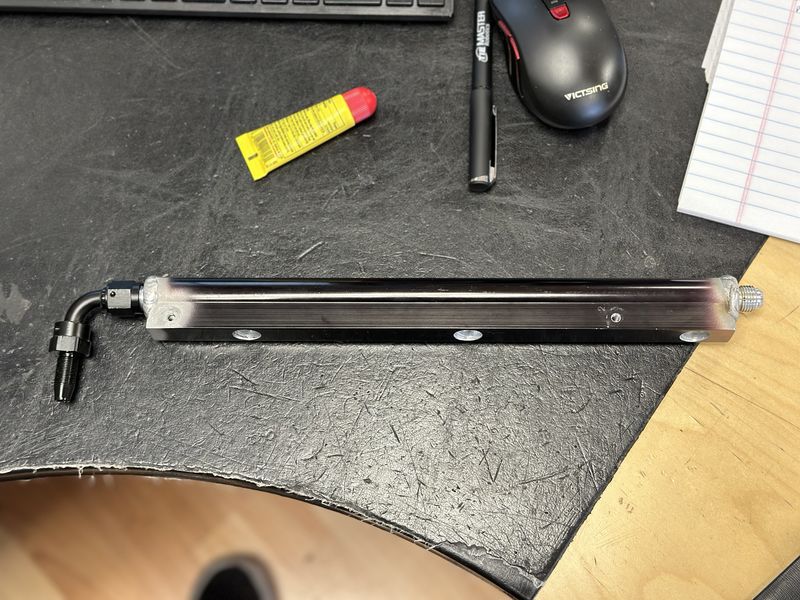

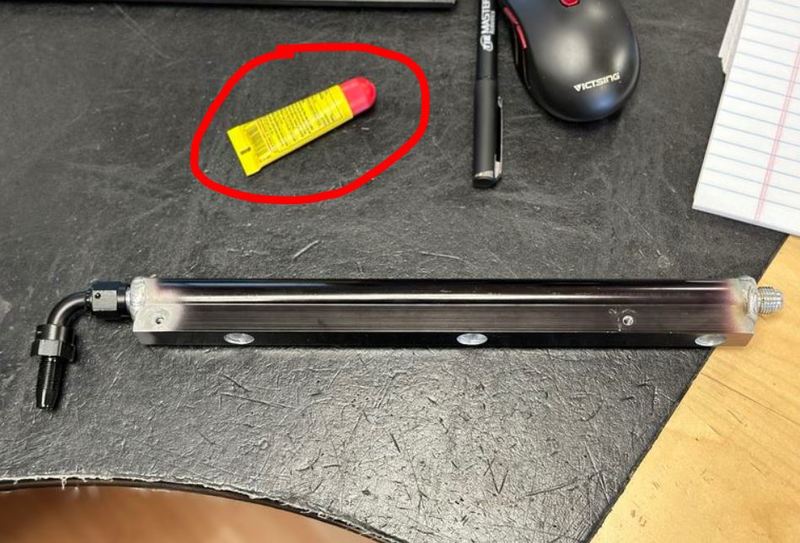

I brought the 911 to work (like I usually do). I was intending to pull it in and look it over quickly before the TOD trip Thursday. It smelled like gas again as I pulled it in the garage. It's done this a few times since I had the motor out over the winter and I looked a little more closely today. Found a fuel leak where the feed line meets the rail.
After several attempts to recondition the fitting on the rail, I called Earl's and confirmed they have the 'conical seals' in stock. So we drove over there and collected a handful. Sealed it right up and I have some spares in case any other fittings decide they hate me...and love BBQ.
