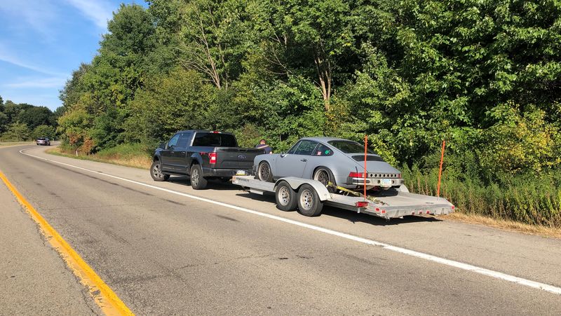

While I was ripping selfies (and pouring sweat), Joe was hitching to a trailer, leaving work many hours early, and heading west. Some six hours and twenty minutes later, this happened.
My hero!
Some five hours later, we parked the whole rig outside Joe's shop.

Let's see some glamour shots of the destruction.
We threw away some of the wrecked bearings and bits, but I kept some of the more notable pieces.
Here's the spread of most of the replaced pieces.
Wrecked needle bearings
Second gear carnage continued (when dog teeth meet meth and Mtn. Dew)
I think this was third?
Couplers that have lost that loving feeling
These bits were part of the second gear synchro assembly. Guess which one was jammed in between two gears...
I'm continuing to dial in the calibration and I'll be changing the trans oil this weekend.
I'm back to work tomorrow and will be driving the car as much as possible to continue to break in the diff and enjoy the heck out of this car.
That's all I've got for now. Good night.
