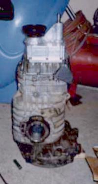

A bellhousing off of a bus 091 trans is what you want.
4 contact points (but you can use only two if if makes you feel beter)
full circle machined collar ( again, grind it in half to get it like the other ones)
Starter mount (just ignore it)
Toss the "L" shaped arms on your stand and bolt it to the flat part.
Usually two of the bellhousing holes will line up with the flat side of the engine stand plate. Drill two more then bolt the bellhousing directly to the flat plate of the engine stand.
Grind a hair off the inside bellhousing if needed to clear the flywheel
Price 0-$50
I paid $50 but that was with taxes and shipping. I would guess $10 at a junkyard or post a request on some VW sites.

Thats the 091 bellhousing (the dark bottom section)
