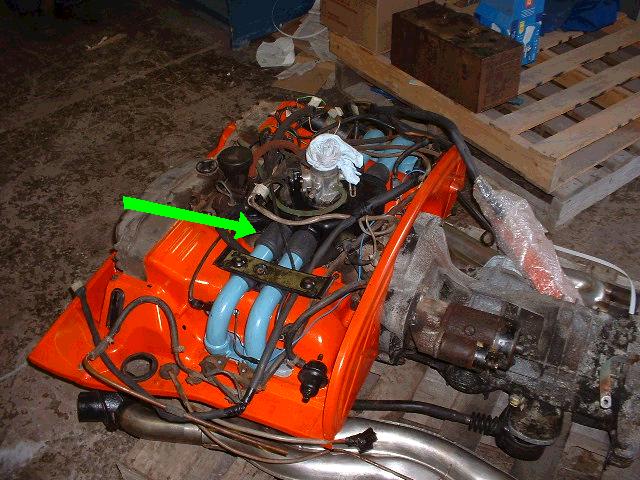

I just reinstalled the engine on my 2.0L 1973 914 after sending it out to have the heads freshend up and it now idles at 3,200. Playing with the timing only makes it go faster.
Did I get some hoses mixed up when I replaced them with new ones?
Did the engine shop get the distributor off by one cog?
Is something wrong with my cold start valve? AAR valve?
Thanks

Major vacuum leak most likely. Not cold start valve. Could be AAR, plug the hose to find out. Look at all vacuum hoses that connect BELOW the throttle body butterfly.

Also check your idle screw. Don't trust lines completely, make sure they don't have any pin prick holes.

Look for a large hose connected from "upstream" of the throttle body to the manifold, with no "component" in the middle. There should be no hose that makes this direct connection; if you find one you have found the source of your vacuum leak.
Also check for fittings on the manifold that do not have hoses attached to them.

It was the rubber hoses that hold the intake runners on the throttle body... they were sucking air!
I was concentrating my search on the vacuum hoses for the last couple of weeks and never even thought about checking these hoses until last night. I put a clamp on them and the idle settled down.
I might still have a problem with my cold start valve though as it seems to run better with it unplugged. I'll do some reading on this board and see what may be up with that next.

The new injector seals were OK. The old ones were so worn out that they change shape as Galto pointed out.
The problem was with the braided hose that connects the intake runners to the manifold.
I covered the braided hose with heat shrink to try and dress it up a bit. Maybe the heat shrink did something to it? So now it has eight ugly hose clamps holding it in place
I did have to ground out the head temperature sensor to get it to run right. It's only used in Solo II events so the day to day drivabilty isn't an issue but it does bring up another question though... Does bypassing the sensor affect performance?

geez, new manifold to plenum boots are cheap! You shouldn't have to cover them if they are new. Change them out and when you do center them somewhat so they seal.
grounding out the CHT means you are richen the mix to cover up your lean condition from the air leaks.
fix em before you burn a valve.

I reused the old plenum boots as they looked OK and covered them with heat shrink for what I thought was some extra protection. My next order with Pelican parts will probably include them.
The vacuum leaks are gone so that isn't a problem anymore.
What seems to be a totally unrelated problem was a miss under acceleration and some black and white smoke. So I had the injectors calibrated, set the fuel pressure at 32psi, and disconnected the cold start. When this didn't help I grounded out the sensor and it worked much better. Yes, cold start is hard ..but it is used only for competition.
My understanding was that (besides telling the cold start valve what to do) the temperature sensor richen's the mixture to the injectors and grounding it out would stop it from doing this. Am I wrong on this?

Shorting out the HTS makes the EFI run as if the engine were very hot--full lean! You richened up the mixture by running the fuel pressure up to 32 PSI, and leaned it out some by grounding the HTS. The car will likely run like crappola until the engine is fully warmed up, ~5-10 minutes.
Try dropping the fuel pressure to the spec of 29 PSI (2 Bar even, if you've got metric gauges), and see if hooking up the HTS will let the car run right.
Unplugging the HTS (not shorting it to ground) makes the mixture very rich.
