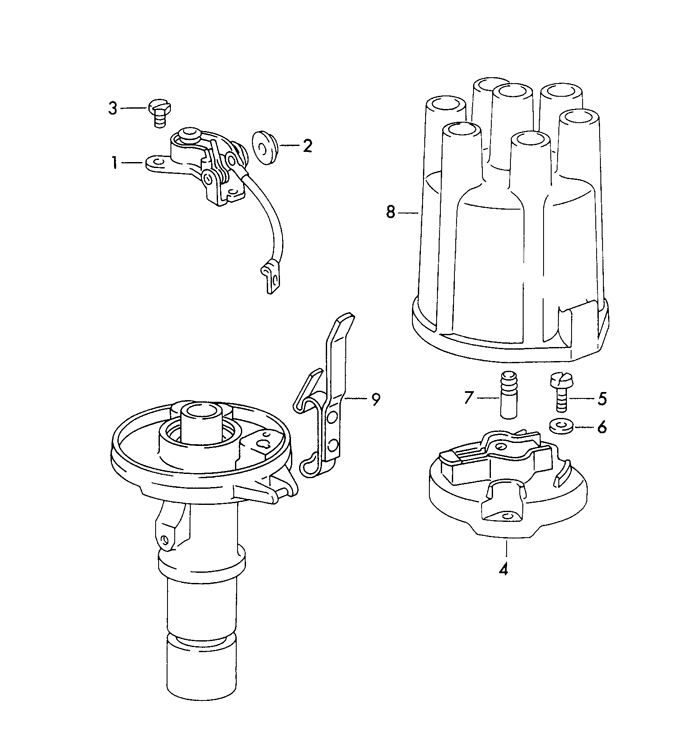

The car has a Marelli distributor of this type:
It has new contacts, distributor cap, spark plug wires, spark plugs etc.
