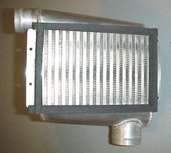

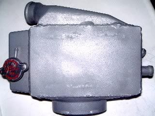

Alrighty - in response to my latest toy thread I got questions about doing a bolt on 937 style intercooler as well as general intercooler.
I see these considerations:
AIR TO WATER - TOP MOUNT
AIR TO WATER - NOSE MOUNT - 951 STYLE ONLY WATER INSTEAD OF AIR
AIR TO AIR - TOP MOUNT CGT/937 STYLE - REQUIRES A HOLE IN THE HOOD
AIR TO AIR FRONT MOUNT
AIR TO AIR NOSE MOUNT - 951 STYLE
AIR TO WATER BARREL STYLE
Now I like air to water - but it adds complexity
  • lots of parts and plumbing
    Tank
    Pump
    Small Radiator
    No hole in hood for top mount
Top mount A2A - limited in size
  • Hole in the hood
    Seals
    Hood Scoop
    May not be for everyone
Nose mount requires almost as much plumbing as front mount
  • Also limited on size
    Of course requires the nose be removed so you can install IC
    Can open area up for larger unit
    Removing Nose and/or Mods for larger IC lot of work for the end user
    I can see a kit with hardware to facilitate reinstall of nose or even fiberglass or carbon fiber replacement
Front Mount - requires longest runs of intake pipes
  • Can cause heat issues with radiator
    Would require 2 fans on radiator - 6 fin - 951 style or aftermarket
    Unit would need to be flush mounted to radiator or AC core.
Barrel Style - can be installed in line with pipes - but still A2W
  • Requires same stuff as other Air to water
    Smaller profile
    Easy to install in line - like installing any hard pipe
    Can use more than one - but can be expensive

TOP MOUNT
The Air to Water units remain my favorite.
Of course I could offer a thousand choices, but I wonder about the cost and how many people are really going to buy one.
The best solutions seem to be the ones that require the least amount of pipes - front mount does require considerable pipes.

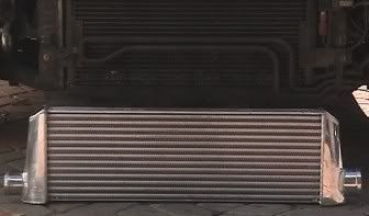

Of course a front mount is easy and would be more universal
Measurements for a Front Mount Intercooler dimensions show to fit in front area -(without modification):
Max Length is 20”
Max Height is 14”
Max Depth/Core thickness 3”
Fitting unit in front of Radiator and inside standard space.
Of course something like the Fiberwerks Front end would allow more room and better air flow.

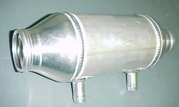

I love that barrel, just love it - anyone else with me on this?
Air to Water Oh Yea!

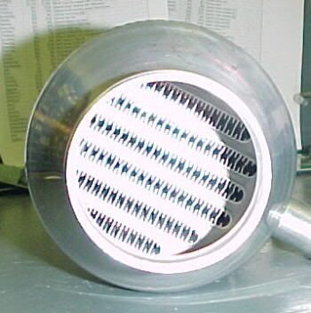

Barrel styles come in various diameters and lengths, we carry all of them. But I like them for the coolness and performance, talk about easy of installation. 4", 6" or 8" diameters and various lengths, I have used two units before - although not in a porsche.
Can use water or other solutions... very efficient, I have even boosted cooling with CO2.

Barrels cool, but its a very large air restriction, I say front mount air to air
1986 951, Stock for now.
]87 924S Gaurds red- SOLD after 11 years of ownership
Old 03-16-2006, 02:15 PM
winter-hater club member
nynor's Avatar
Posts: 24,705
i doubt that baby is any more constrictive. plus, you can make it pretty big.
"COOL PRIUS!" - Nobody Ever
Old 03-16-2006, 03:13 PM
x3m944's Avatar
Location: Orlando, Fl
Posts: 328
Well the data doesnt show it to be any more restrictive:
4" x 6" (11.75" Length) 270 HP 390 CFM
4" x 8" (13.75" Length) 290 HP 390 CFM
4" x 10" (15.75" Length) 300 HP 390 CFM
6" x 8" (17" Length) 600 HP 920 CFM
6" x 10" (19" Length) 650 HP 920 CFM
Pressure Drop @ 7PSI, 1.1 PSI Drop
All 6" Barrels Are 3" In/Out, 3/4 Push On Hose Fittings
All 4" Barrels Are 2.25" In/Out, 3/4 Push On Hose Fittings
A Barrel Kits Includes:
.......- Electric Water Pump with 3/4" Barbed Fittings
.......- Small Radiator:
.......- 4" Kits: (L=11.5" W=10" H=1.5") with 9" Fan
.......- 6" Kits: (L=13" W=12" H=1.5") with 10" Fan
.......- Billet Inline Filler with Cap
Temperature Drop From In to Out - Can Range From 45% - 100%
