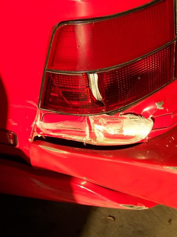

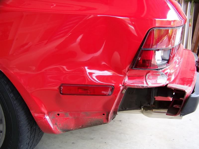

Freak accident, going around a turn at a safe speed and encountered slight over steer upon correcting I over braked and hit loose gravel causing a spin. My passenger and I are fine luckily the impact was about 15mph. I thank god there was a guardrail other wise I probably wouldn't be typing this right now.
What happen is very similar to this thread...
http://forums.rennlist.com/rennforums/showthread.php?t=412201
I say the cause is wheel bearings. I've heard them making noise in the past but for the last few months they've been quiet.

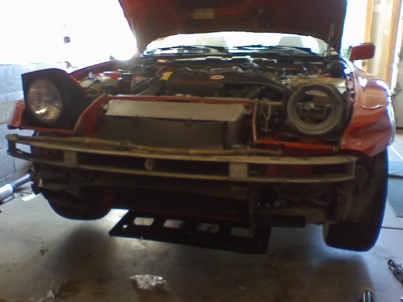

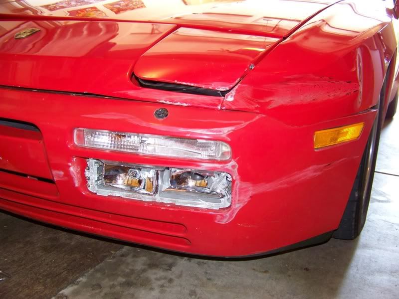

Visually the quarter panel looks worse but after I had a bodyshop look over the car they pointed out that the front of the car has the worst damage and it needs to be placed on the frame machine. No I'm faced with the decision to either have it repair (I'll source parts), get a whole parts car (one fs locally), or review my insurance policy. :crying:

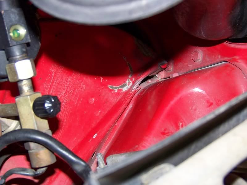

Sorry to hear about your incident, although I wonder what the definition of "safe speed" is here
Front looks like it could be messed up for sure, especially in that picture of the engine compartment. Hope you get it all sorted out soon.
I would check with your local PCA region on getting some comparable valuations so that you have something to fight your insurance company with.

The good news is my old 924S was banged up ALOT worse than that, and it straightened out really well. The photo of the hood mis-alignment isn't too bad, what happens is, the two main box "frame" pieces that extend forward of the wheel wells shift to one side or the other from impact. They can be straightened without too much work.
Since the Insurance co. totaled my 24S, I ended up straightening it with chains and come-a-longs, of course it became a track car after that.
