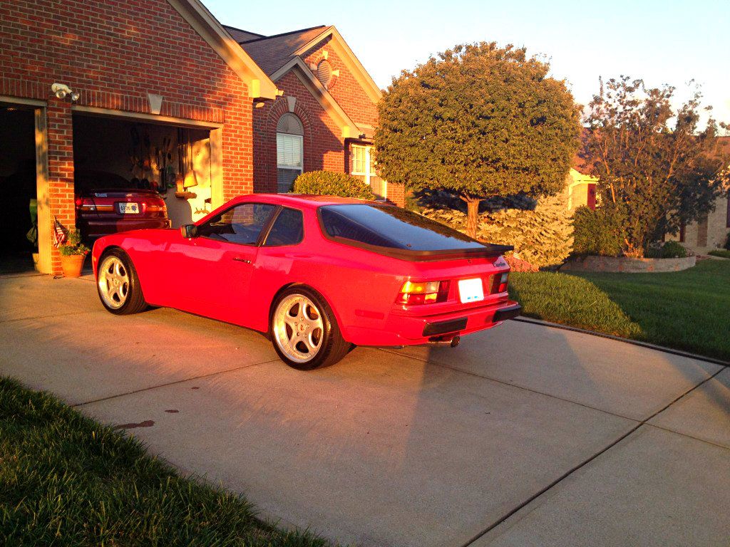

james6speed's Avatar
Join Date: Jul 2012
Posts: 131
Sun was hitting it, so took some shots.
... that is some badass looking pipe you got there
