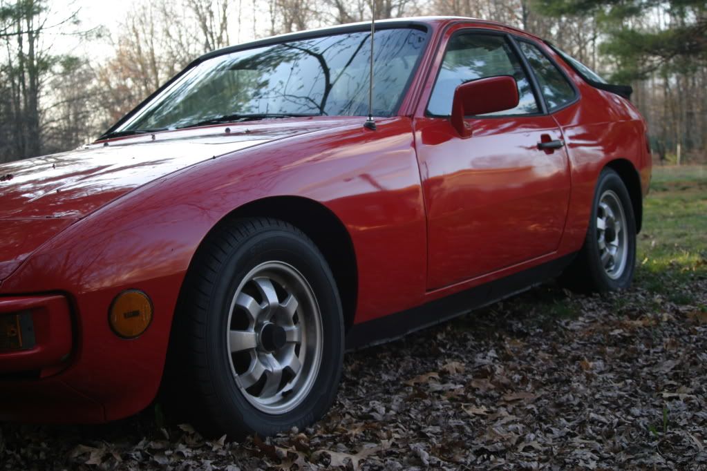

But recently acquired this...924 5speed 1982
[IMG][/IMG]
And the motor has a huge hesitation. I tried the usual stuff, plugs, wires, fuel filter etc...and still no joy. Starts instantly has 150k on it the guy I bought it from said the motor was rebuilt 5k ago. No rust and pretty darn clean for an 82. Open to suggestions and stuff to check from experienced porsche guys...

i seem to recall that the AFM on the 924's can get sticky and/or out of adjustment. there is a flap, for lack of the proper term, that more or less 'floats' and changes position relative to air flow. if you've tried everything else, you can try looking there.
first, i would verify proper positioning of the timing belt and the timing advance. its been a long time since i worked on one of these, but that is where i would start.
