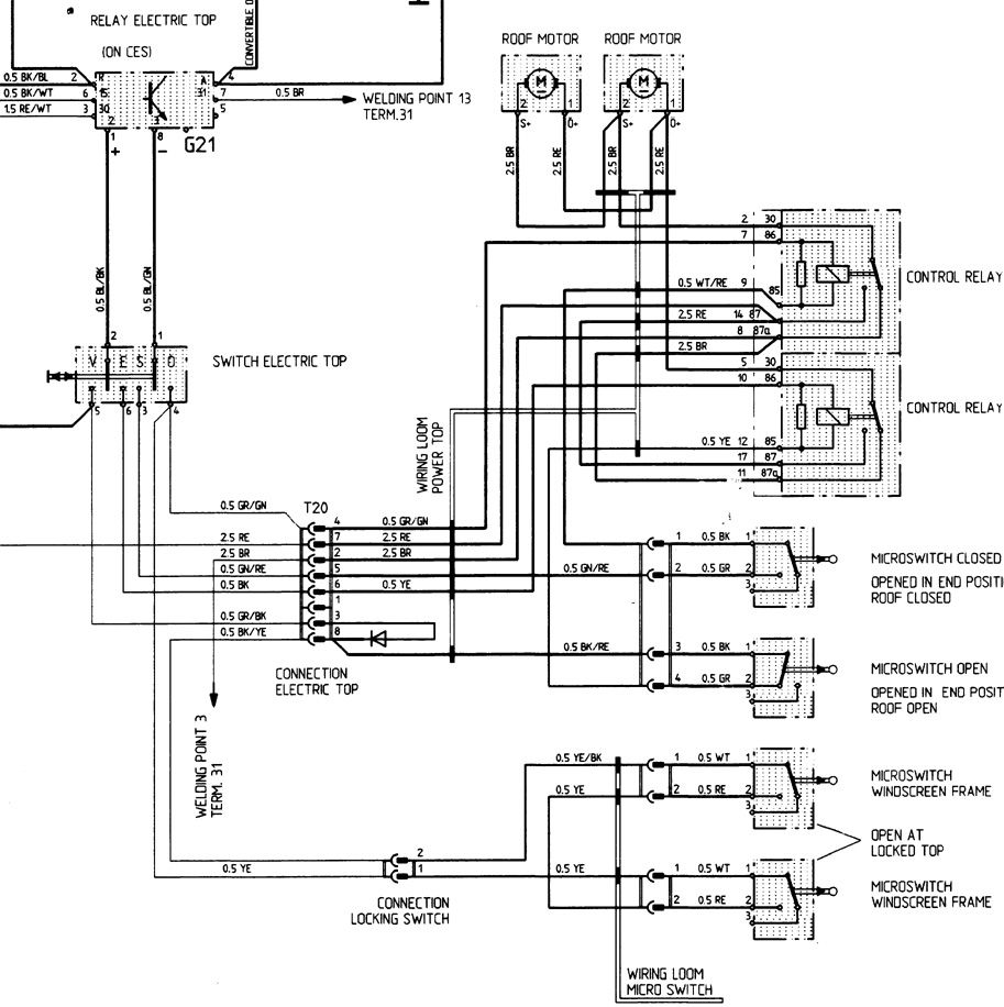

I have a 91' 944 Cab. After a lengthy engine rebuild and then body and paint work the car is back on the road. My convertible top functioned correctly before the extended parking, however now when I hit the switch I get nothing. Does anyone know the best way to proceed with the diagnosis? I don’t have an owner’s manual. Does anyone know which fuse and relay send power to the top motor? Any help appreciated. Top down weather came early this year.

I would start by checking fuse #1, then pull out relay G21 and put it back in, then swap the relays in the upper right corner of the trunk under the carpet. After that you'll need a volt/ohm meter. Probably not the microswitches unless you've messed with em.

My top works great... One thing I have noticed is... there are two tiny contacts inside the alignment holes. If these are rusted or not making good contact the top motor will not run. Try unlocking the top putting making sure the brake is on and then gently pop the top up and off of the locking pins... now try again.
