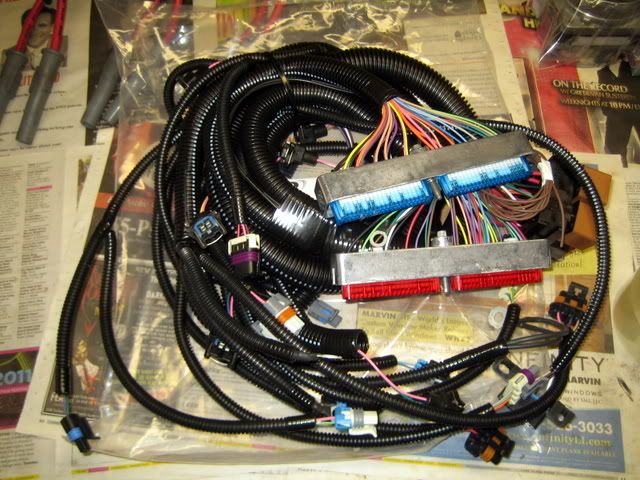

You have a few options for the wiring.. The engine harness for the most part out of whatever donor car is standalone, meaning it can only needs a few wires hooked up to work. The work however lies in removing wiring that is not applicable to the 944...etc. Something else to take into consideration is the routing of the harness. For example, the f-body (Camaro, Firebird..etc) engine harness routes to the passenger side of the engine bay. The GTO harness i got routed to the drivers side. I wanted to route the LS engine harness the same as the original harness and mount the PCM into the passenger footwell just like it was originally with the DME. The GTO harness also has wiring for the body control module as part of the engine harness (F-body does not have this).. so rather than spend hours reading the wiring diagram and cutting out wiring..and still having to deal with harness routing, i decided to buy a new, standalone engine harness specifically meant for conversion cars. This harness is really nice in that it has an auxiliary fuse block already wired in, so it saves you the trouble of doing it yourself. I ended up selling the GTO harness for half the cost of the standalone harness.. so for me i thought it was a no brainer almost.
All gauges will work as they did before. The tach literally needs one wire connected to the engine harness. The oil pressure gauge will need new wires routed, aswell as the water temp gauge. All pretty simple to do.
Brand spanking new engine harness.. no more 25 year old wiring!

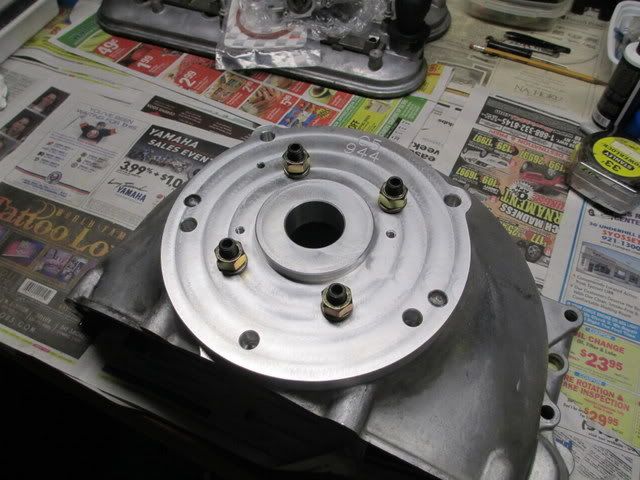

Happy i cleaned off my work bench the other day because i got a ton of stuff today. Here are some pics of the notable items..
Here is the bell housing adapter on the C5 bell housing..
http://img.photobucket.com/albums/v1...p/IMG_0068.jpg

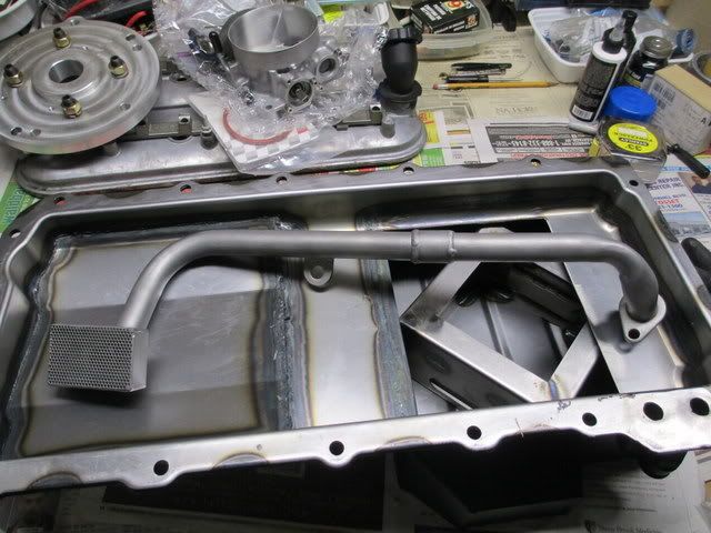

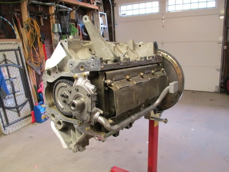

Oil pan and pickup tube
http://img.photobucket.com/albums/v1...p/IMG_0065.jpg

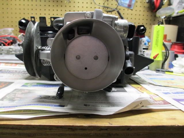

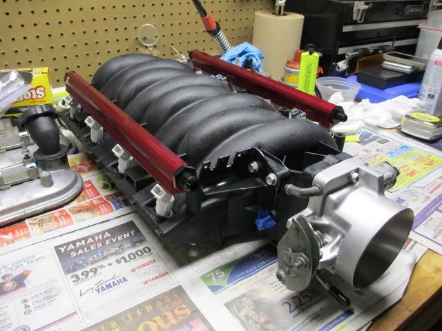

Not much else done today other than setting up the ported throttle body and fuel rails / injectors on the intake.
http://img.photobucket.com/albums/v1...p/IMG_0072.jpg
http://img.photobucket.com/albums/v1...p/IMG_0074.jpg

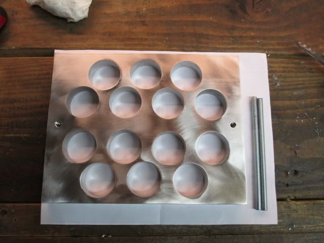

Techno Duck 05-06-2012 04:45 PM

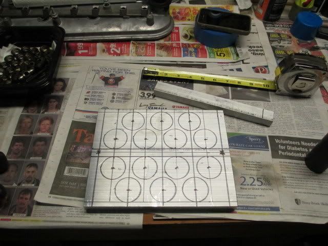

Mostly finished with my battery hold down bracket. It took about 3x longer and i was originally going to bring it to a machine shop to have done, but i figured it would be a fun project.
The dimensions do not really need to be exact, so i sort of eye balled everything and laid it all out with a tape measure. So not everything is exactly evenly spaced.. :). Anyhow using a 1.5" hole saw with my friends cheap Harbor Freight drill press to go through a 3/4" thick aluminum plate takes alot longer than you would think, then multiply that by 16 :D. If only Harbor Freight sold a cheap waterjet.. :D.
http://img.photobucket.com/albums/v1...o/IMG_0083.jpg
The material i used was a 3/4" thick, 8x11" plate of 6061 aluminum and a 5/16th -18 threaded rod. Total material cost was about $50. I cut the plate to approximately 9x7" and drilled the holes for the threaded rod centerline, about 8" apart. Tap the holes for the 5/16th rod and also cut the rod down to size. Then using red Loctite, i threaded the rods in so they stay put. I also used a 1.5" hole saw to 'swiss cheese' the bracket and lighten it up. The bracket is still a bit on the heavy side (i estimate about 2-3lbs). Will probably drop it off at the machine shop when i bring in my heads and have them mill down the center about .5". That will probably cut the weight another 30%.

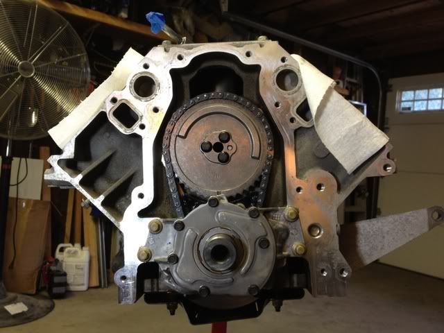

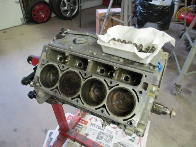

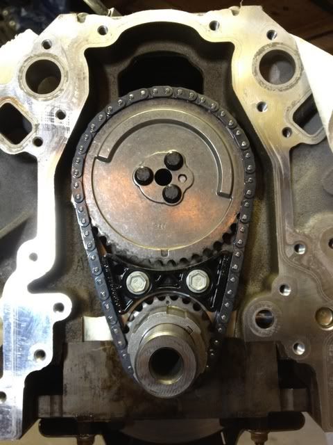

Here are a few pictures from the motor build,
Front end stripped down..
http://img.photobucket.com/albums/v1...p/IMG_0121.jpg
http://img.photobucket.com/albums/v1...p/IMG_0122.jpg

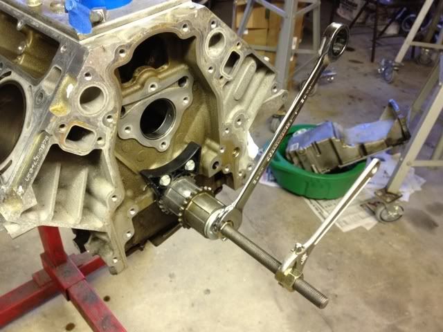

The only 'special' tool needed so far, a piece of threaded rod to press on the new cam sprocket, also needed to press on the crank damper.
http://img.photobucket.com/albums/v1...ingset-001.jpg
New timing set, EPS cam and LS2 chain damper installed
http://img.photobucket.com/albums/v1...G_0895-001.jpg

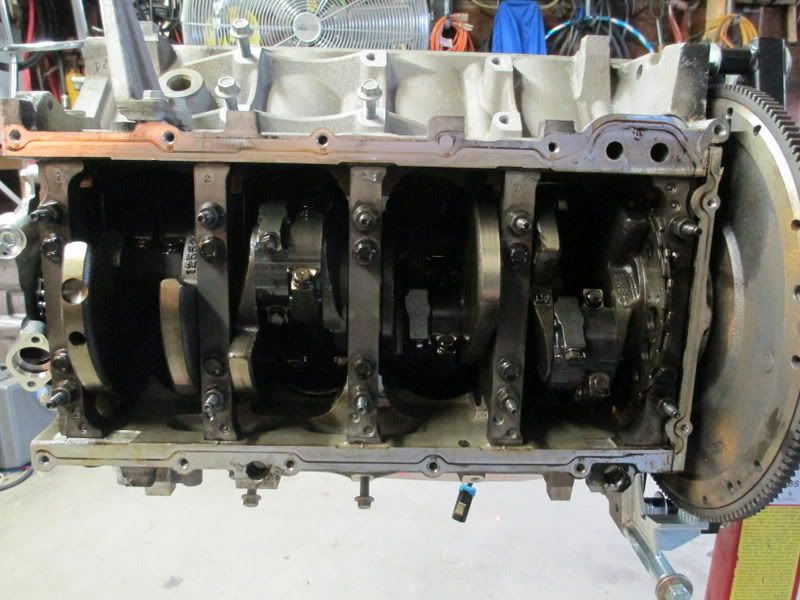

and with the Katech blue printed oil pump.
http://img.photobucket.com/albums/v1...G_0896-001.jpg
4-bolt main
http://img.photobucket.com/albums/v1...G_0133-001.jpg

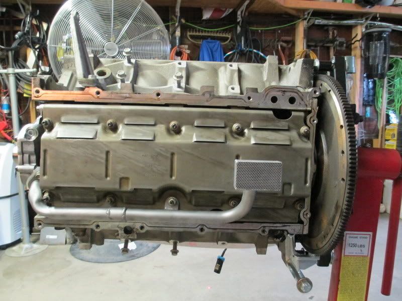

I fitted the new pickup tube also before i left, required some very minor trimming of the windage tray, basically 30 seconds with a buzz saw.
http://img.photobucket.com/albums/v1...G_0134-001.jpg
http://img.photobucket.com/albums/v1...G_0135-001.jpg

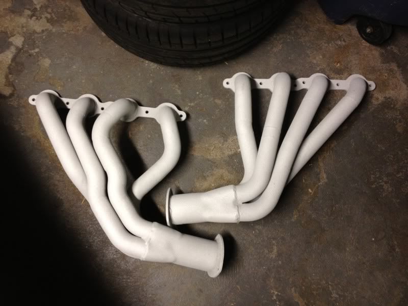

Long tube headers coated by SwainTech
http://img.photobucket.com/albums/v1...derscoated.jpg
Overall it was a welcome change how simple this engine is to work on. Timing set took only a few minutes to setup.. no crazy tools, anticipating the cam / crank rolling..etc.
