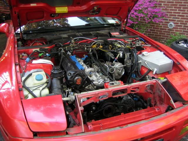

This is how things looked many moons ago..
And how it looked a week or two before i pulled the engine..

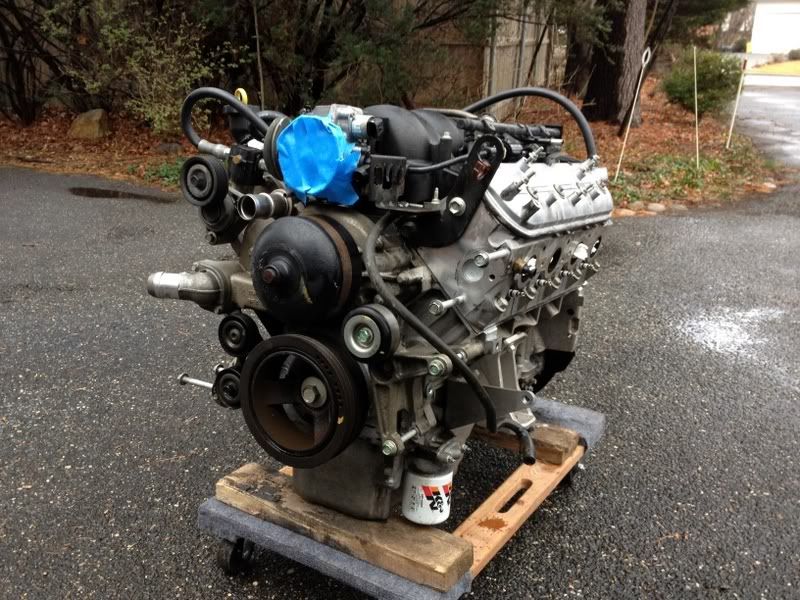

After nearly 6 weeks of being in the Gulf of Mex. i got back about two weeks ago ready to dive in. During my time away, i had compiled a list of everything on the car i wouldn't need anymore and could sell to help fund the LS swap. I was lucky when a local track buddy of mine had committed to buying the engine out of my car after he learned of what i was doing through the local PCA. His fathers 951 track car engine had finally given up last season after nearly 180k+ miles of hard use. This car was basically bone stock, so like i said.. stock vs modified is no comparison in terms of reliability! I took off all the aftermarket parts and under all that, was basically a fully rebuilt long block with brand new everything on it. So things worked out well.
This was perfect for me though as delivery of the engine would be easy considering he lives only about 15 minutes away. With the long block sold, it would just be all the bolt on parts that needed to be sold.

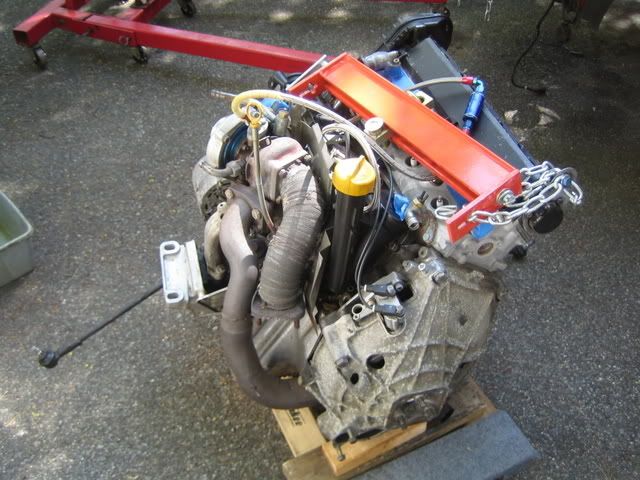

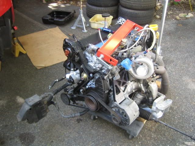

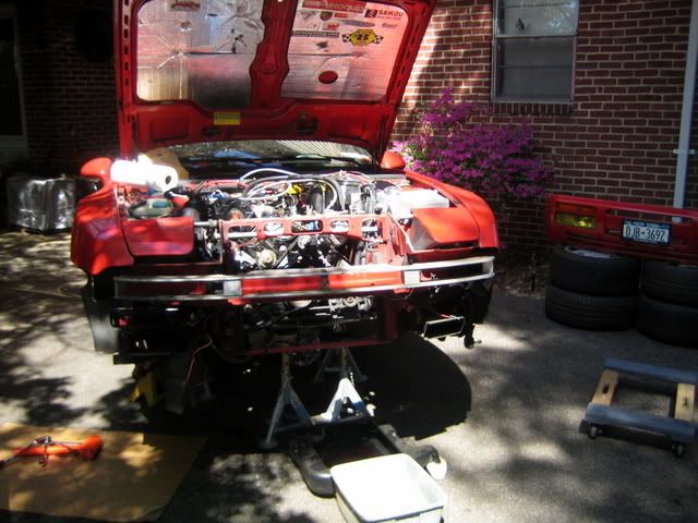

I started working on removing the engine last week. I went sort of the roundabout way on things and had removed the intake manifold so i could disconnect the engine harness off the long block.
Here is how things progressed working on it about 2hrs a day.

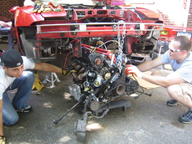

And finally on saturday morning the engine was basically ready to go come out. It was like an omen with the sun shining into the engine bay!
The only hangup on engine removal was the steering input shaft on the steering rack. I lost the small chisel i use to spread the pinch open. I was hoping by lowering the engine it would slide out but even after lowering the engine it was stuck on. Some light pressure with a pry bar freed it up and the engine basically came out without much fuss.
The plan was to lower the engine onto a dolly, then pickup the front end of the car with the engine hoist and roll the engine right out the front. I had removed the radiator and lower radiator support frame (really easy, 4 allen head bolts) which allows the engine to literally fit right through the radiator frame. This allows you to slide the engine out without having to pick the front end up another 5" about. Had some friends help support the engine on the dolly while i pulled it out from the front.
I lost track of time, but it only took about 10hrs to take out doing it the long way. I think realistically it can be done in 4-5hrs if you know what your doing.
The engine was on the dolly all of two hours or so before my friend came and picked it up. Was happy to get it out of the way quickly as i am running out of space quickly from taking apart two different engines.

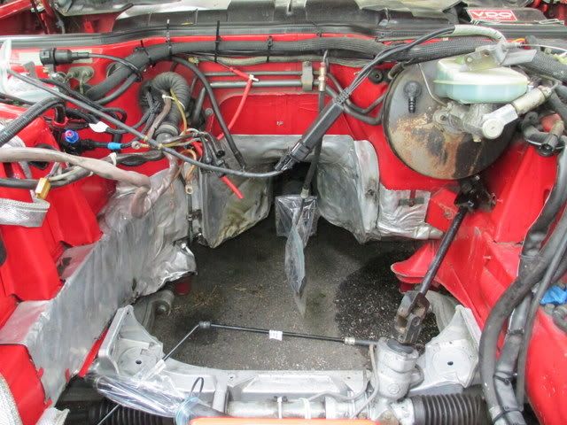

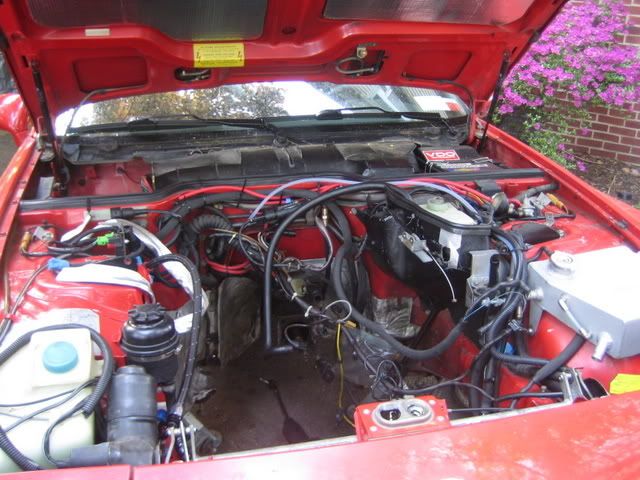

And the car is now engineless..
I spent the last week or so basically shipping parts out. The parts from my turbo setup now reside in a few different states as far as Hawaii. I still have a few things to sell off but for the most part about i would say 3/4 of the stuff is gone already.

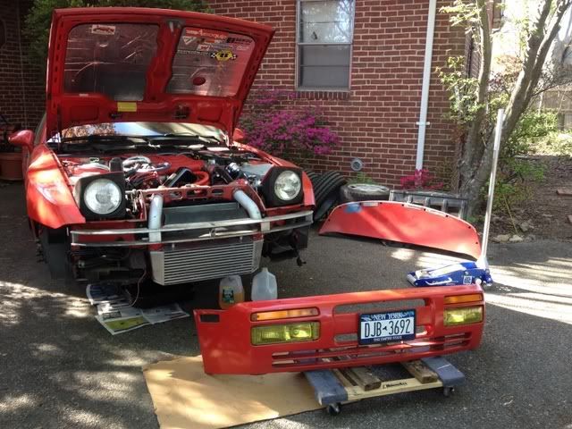

Started cleaning the engine bay a few days ago, only made one pass so far but will probably do atleast one more before i consider it checked off the list. This is where my OCD really kicks in, i like a spotless engine bay.
Put the front suspension back on yesterday and after about a week on jackstands it was nice to get it back on the wheels again.
Been saying it for days now but today i will finally put the DME/KLR and rest of the engine harness out of the car.
Also will make a post with some more details about the actual LS1 build and my plans for the conversion, just havent had the time this weekend.

Kevin, just some dish detergent, an old brillo sponge and for the real bad spots, Simple Green. I was lucky this engine was relatively leak free, so not much serious grease / grime buildup.

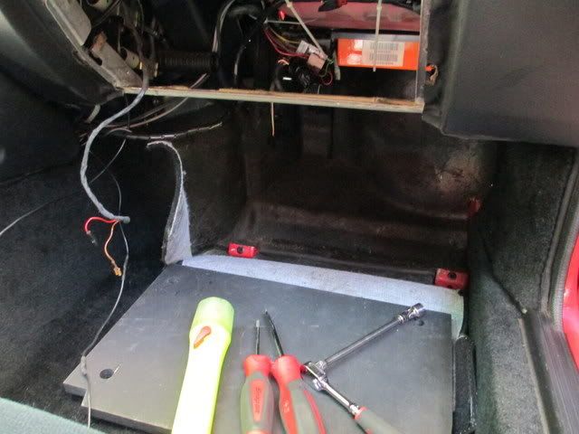

Finally pulled out the engine harness today which was strangely theraputic. It was always a major PITA trying to get all the wiring coiled nicely with the DME/KLR brackets. But between the aged wiring with unraveling friction tape leaving a gooey mess, addition of the LR crank / fuel injector replacement harnesses, misc vacuum lines for the boost controller and gauge, extra wire harness for the SMT8 piggyback and a few other things it was a complete mess. No amount of wireloom and zip ties could keep it organized. I swear i could never get the DME / KLR bracket to fit the same way twice.
So starting out with a clean slate in the passenger foot well for the new engine harness is going to be really nice. All that needs to get put in are the PCM and just figuring out where to mount an auxiliary fuse block and OBD port.

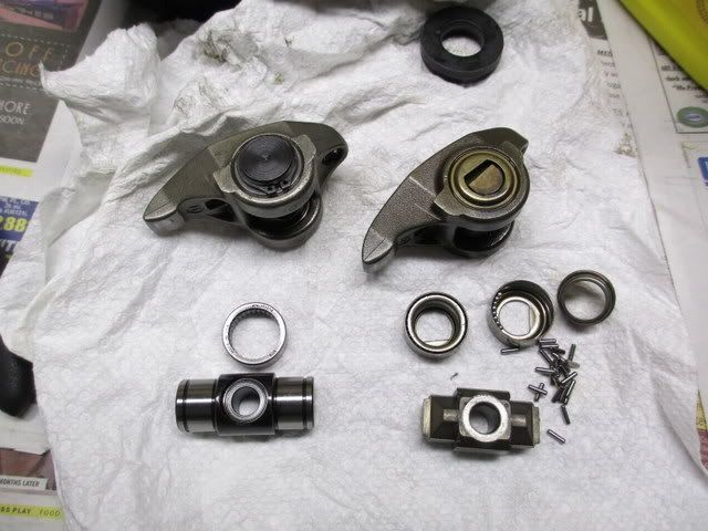

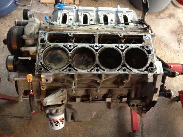

I started disassembling the LS1 a few weeks ago and was happy to see the bores are all perfect which was sort of a sigh of relief when buying a used engine. Overall, all of the internals were really clean.. no sludge buildup or heavy varnish starting so i was pretty satisfied with the engine.

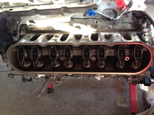

Here are some pictures of the rocker arm trunion retrofit. The stock rockers use a cageless needle bearing. Its possible for the bearings to fail, sending about 30 something needles floating into the oil system. So the retrofit kit uses a caged needle bearing and hardened trunion which are held in place using a snap ring. Really easy to replace also, the only special tool basically being a vice.
Completed one side of the engine in about an hour and a half..
