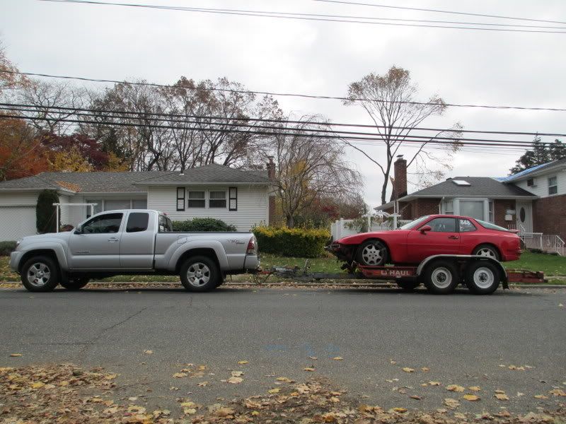

Forgot about this thread..
After like 8 months i finally finished the engine,
http://img.photobucket.com/albums/v1...p/IMG_0276.jpg
Decided to have a local shop complete the engine swap for me. They do top quality work and i think they are going to do an awesome job. This year was just normal busy and it took me most of the year to finish the engine. At this rate i would never finish this car. Next year ill be flying between NY and South Korea for most of the year so its going to be even busier. Dropped the car and everything off last week, hope to have it back and ready to go by spring :).
http://img.photobucket.com/albums/v1...p/IMG_0286.jpg
