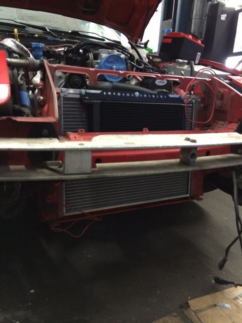

Here is some more progress over the past month. The radiator took a bit longer to arrive than expected so that held up a few things. But the wait was worth it i think. Shop said it fit well and it made the hose routing much easier.
Just a few more things left to finish, hopefully it will be ready to start before i leave again in a few weeks :).
To be finished..

callmethewander 11-17-2013 08:47 PM
Excellent work Jon, that engine looks like it grew there. Beautiful

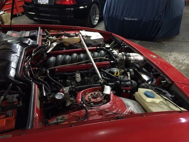

Techno Duck 12-26-2013 01:57 PM
Porsche 944 Turbo LS1 Swap - YouTube
Its freaken loud! 4" all the way back from the long tubes with a Magnaflow muffler. I may have to get something more quiet.. but for now i can live with it!
The only thing left to finish is the intake. Getting everything under the nose panel (in particular the MAF) has been a pain due to the clearance between the radiator and hood. Just waiting on a filter which should be here monday (i love Amazon Prime!).
http://img.photobucket.com/albums/v1...psf686f3b5.jpg
The rear section was off so a v-band could be installed to make removal easier. Everything fits amazingly well.
http://img.photobucket.com/albums/v1...ps4ba6f835.jpg
Hope to be able to bring the car over to the other shop for the alignment next week. A big hopeful is to have the car home by the 2nd week of January. Then i can start playing around with it :)
I sat in the car for the first time in a while today also. Felt a bit alien considering ive been driving my pickup and a E36. Pedal feel on the brakes was good, though the clutch will need some adjustment made. The pedal was surprisingly pretty light which i wasnt expecting. It was a bit spongy and the travel on the pedal was a little short. Needs to be bled again and hopefully can adjust the linkage / push rods enough to get the travel to my liking.

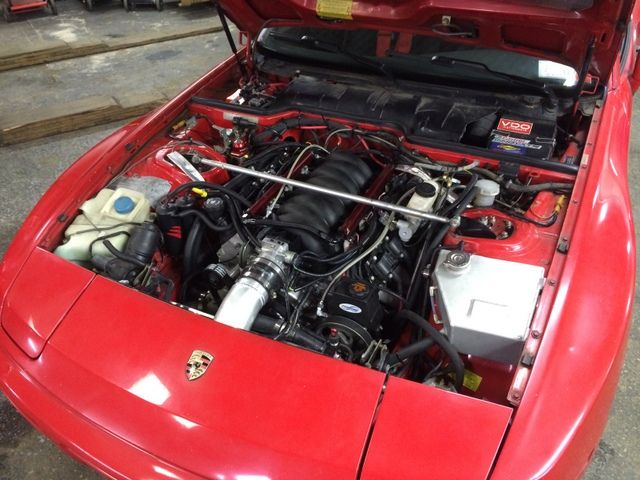

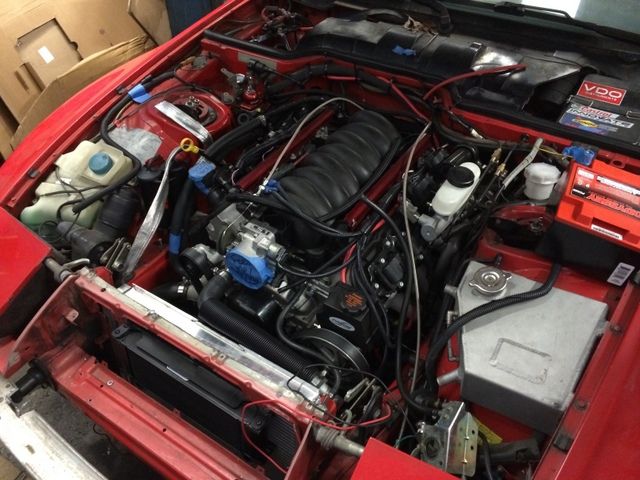

Techno Duck 01-23-2014 12:50 PM
Everything is done! Just cleaning up the engine harness wiring under the dash and doing some long overdue rust cleanup on the battery tray.

Techno Duck 01-30-2014 06:45 PM
Put about 9 miles on her earlier and filled up with gas for the first time in 2 years.
Looking forward to the weekend :).
