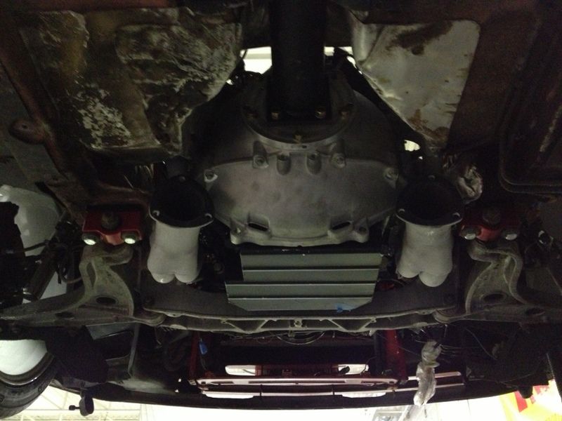

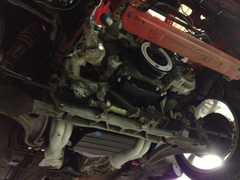

I think to date the biggest challenge was getting the hydroboost installed. I spent a few hours upside down working under the dash test fitting everything and making sure the angle of the push rod was complete. The shop did the final install of the hydrboost unit, and they said it was not a pleasant experience.. the biggest challenge being torquing the huge lock nut on the backside.
Here are some pictures from over the last few months showing some different stages of the engine swap.
http://img.photobucket.com/albums/v1...psdb235f8f.jpg
Final test fit of the hydroboost setup..
http://img.photobucket.com/albums/v1...psbd1f1b74.jpg

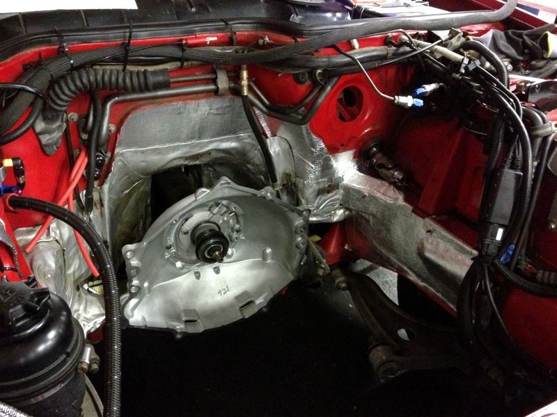

C5 Corvette bellhousing with the torque tube adapter fits like its supposed to be there!
http://img.photobucket.com/albums/v1...psd7d07fa9.jpg

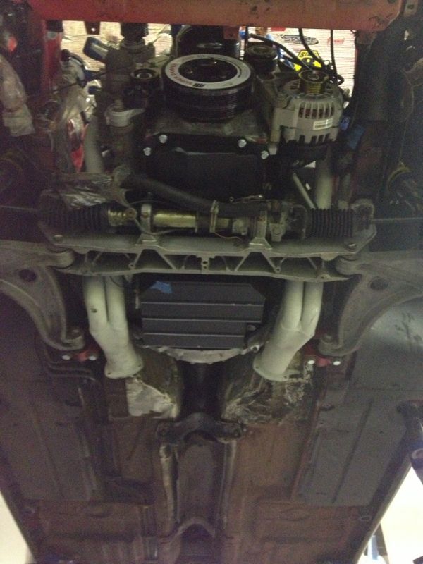

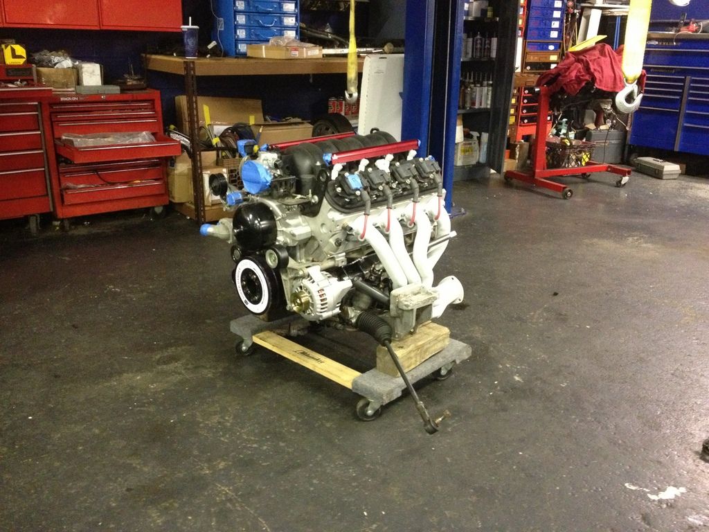

Engine installed
http://img.photobucket.com/albums/v1...ps335f9f0b.jpg
http://img.photobucket.com/albums/v1...ps1c70dba4.jpg
http://img.photobucket.com/albums/v1...ps440017b4.jpg

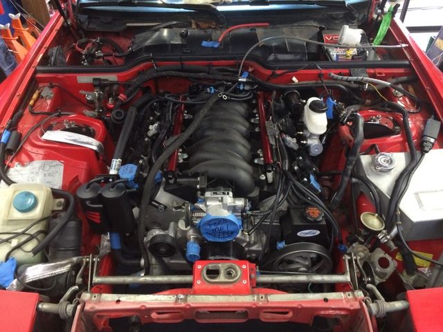

And this is currently how things look as of this morning...
http://img.photobucket.com/albums/v1...psb2c4ba8f.jpg
Hoping to have the car running in a few weeks, we are mostly waiting on hose, fittings and the radiator to come in right now.
The big stuff that still needs to be finished;
-Install Renegade Hybrids radiator
-Complete engine wiring
-Plumbing for oil lines, power steering
-Connect brake hard lines to the master cylinder
-Fabricate center section of the exhaust, already have a 4" catback
-Fabricate intake, we are planning on using a C6 Vette style intake that will run under the nose panel

Techno Duck, have you plummed the carbon canister? If not, there is a good write up on 944hybrids. I can't tell from the picture, did you need to relocate the coil packs next to the hydroboost?
