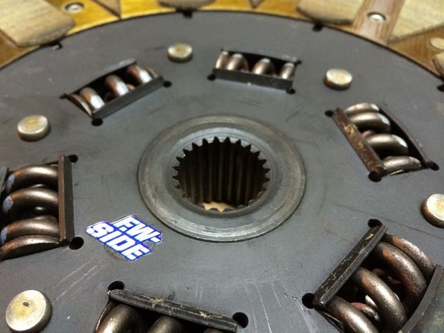

Still having issues with the shifting also. I have narrowed it down to the torque tube spinning continuously even with the clutch pedal depressed. I have ruled out not enough throwout bearing travel as being the issue, have ran with and without the throwout bearing shim provided by Spec. Despite all of the travel, the clutch disc is dragging on the pressure plate.
Going to tear it down again for inspection, ive got a few ideas as to the cause...
-Possible bent clutch disc; could have been caused while installing the engine, shipping damage or just manufacture defect
-Inspect splines on torque tube; could be hanging up on the splines, i dont think this is it because the disc and be wiggled back and fourth with clutch depressed pretty easily.
-Inspect pilot bearing and adapter; Possible the bearing or adapter is in contact with the clutch disc, i also feel this is unlikely because all of this was double checked before.

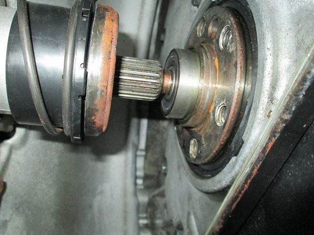

Monthly update;
We finally figured out what was causing the shifting issues a few days ago. After tearing down the clutch assembly, we found the pilot bearing and adapter had started walking out of the crank. This was causing the adapter / pilot bearing to press up against the clutch disc hub, which in turn was causing it to drag on the pressure plate.
Loctite bearing retaining compound was used on the adapter so it should stay put this time around.
Below you can see where the pilot bearing / adapter was rubbing on the hub. We replaced the disc with a new stage 2 from Spec for good measure.
We also checked the engagement of the torque tube into the pilot bearing for good measure. Here it is mocked up with no pressure plate, flywheel or clutch disc.
Ive put just over 100 miles on it so far and it now shifts without any issues finally. Being able to drive it now without the shifting problems i can say it is a true pleasure to drive. Despite all the issues that popped up during the build i can say it was really worth all the work and money spent.

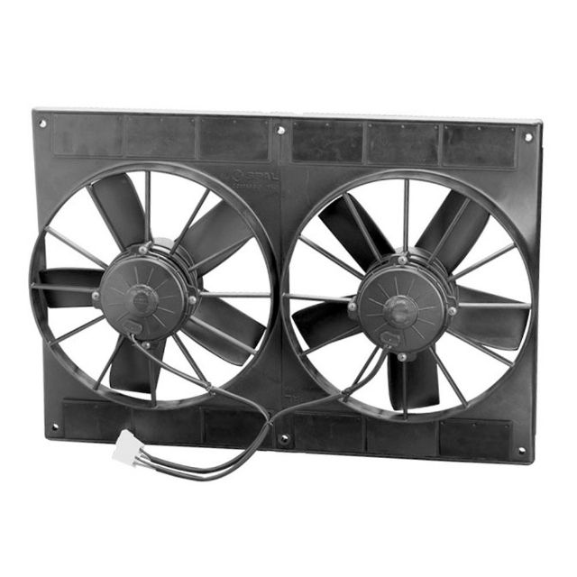

The cooling issues have been solved by putting a stronger 16" fan in with straight, rather than curved blades. The straight blade fans are louder, but are able to pull more air through a thick radiator core like what i have on the car now.

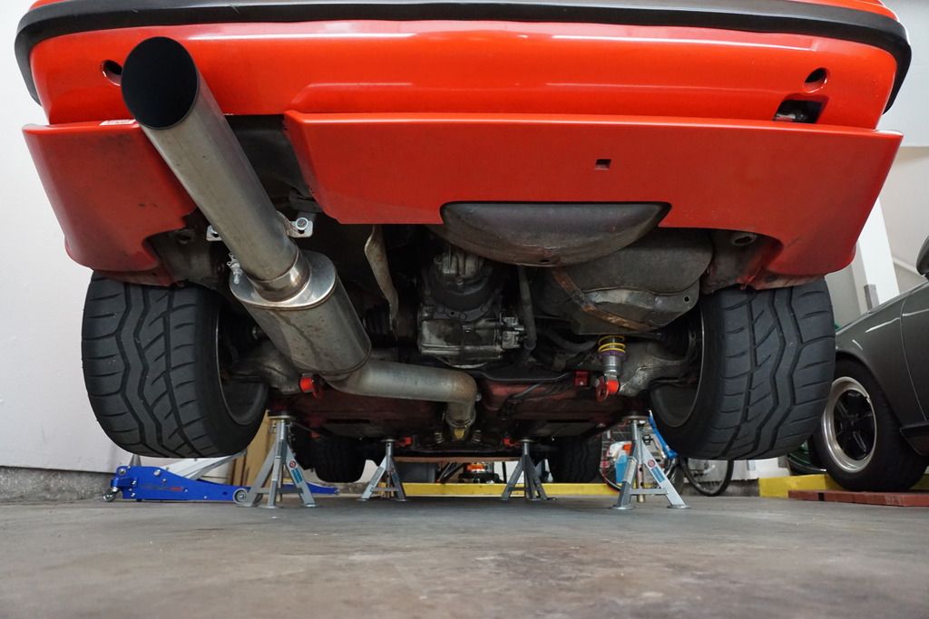

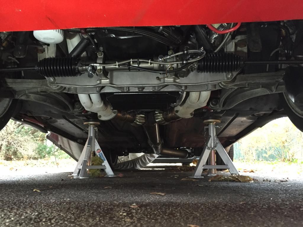

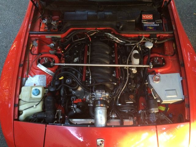

Unfortunately i haven't been able to drive the car much after reloacting to SoCal. The car is currently in NY; in storage at a friends shop. I was back in NY a few weeks ago and was able to put about 500 miles on the car. Currently at just over 3k miles since the swap.
Many bugs had to be worked out in that time but its running great. I did a 2-day auto-x also and had a ton of fun with the car. The 944 chassis is really well suited to the power band of the LS. Its still surprising also how quickly the car changes directions with the big lump of a V8 upfront. I know the weight different is marginal between the two but still surprises me! This was the first test of the new steering rack setup and it held up great. Right now the car really doesnt need much more attention which is a relief, i think all the bugs have been worked out by now.
Ive been kicking around the possibility of selling the car. Registering the car in CA will be extremely difficult as i never thought i would have to pass a smog check when it was being built. So that means it will likely turn into a trailer queen to and from the track. I bought a 911 3.2 earlier this year also so restomodding that has become my new focus. Still unsure what to do but i am looking into storing it for a couple of years until i decide to go tow vehicle + trailer.
Here are some recent pictures

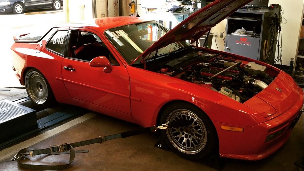

The car now resides in SoCal, had it retuned for 91oct this morning. Took out 2 degrees of timing up top to increase the safety margin, result was a drop in 20bhp. Still puts down 363whp / 349ft-lbs which is more than enough
I don't drive the car much on the street anymore but when i do its always fun...for about two hours max then the loud exhaust, heavy clutch and terrible drone at 2500rpm gets to me. Getting the car ready to hit some tracks on the west coast next year, retuning for 91oct pump gas was high on the list. Pretty much the last thing to do is quiet the car down a bit and install a 2nd muffler so it will pass sound at Laguna Seca. Just over 3.5k miles on the swap with a few track and auto-x days on it. So far so good. One thing to address is the shifting which has very high effort right now. Not sure if its linkage related or possibly the fluid (perhaps to slippery for the synchros). Not sure what the shop used when they put my transmission in.
