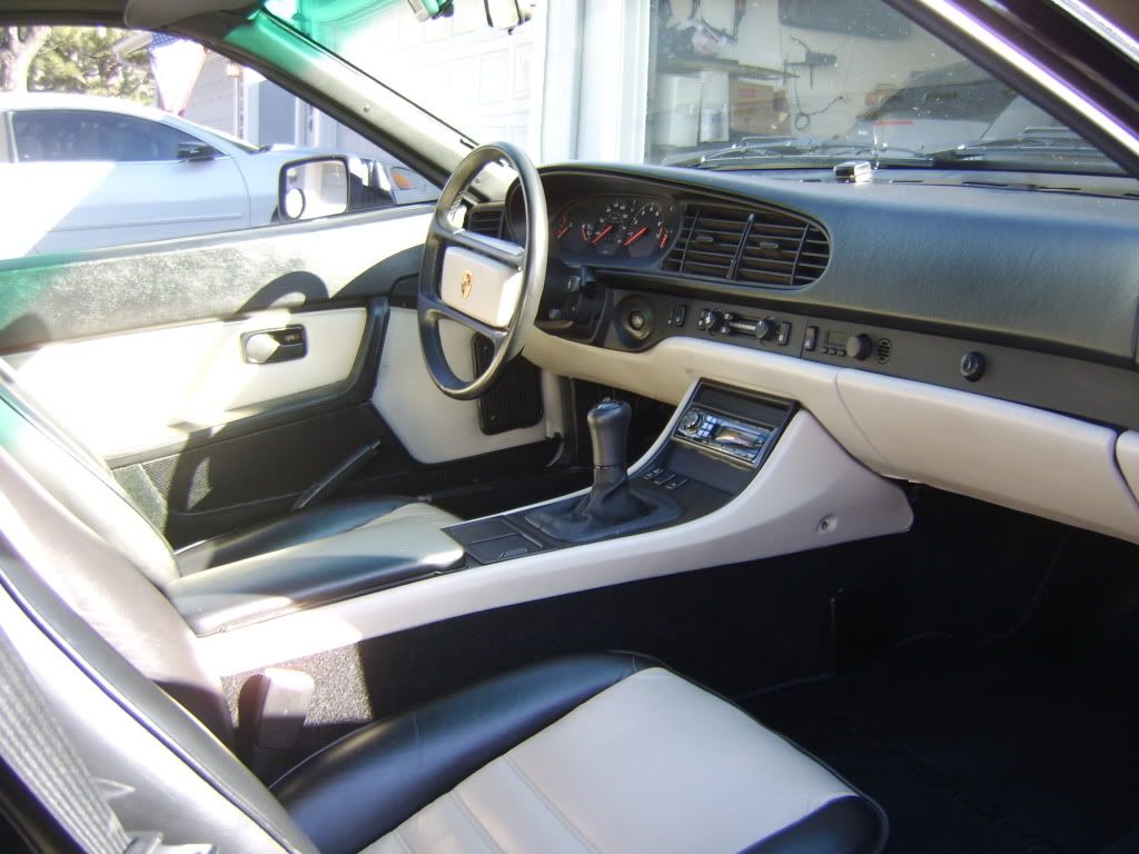

I found a cracked dash cheap a few years ago. I had it recovered professionally. I spent a long day swapping dashes. It still looks perfect. The cost was only about $250.00
Before
During
After

Thanks all for the input so far. Stogie25....that's a nice looking dash and I like the rest of the interior. Different and tasteful...I like it. Why does the picture of the dash pulled out make me want to just throw a rug over mine? I think I'd rather get under and put in a new clutch.
