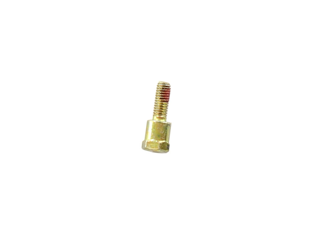

86 944 speed cross reference sensor bolt?
Changing out my reference sensor and I lost the bolt that holds it in. I know the head is a 10mm but what size bolt is it? Can I get a match at a local hardware store?

Posts: 3,003
It's special
Old 10-06-2013, 09:17 AM
Join Date: Apr 2010
Posts: 3,003
99921702602

Hopefully it didn't fall down the hole in the bell housing?

And those sensors are, IIRC, mounted right through/into the bell housing, where dropping the bolt through the hole would basically put it right into the clutch/flywheel area. Can you look through the clutch inspection hole and/or probe around with a magnet in there and find it?

IF it fell in the TDC hole, pull the starter and hope it drops to the bottom of the bell housing.
