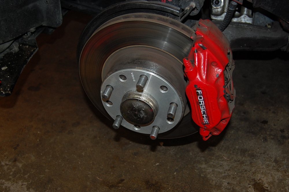

UPDATED resolution - HELP problem installing 17 in boxster wheels on 951
I tried to install the wheels on my 89 951 and as the rears fit perfect the fronts would not fit because the bearing cap will not allow the wheel to sit flush with the hub. Even with the bearing cap off they still will not fit flush. I see pictures of 944s with these wheels, so is a spacer needed?
The fronts are 7x17 ET55 (Part Number 986.362.124.00)
The rears are 8.5x17 ET50 (Part Number 986.362.126.05)
The gap is approximately 11.5 mm when all the lug nuts are tightened.
If a spacer is required, what is the maximum spacer I can use that will be safe to secure the wheel to the hub?

I myself was thinking about boxster wheels but did not know about such issue. One solution might be bore bigger diameter opening for the for the hub. But you will not be able to use those wheels on boxster without hub-centring rings (if at all) and you should look out that you do not make it to big as otherwise it will be hard to center the wheels and it will vibrate at higher speeds. If you use spacer, you should look that you get at least around 7 full turns for the bolts. If less, you should get longer ones. It seems that you need 12 mm spacer to make them fit. 15 - 20 mm spacer should be still fine, but not sure if the length of the bolts will be sufficient.
Old 07-21-2014, 09:55 PM
flash968's Avatar
Join Date: Jun 2006
Location: O.C. CA
Posts: 4,587
yup - you either have to use a spacer (dangerous if too large) or counterbore the backside of the wheel for clearance.
keep in mind that you can only use a maximum of a 7mm spacer without either lengthening studs or using a spacer with its own additional stud set. the rule is that you must have a minimum of the same amount of threads of engagement as the diameter of the stud. it is not a "number of turns". 14mm diameter stud means 14mm of engagement. this is with steel lug nuts. with aluminum it is 1.5 times the diameter, which means that spacers would not be safe at all without longer studs.

Did you try the rear on the front? If it clears, another option might be to purchase a pair of rears and run a "square" setup instead of a staggered setup.

For my track wheels, I use a 5mm spacer, works perfect.
Got the spacers on ebay for cheap, only need them in the front, lug nuts still have plenty of thread engagement.

yup - while i hate spacers, and most sanctioning bodies do not allow them, as long as you are using steel lug nuts, 5mm is fine.
however, if you are using aluminum lug nuts, no spacer is safe. the engineering rule for aluminum is 1.5 times the diameter in thread engagement. that means 21mm of threads needed. the studs are 31mm long. the wheel thickness at the bottom of the taper is 10mm. that leaves exactly what is needed for torque retention. i don't think that was an accident. porsche is pretty good about that kind of thing.

thanks for all the feedback. I am going to make some 1/4 inch spacers to test (machine shop). I will feedback the results. I will also test rears on the front.

If it's just a matter of the wheel not sitting snuggly on the stub axle it would only be by .5mm or thereabouts. What about getting the inside of the wheel milled to fit?

that's what i suggested first off. a simple counterbore would do it. i've seen it done for this very reason, with success

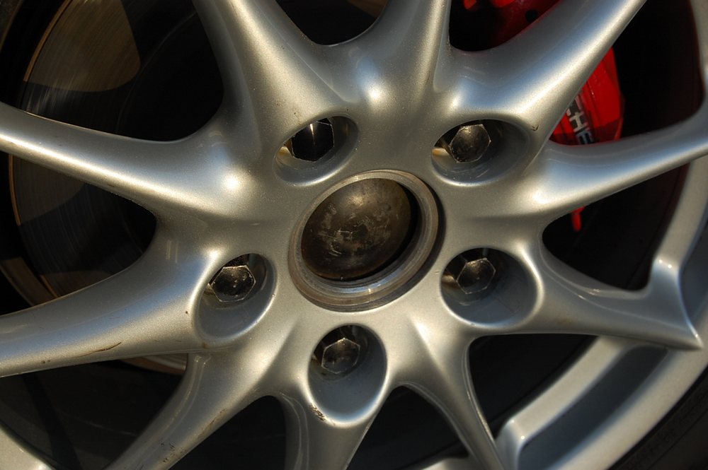

UPDATE - I hate to admit it, but i made a mistake. if you look in the pictures i originally posted, something is missing... you guessed it - the rotor. After initially trying to install on the 89 951 and seeing it wouldn't fit, i pulled a spare 951 hub off of my shelf and used that to get the measurement. Although i still need a spacer, the spacer requirement may only be 3/16 inch. I used your suggestion and installed a 1/4 inch spacer and the wheel installed with no problems. I am going to try some 3/16 inch aluminum and 10 gauge stainless (0.1406) to see how thin i can go. Thank you everyone for your feedback and help.

I was using a steel lugnut, but I decided to use the C2 Turbo wheels without spacer and use stock lugnuts
