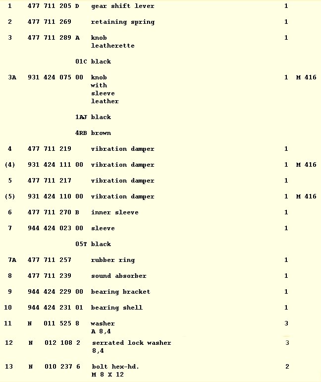

Here's a parts diagram:

Old 10-09-2002, 09:23 PM
Crippler's Avatar
Join Date: Dec 2001
Posts: 408
GREAT! Thanks alot So Cal. I think I should be able to solve my problem tomarrow with the aid of that diagram.

Old 10-09-2002, 09:31 PM
SoCal Driver's Avatar
Join Date: Feb 2002
Location: Costa Mesa
Posts: 8,587
Here's the corresponding parts numbers:

Old 10-09-2002, 09:54 PM
Crippler's Avatar
Join Date: Dec 2001
Posts: 408
Well looks like my major problem turned out to be quite small. THe lock ring (part no.22) had just poped off, it was a challange to get it back on , but no big deal.
Anyways thanks for all the advice So Cal. Good to know there is someone around to think cleary fro me when I freak out about whats wrong with my car.lol
