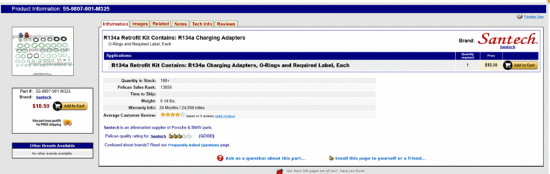

Read:
A/C R134a Retrofitting
You probably will still need to remove the AC unit from under the dash to change the "O" rings.
Use ester oil-it mixes better with old AC compressor oil.

Here is the kit you need or similar:
J_AZ
