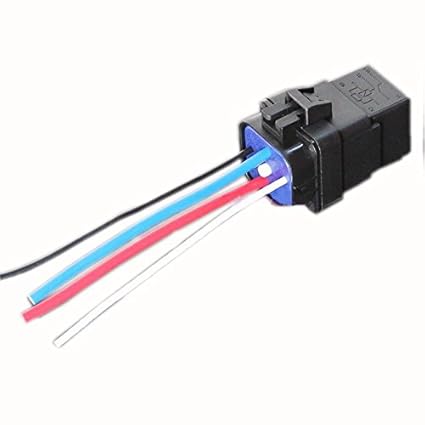

Was it the relay contacts that were corroded? Or the relay itself internally? I used another vendor's headlight harness that comes with sealed waterproof relay & sockets. Such as this one: Amazon - ZFE waterproof relay & socket.
Wouldn't be too difficult to integrate that into your existing headlight harness.
