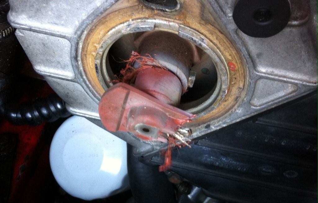

Pop the distributor cap off and look at the rotor and cap condition. I spent a week chasing what I thought was a fuel issue when I had similar symptoms, and it turned out my rotor was wasted. I was amazed at how well it ran like that

Originally Posted by ChipG View Post
Holy Hannah! How does that happen!?!?!

Wow...it's unbelievable that the car still ran with the rotor chewed up like that! In my case, the rotor is new, I just replaced the water pump and had the whole thing apart ( distributor) so pretty sure it's a fuel problem.

No remarks about an Alabama Porsche?
Hmmmm
» 1987 924S Turbo - Got Boost? «
"DETERMINATION. Sometimes cars test us to make sure we're worthy. Fix it." - alfadoc
Old 11-09-2015, 05:06 PM
Join Date: Oct 2015
Location: Fairhope, AL
Posts: 13
Hmmmm
Old 11-09-2015, 08:26 PM
Toofah King Bad
Rasta Monsta's Avatar
Join Date: Oct 2006
Location: PacNW
Posts: 4,127
Oh, c'mon, look at that rotor!
Sent from my Nexus 6P using Tapatalk
Old 11-10-2015, 04:15 PM
Join Date: Oct 2015
Posts: 13
If you're gonna f*** something up, go all out
