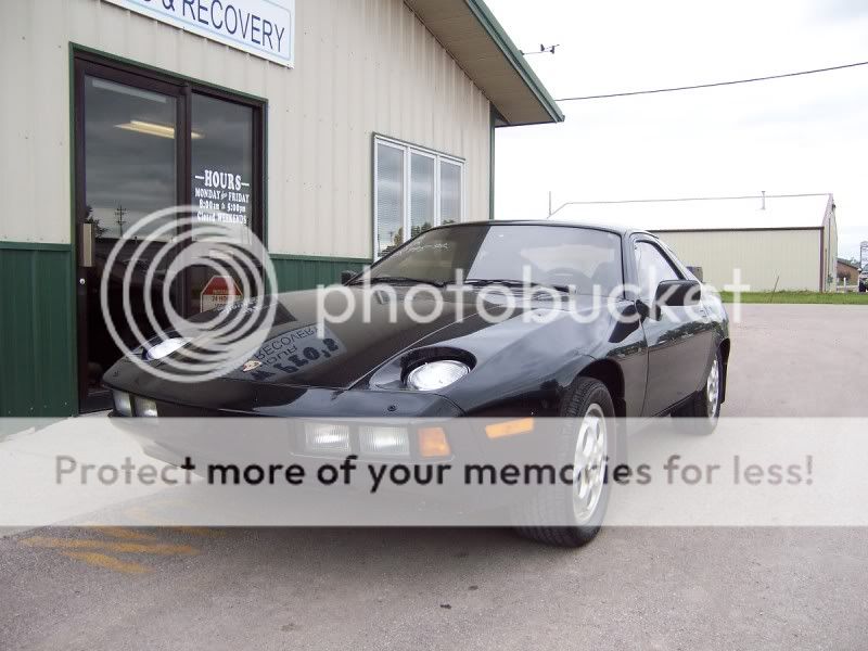

A 78 928 is for sale locally and I'm a touch interested. 61K, manual, black/black leather, new timing belt, new injectors, new plugs and a new battery. Can someone point me to the areas that I should pay attention to before I go to look at the car. Asking price is $7.5K, which I know is a little high for a 78 but in the photos it does look in good condition, clean and straight. It's been for sale for a while so I'm sure that they will deal. Thanks in advance for the help.
here are some photos:
Thanks Gavin

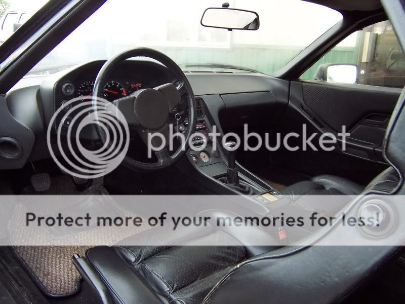

Wow, looks like a time capsule to me. Look at that dashboard!
Hopefully that pic was taken when it was still warming up. It's tach is almost at 2K.

I have a 78 with very low miles (approx 52K), all documented. I think these early examples, if in good shape with documented service history, are going to climb in value. The price for the car above does not look out of line to me if it is in good shape and has service records, and the mileage checks out. The seats look like more than 55k are on them however (especially the passenger side, which is unusual; the driver is not so bad). Try to get and post pics of the engine bay.
Ed
