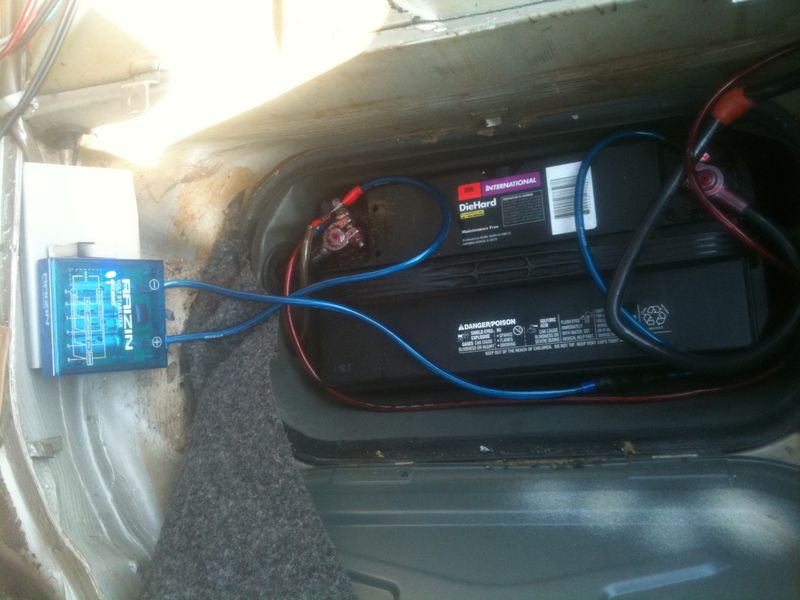

Originally Posted by John Speake View Post
Hi Blaize..... just found your thread on here..... does the voltmeter still vary when you hit the throttle ?
I installed this voltage stabilizer on my 82, it worked great. No more bouncy voltmeter.

Old 10-16-2013, 05:56 PM
Maleficio's Avatar
Join Date: Mar 2010
Posts: 1,217
It came with extra wiring to install grounds around the engine. That really helped out the roughness.

Old 10-16-2013, 06:00 PM
Network Native
Danglerb's Avatar
Posts: 10,349
LOL, can't be serious.
Old 10-17-2013, 03:27 PM
Maleficio's Avatar
Join Date: Mar 2010
Posts: 1,217
Yep, I bought it, installed it, installed the extra ground wires around the engine, and it worked as advertised. It's just a rechargeable battery pack. It calmed my voltage needle down, and that was what I wanted.
