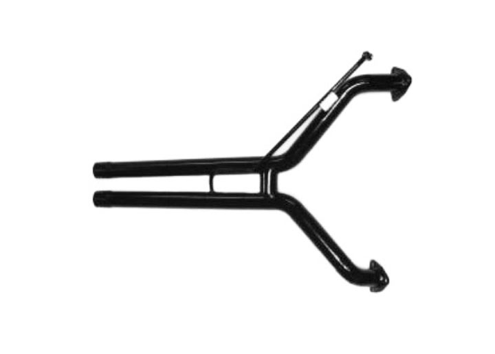

For M12 engine, 4.7 litre 16V, I need from the headers back - no CATS, No air pipe, no OX sensor.
OTT has the exact needed design, but only for 32V systems, seen here-
I can't find similar for 16V engine. I have found an H-Pipe, but I don't want to use an H
Any help would be appreciated.

I didn't want to change the stock headers if I could help it. A week of looking for this, looks like I'll have to have someone fabricate or I'll have to fabricate myself, which I do not know how to do

Roger I think sells the Dave Lomas X, but I don't know fitment details relative to the 16v. The common setup is to use a set of US 85/86 exhaust manifold on an early motor and that requires a small adapter on one side.
Its some serious money, but I am thinking I will go with a full Greg Brown exhaust, makes more power and torque than anybody else and has a H at the front and X at the rear.

I was under the impression that you used an "X" or an "H", one or the other? X being more for scavanging efficiency, H more for simple equalization of pipe pressure due to firing order?

You want a Y pipe, not the X. Last I heard Roger does sell them.

Try Summit Racing.com You can buy a close coupled X pipe, and a muffler shop can connect your existing pipes to it. Parts and labor should be much under $150.

I was unable to find anyone that had a complete downpipe to tailpipe solution with an x-pipe for a 16V.
I did find this with an H, fully stainless, with rear resonator, for $1400 new

MagnaFlow 10790 - MagnaFlow Tru-X Stainless Steel Crossover Pipes
Crossover Pipe, X-Pipe, Stainless Steel, Natural, 2.25 in. Diameter, Universal, Each
Part Number: MPE-10790 for 2.25"
Part Number: MPE-10791 for 2.5"
