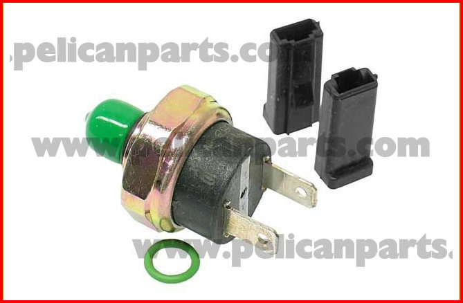

Low Pressure Dryer Switch ( Near or next to the Dryer front of Radiator Area
Link to this Info :
THE 928 HVAC SYSTEM
starting with the 1980 year type , and yes there were two versions , version one= Non Climate Control( can be recognized by NO temp sensor vent in center console(upper section) . Version two= Climate control (has the temp sensor )one inside as mentioned and one positioned outside in the left front guard area. Also for the 1980 to 1989 is the large and highly respected N/D A/C compressor , and from 1980 to 1986 a much larger A/C condenser electric fan , the non climate control version was deleted around the time the 4.5 928 was discontinued .
As is often the case with a 928, the most common problem with the electric cooling fan seems to be bad connections on the fuse or a bad relay. The fan motor, coolant temperature switch, refrigerant temperature switch, and wire harness can all fail, but these failures are much less common than fuse and relay problems.
Another problem with the electric cooling fan is that the refrigerant temperature switch seems to be ineffective. It would be better if the electric fan ran any time that the A/C compressor was operating. One way to accomplish this would be to install a heavy-duty in-line relay, triggered by the A/C compressor signal, to operate both the compressor clutch and the cooling fan. A diode should be used at the fan, to prevent triggering the compressor when the temperature switches operate the fan.
The electric cooling fan may not run as often as you expect. On cars up thru ‘86, the fan does not automatically run when you turn the A/C on. It only runs when the coolant is very hot or when the Refrigerant temperature switch is triggered.
To check the electric cooling fan, turn the ignition switch on, pull the connector from the refrigerant temperature switch (located on the stem sticking up from the receiver/dryer between the radiator and the bumper), and jumper between the contacts in the wire harness. The fan should run.
If the fan does not run, replace the connector, and pull the cooling fan relay (not the blower relay). Jumper between terminal 30 and 87 in the relay socket - the fan should run. If not, check for 12 vdc at the fan motor connector. If there is 12 vdc at the fan connector and the ground is good, but the motor does not run, the fan motor is probably bad.

So First Step at this Point well be to test for Current at the Low Pressure Dryer Switch
Also to Test for Connectivity to see it that's indeed the correct wire coming from Q3 to the This Dryer Switch .
At This Point if I Have Current at this Switch when the AC Button is engaged I should be able
to Power the Compressor from this switch
Since I Can't find the Wire to Hook to the Compressor coming from the Switch Yet I May have to Run a wire from the same ( Low Pressure Dryer ) Switch.
However now that I Know of this switch Perhaps I can trace down the wire Finally . My Guess is that it is Broken off just inside of some Wire Loom very Near the Hot Post of the 14 Pin Connector > Pass side Front next to Cam Cover on Fender well

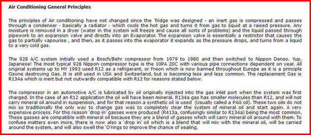

Another BIG Issue is the Type of Oil in the Compressor .
Since the Car sat for some 15 Years certainly the " Type " of Oil in the Compressor most likely is not compatible with the Current types of Refrigerant .
IE: the Mineral Oil well not work and upon running the Compressor with the Old Non compatible Oil the Compressor well be Toast in short order .
Toast anyone ?

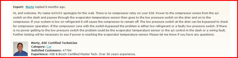

Yes you are now on the right track. Lets stop calling an AC Compressor a Cooling Motor - someone is not helping here - I think they were answering a quite different question on the cooling fan? (nothing on your 928 is called a 'cooling motor' you have a Compressor & a Cooling fan which are of course very different things).
Power to your AC head unit also supplies the AC Compressor Clutch - This power is supplied via Fuse #9. Power enters the AC head unit on its pins 4R & 5R.
A switch in the head unit slider connects power to the evaporator freeze switch (located in the bulkhead area under the cowl - on the Air plenum). The slider switch output exits the AC Head unit on its pin 9L as a Violet/Yellow wire and travels through a single pin connector to the Freeze switch. (need 12V+ on both switch pins for AC active).
From the Freeze switch it is connected (another Violet/Yellow wire) to the Central Electric (fuse/relay) panel on pin J2 (on bottom connectors) from there is just connects to pin Q2 (no other internal connections) and exits as a Black wire (in a loom) to the low pressure switch mounted near the AC dryer. This loom goes through the firewall grommet and runs under the (LHD) passenger fender lip to the front.
From the low pressure switch (open when refrigerant pressure is too low) a black wire goes back to the 14 pin connector (also via the loom) on Pin 9 and carries on as black wire (now in the engine loom) to a single pin connector where it splits to two black wires; one to the Compressor Clutch and one to the Supplementary Air valve (for AC active idle compensation). The final leg to the compressor should have another single pin connector where it switches to a red wire (the final leg to the Supplementary air valve stays a black wire). These two single pin connectors should be near the loom & near the AC compressor...they may have been ripped off... if so you can run a new line direct from the 14 pin connector to the AC compressor clutch(its quite close) - however you must also find & connect up the supplementary air valve or you may stall at idle with the AC on - you can find that later of course...
Central Electric Pin Q3 on your car is not related to the AC clutch - only the Cooling fan. You do need this to operate correctly for AC (and engine cooling), but its quite independent. If your cooling fan works normally in driving - then don't worry about it for now - until you get the AC compressor working.

About the Compressor Oil after Wiring the Compressor to Run

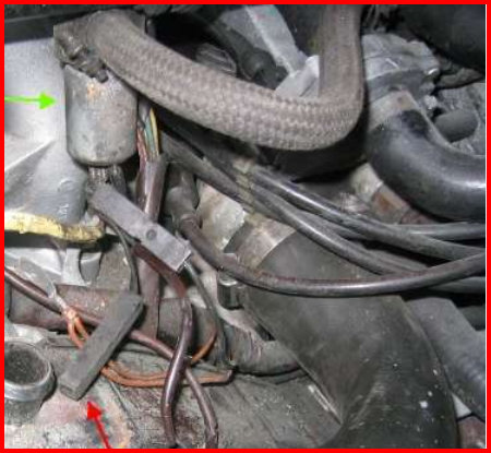

PHOTO OF supplementary air valve ( From the net not my Car )
Today I Used Your Help and Jumped the Low Pressure Dryer Switch after checking that it
(1) Indeed Had Power with the Key on and the AC Switch Engaged
(2) Switch was Closed and i jumped it
(3) This Allowed me to Check for Power at the supplementary air valve
3A was no Power until I Jumped the Low pressure Dryer Switch
(4) Upon Realizing that the Power for the AC Compressor Must Come from this same switch since I had no wire going to the AC Compressor I Soldered in a new Lead
with 2 Wires . 1 to the Compressor and 1 to the supplementary air valve
At the AC Compressor was 3 wires 2 going in to it and 1 coming out RED in color that changed to Black after going through a Factory wiring Junction ** However this wire ended after about 5 Inches Cut or Broken off .
TESTING :
Simple Start the Car and Engage the AC Button
RESULT : AC Compressor now spins and stops when AC Button is disengaged
So The Basic Function is working now
Of Course I expect the Refrigerant is low after 15 years of non use humm
I Hope I can find some Compatible Refrigerant with the Oil in the Compressor so I don;t mess that up.

Thanks I doubt I can get R12 ?
ABOUT THE DRYER
Just what Exactly goes wrong with the Dryer anyway ? I can find no info on the net so far on that > Just says replace it < But not why ? or what goes wrong with it
Does it get Plugged up with something ?
I understand you can get a aftermarket one for much less other then the original one . Also that they work just fine .
Here are some comments from Pelican :
Comments: I am having question about the a/c of porsche cayenne.when do we need to replaced the dryer cartridge and what is the symptom or reason to replaced it.
March 15, 2012
Followup from the Pelican Staff: If there is a leak in the system or a restriction, you would replace it. - Nick at Pelican Parts
Comments: I have a 1985 911 cabriolet. I took the belt off the compressor 10+ years ago because the a/c never cooled very well and i got tired of replacing Freon. Will there be a problem if I put a belt on and recharge the system at this late date?
August 8, 2011
Followup from the Pelican Staff: Maybe. i would check if the compressor spins freely. Sometimes compressors will seize when not used. At the minimum, check it for leaks and replace the receiver/dryer. - Nick at Pelican Parts
Comments: I have an 87 944S, and would like to get some A/C going for the hot summer, but the system only takes R12 and that is not available in stores... rumors have it that some places may sell it but will charge an arm and a leg due to the environmental controls. Anyhow, I have seen the R134a conversion kit which adds some sort of valve. Is this something I could use and do myself? You mentioned earlier that 'extensive' changes are required, but I wonder if I can get more detail. Also, I don't know how long it has been not working, so could other things be wrong with it clutch?. The fan blower works, heat works great. Thanks!
June 17, 2011
Followup from the Pelican Staff: I would have the system leak checked. Repair the leaks. Then replace the receiver/dryer and retrofit to R134. You should be OK. - Nick at Pelican Parts
