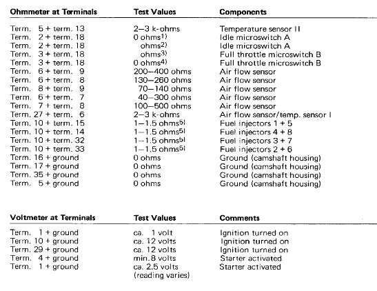

Ok guys the car runs like crap with the plug off and I'm getting a ohm reading on pin 27 and 6 but nothing from pin 7 which is airflow sensor output.
Does anyone know what reading I should getting from the plug when it's running.
And nothing from 9 or 8
I checked the ecu for high resistance and I'm getting a high reading from all the injectors
My next step is to cut the plug and splice in another one

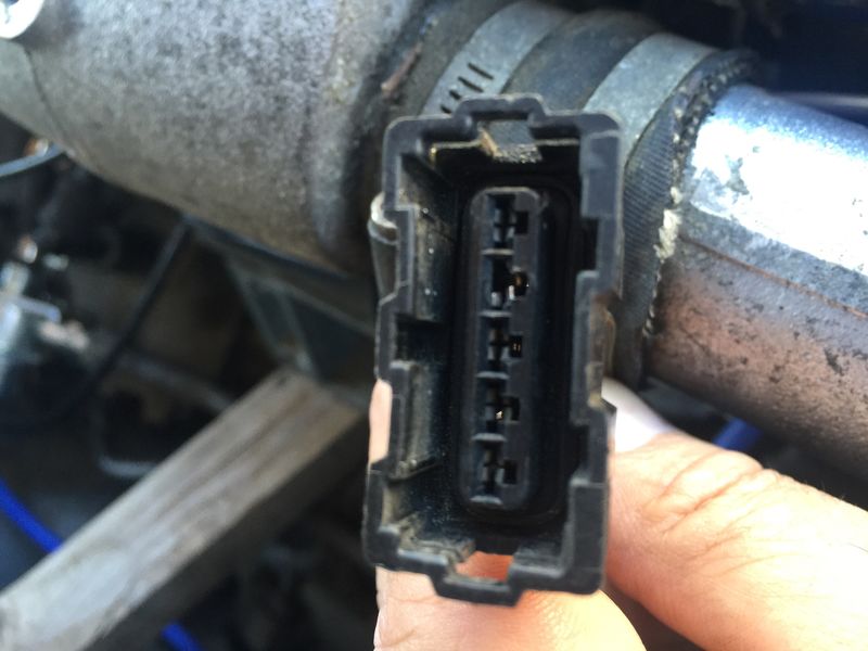

Hey John - Just to back up a bit and verify something once again - Are you saying that you've checked the compatibility of the Computer and the AFM Part Numbers ? Verified that the "Pin Out" connections are correct between the computer and the AFM ? Bench checked the AFM ? Verified that there are no injector wires shorted to ground (computer, AFM, injector plugs disconnected) - Wrung out the wiring harness for good continuity between each wire from the computer connector to the AFM connector (computer and AFM plugs disconnected)- tested for "NO Shorts" between any of the AFM wires - (computer and AFM plugs disconnected) AND there are "NO Shorts" to ground between any of the AFM wires and the vehicle chassis. Verified that only pins 5, 16, 17, 23, 35 of the computer connector are ground (computer and AFM plugs disconnected) ?
One other suggestion to keep from adding any additional problems - You may have noticed the bent or distorted connector plug pins of your AFM. If you stick the round test probes of your multi-meter in between the Bosch style female connector pins they can be distorted and/or severely damaged. This pin damage along with any frayed or brittle wires up in your harness can affect the reliability of the control signals between the computer and all it's needed input sensors. The electrical contact pin tension of the Bosch female connectors are designed to accept "Flat" male pins of a specific thickness.
When checking the reference and control signals at each L-Jet connector it's best to use a piece of safety wire that has been flattened on one end with a hammer. Then attach a short length of generic test lead with a pair of alligator clips to go from the flattened piece of safety wire in the connector plug to the round multi-meter probe. Often a missing input signal makes the older analog L-Jet fuel injection computers go really stupid. The newer Digital computers typically have a "Limp Home Mode" to fall back on if there's a component or signal failure.

The air flow sensor is a simple piece of hardware, it send the air temp and the flap position to the ecu, thats all. The flap position is pin 7 on the diagram, air flow is pin 27. You will only get valid test readings if both the ecu plug and the afm are plugged in. green/red trace ( 2nd wire from top in your pictures below) to ground with as voltmeter should change as you move the flap, (ign on so the ecu is powered) you will not see any variation on green, blue green, or the other wire.
The following is a comprehensive test of the ecu/afm, with ignition off, disconnect the ecu plug, and check :
This also eliminates the idle shut down and full throttle switches:

If anybody is looking for a "new" plug for the MAF, turns out at least as far as I can tell, that the 300zx has the same connector and they sell for $10 to $20 for options from pigtails to ready to crimp with new seals on ebay.
This is one I'm looking at, Fit Nissan 300zx MAF Mass Air Flow Sensor Connector Plug Clips z32 89-97 6 pin
